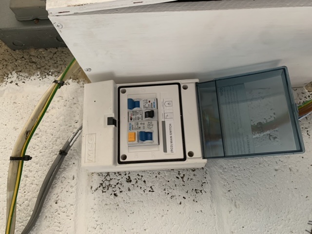

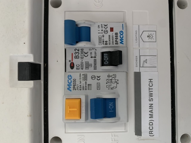

Sorry it took a while to reply, I waited for it to trip again before going out to the garage to make sure whatever I took a picture of was accurate! Pic of what the board looks like when the shower won’t turn on.

From what you have told us ,I suspect what is happening is when you switch off the ceiling pull cord switch ,that is when the MCB trips. When you next go to use the ceiling switch nothing works ,as the MCB is already off.
You could check the MCB , after switching off the ceiling switch ,each time shower is used. If it is tripping the MCB as described ,that points to a suspect ceiling switch ,possibly the MCB.
You will at some point need to engage an electrician to test and rectify.
Nice to see some cowboy crowbarring a “foreign” MCB into a different donor consumer unit.
always points towards someone with a make do attitude. the quality of the installation may prove to be the root cause of this problem.
