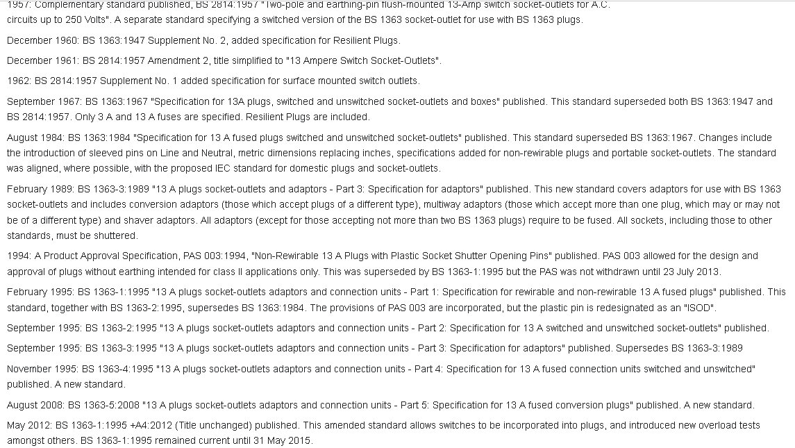

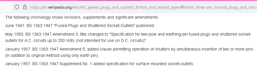

Yeah, I'm sorry, I meant to say the fore-runner of 1363. I have a feeling it didn't start life as 1363.
I don't think that the "rectangular pin" type of plugs (or any type of corresponding socket) existed until BS1363 appeared around 1947 - and, as I said before (without knowing it's date for sure) I haven't a clue what the 1947 version (or any others between then and 1995) said/required in relation to the dimensions of sockets.Yeah, I'm sorry, I meant to say the fore-runner of 1363. I have a feeling it didn't start life as 1363.
I found this, but the link 404s
A recent IET article : “The Remarkable Evolution Of BS 1363” can be download from: http://tinyurl.com/plugsize

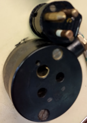

However I believe these 13A connectors came first:
I hope you're not going to say anything rude about them - I have at least a couple (probably more) still in service in my house
Kind Regards, John
Nothing in the .png attachmentThat has triggered bad TV memories.....
Don't know, I forgot to take glasses with me and struggled to read. Mrs Sunray read the bit that showed 13A for me but having no interest herself I think I was lucky to get that muchDorman 13 amp type?
IHNI why that's there.... I didn't knowingly attach anything.Nothing in the .png attachment
