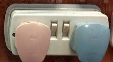

Small sized plug socket
Photo didn't appear, and can't be added by editing. Here it is (I hope!) ...
Kind Regards, John

The thing with these 'mini sockets' - for want of a better name - is (and this applies to the most recent incarnation) that a plug can be inserted 'upside down' by the earth pin, opening the shutters on the live and neutral holes.
Indeed, and that's why I always thought that (the current version of) BS1363 imposed a minimum distance from the earth pin receptacle from the edge of the plate/whatever. However, if I recall correctly (I'll check again) when I recently looked all I could find was a maximum, not minimum, figure for that distance - which makes little sense to me!
Kind Regards, John
My recollections were not quite right, although it seems to remain the case that the rule does not seem to make much sense. There is a minimum, but it relates to the L/N pins, not the earth one - so, no matter what the rule is meant to protect against, it doesn't seem to preclude the earth pin receptacle being very close to the edge, hence allowing the earth pin of an inverted plug to be inserted, opening the shutters of the exposed L/N receptacles.
The "modern" MK "Mini logic" sockets use the MK "2 pin" shutter mechanism, so while you can insert a plug upside down in the earth hole, doing so won't open the shutters on the live/neutral holes.

It definitely opens the shutters on the older ivory ones though.
Yes, and sometimes they were fitted without the chunky backplate. I think there was a very slim backplate available too. ... The backplate only really needed so the terminals at the back of the mini socket weren't directly exposed to the wooden skirting board. Not that anyone seemed to bothered then.
Yes, I seem to recall that there were slimmer backplates available. However, the ones I found in my house yesterday (all on skirting boards) all had the 'chunky' ones, as in the photo.
Kind Regards, John
I half remember the thin ones being just a flat plate, they added no extra space for cable entry, they just had a small lip so they located squarely to the socket.
Virtually every multiway socket strip has the earth hole too near the outside edge.
Is that just a 'common sense' statement (in which case I would not necessarily disagree)?
As for 'rules', as I've said, BS1363 seems not to specify any minimum distance of the 'earth hole' from the edge - only the L and N 'holes', which doesn't stop an inverted plug opening shutters if they are solely earth-pin-operated.
