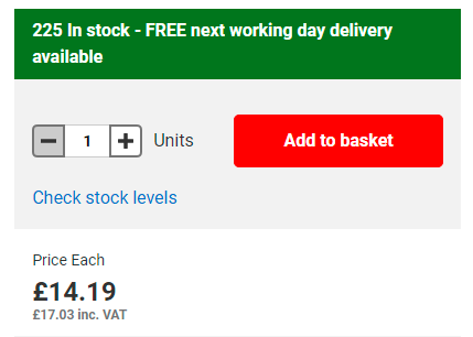

I stand corrected, they still appear in the MK catalogue. Several local wholesalers told me they were discontinued when I asked for some a few months ago.
I'm not convinced MK are properly updating their catalogues anymore, their website at least seems to have gone to **** since the honeywell takeover.
I found a site I'd never heard of before listing it, but given the number in stock is identical to RS, I suspect they are just a marketplace site pulling from RS.
Rexel list it on their website but no stock/price info without a login. https://www.rexel.co.uk/uki/root-ca...-Gang-Switched-Surface-13A-White/p/2500014910
Rexel price is £27.81+VAT each, and stock availability for delivery is 12+ days, so they don't have any.
... in which case perhaps they should by one from RS for 'free next day delivery', and still be able to make nearly 100% profit :-) ...
