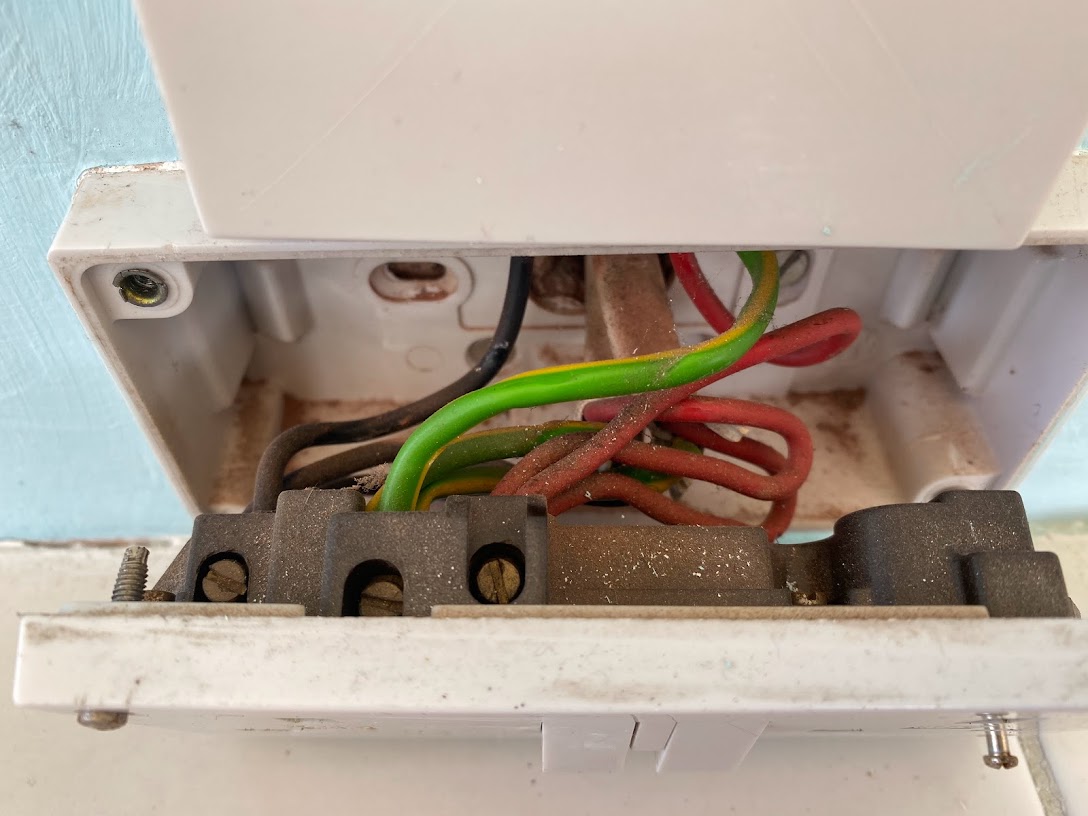

I've removed the socket cover to expose the wiring as suggested. It looks like the wiring goes "into" the wall as opposed to up and down.
With regard to the fusebox - it looks like wiring taps off from the socket and goes up, via the fuse box, and to a swicth and then a light in on the wall.
As I mentioned, the socket is recessed into the plasterboard and not mounted on top. Swapping it to a more modern socket (sizewise) would make it even more cramped in that space.
I've no idea why they mounted a socket so close to the top of the side, unless the side bit (which is some seating) was built in at a later date
I would suggest the easiest way is to simply move both the twin socket and fused spur (fusebox you call it) up the wall a few inches. Three sets of wires, suggests the socket is on the ring, with a spur to the fused spur.

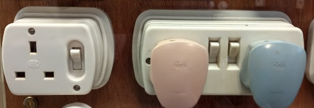

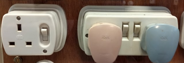

These mini sockets were available before the early 70s in a different style.
These mini sockets are to be surface mounted only (not flush) and were primarily intended to go on skirting boards, where space was limited.
These 'mini sockets' as everybody seems to be calling them were originally the normal style, albeit with a slightly different shape.
In fact these:
I believe they preceeded the 3½" style we are accustomed to.
However I believe these 13A connectors came first:
I hope you're not going to say anything rude about them - I have at least a couple (probably more) still in service in my house :)

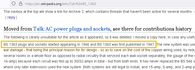

For a start, the ('current') version of BS1363-2 that we are used to looking at, although pretty old, only dates from 1995, which is long after the sockets we are talking about were manufactured. The preceding version of BS1363 was BS1363:1984 (still long after those sockets), but I don't know what came before that.
... so what that means is that I personally don't have a clue as to what (if anything) the version of BS1363 contemporary with manufacture of those sockets had to say about plate size - or, come to that, anything about acceptable dimensions.
Kind Regards, John
It was hard going finding it but I think it's BS 4662:1970 Specification for boxes for the enclosure of electrical accessories. The date doesn't make much sense - maybe there was an earlier one. Trying to access the spec on my file server but it's playing up.
