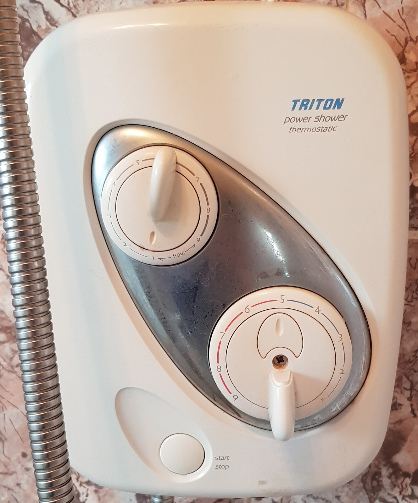

Pic of the shower unit will help.

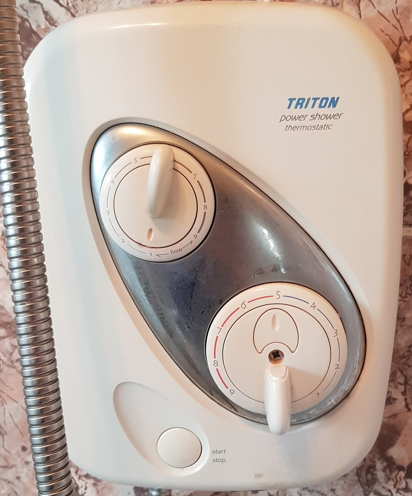

Here's a photo of the shower, and the very old tiles behind
It says power shower and comparing that to other images it appears to be a power shower without a heater. Typically they are powered from a socket ring circuit using a SFCU
86116_P
with a 3A fuse. If this is the case it will go off when the socket circuit(s) swithced off.

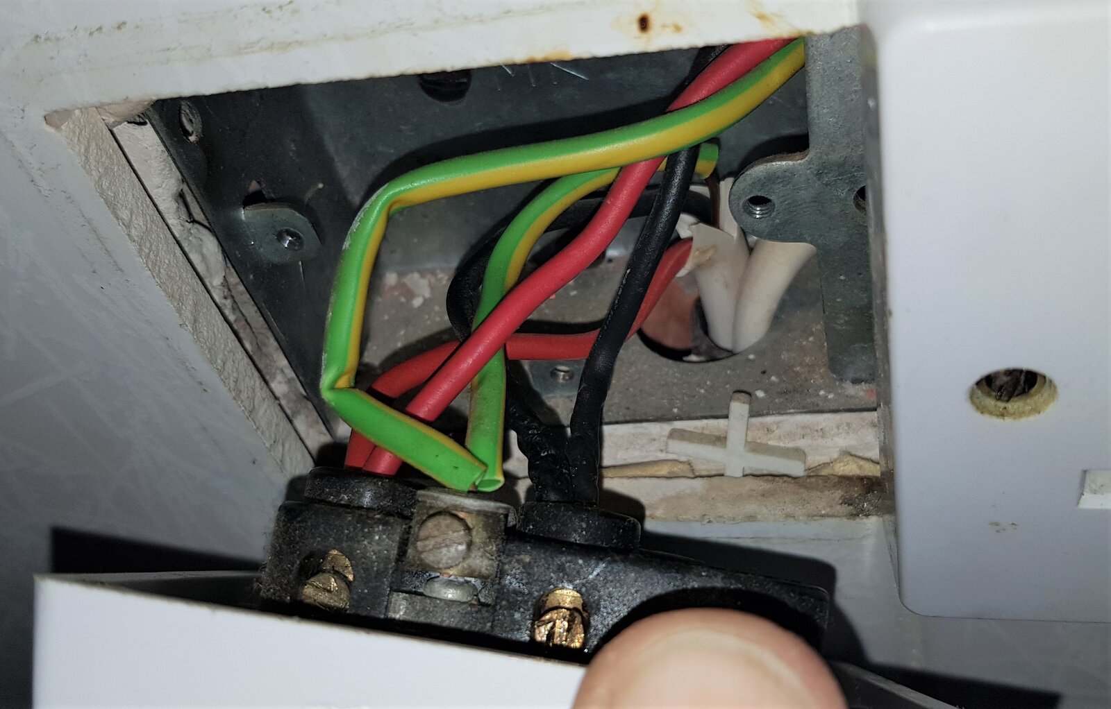

Unrelated to the original question, but there looks to be overheating of the neutrals in this picture.
Yes, this is a socket that had a burning smell and turned out the black wires were not connected well and electricity arching.
It's (I think) where an additional 2 to 4 double sockets in the kitchen are connected. They've been running a washing machine, dish washer and cooker. I'm not currently using them. Seems a lot to be added on to the circuit like this?
86116_P
This is how mine looks to be. Thanks
