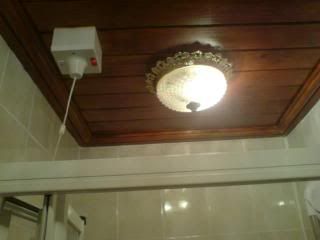

I've posted similar pictures before. This bathroom has an especially low ceiling and a light fitting unsuited to the location...
it's not the light fitting that I'd be worried about, it's the shower isolator actually IN the shower cubicle...
the light may be sealed in ways you can't see.. there may be a gasket involved ( I too doubt that it is... but you never know.. it may be a fancy IP rated bulkhead.. )
That lamp glass will be a right git to clean when its got manky after several weeks of showers :D

Private household owned by someone who likes ornate brass 'n' glass fittings... :honk:
As for the shower, it was fitted by a builder, I think :roll:
