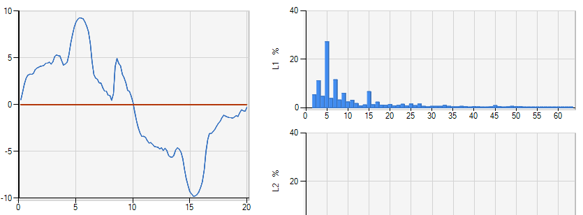

I have, over the last few years, observed the PF of my house slowly changing as the filament lamp & transformer fed loads disappear and more and more SMPS, or variants of it, powered devices appear.
I have my own 'whole house' energy monitoring device, which is a measurement centre (a ISKRA MC750 to be precise) which does take a voltage reference and is therefore able to correctly distinguish between apparent and real power. The device also logs V, I, F, S, W & P at 1 second intervals.
At the time of writing, the house demand is 4.8A, 246V, 968W, - 622VAr, 1230 VA with a PF of 0.84 CAP. (These figures don't exactly work out because I can't capture them all at the same instant). Looking back at the log, its rare that the PF is inductive and the only time the PF comes close to unity is when the immersion heater cuts in and the 3kW resistive load swamps everything else!
Also of interest is the THD, quiet high at 42% with 14% 3rd order & 29% 5th order (The MC750 does FFT upto 63rd harmonic on both V & I) . I think the high THD is down to 'cheap' power supplies, maybe in LED lamps(?)
The current waveform is ..... interesting!

Interesting. Whilst there certainly is an increasing number of loads which are far from resistive, as your immersion indicates, most of the largest loads, which are therefore going to dominate the overall picture, are almost entirely resistive (immersions, heaters, cookers {other than induction hobs}, showers etc.).
As a result, although I have countless LEDs and things powered by SMPSUs/similar, my overall/average PF remains very close to unity. My monitoring system cannot measure it directly, but comparing my figures (kVAh, and even that assuming constant voltage) with my electricity meter (kWh) over any period of time always indicates a PF very close to 0.98 - and the meter itself, which provides a figure for kvarh, always gives a figure very similar to that.
Also of interest is the THD, quiet high at 42% with 14% 3rd order & 29% 5th order (The MC750 does FFT upto 63rd harmonic on both V & I) . I think the high THD is down to 'cheap' power supplies, maybe in LED lamps(?) .... The current waveform is ..... interesting!
As you say, very 'interesting'. I again assume that this waveform represents a time when there were no major resistive loads?

Yes, the current waveform was, pretty much, the same time as the powers I quoted. The loads which were on included 3 PCs & LCD monitors, 42" LCD TV, various LED lights including 7 x 5W LED candle on a dimmer (and dimmed to around 30% ish). The immersion heater, obviously, hadn't cut in so pretty much all of the load was 'electronic'.

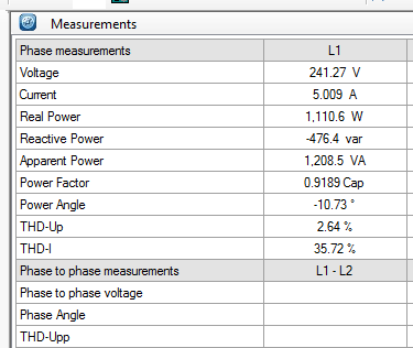

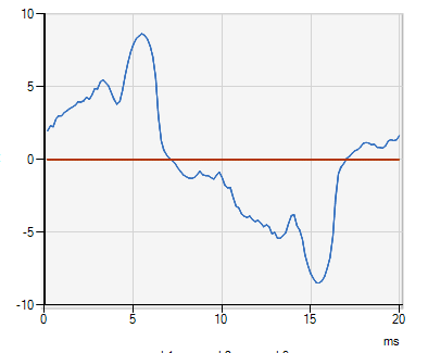

At the moment, its crept up a little, PF is .92 CAP with 1.11kw & 1.21 kVA, I'm not quite sure what has come on-line... maybe the central heating (pump adding and inductive element to cancel out some of the C, maybe)....

Interesting. Compared with early earlier waveform, it's now much less 'symmetrical' (positive and negative half cycles now differ appreciably).

Interesting thread! What does "CAP" stand for in relation to power factor? That's a new one on me...
Thanks :)
I presume it means that the reactive component of the load is net capacative (i.e. current 'leads' voltage by the phase angle in question). With net inductive reactance ("IND" I guess :) ), current lags behind voltage.
Loads such as we are discussing (LED lamps/bulbs, and anything electronic using an SMPSU or similar) will be predominantly capacitative, whilst ones with significant motors etc. will be predominantly inductive. If both are present, they will partially 'cancel', thereby bringing PF closer to unity.
Kind Regards, John
