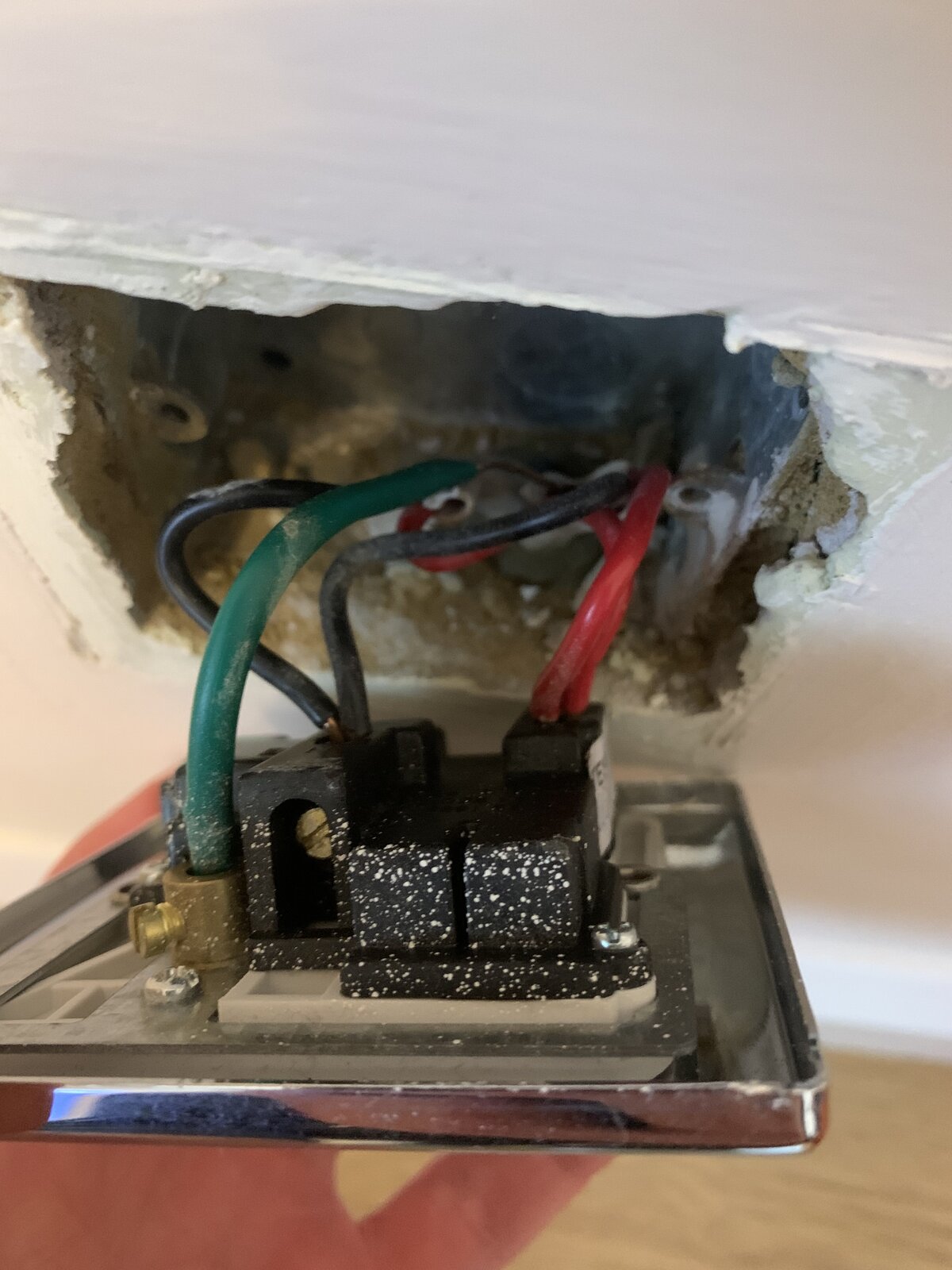

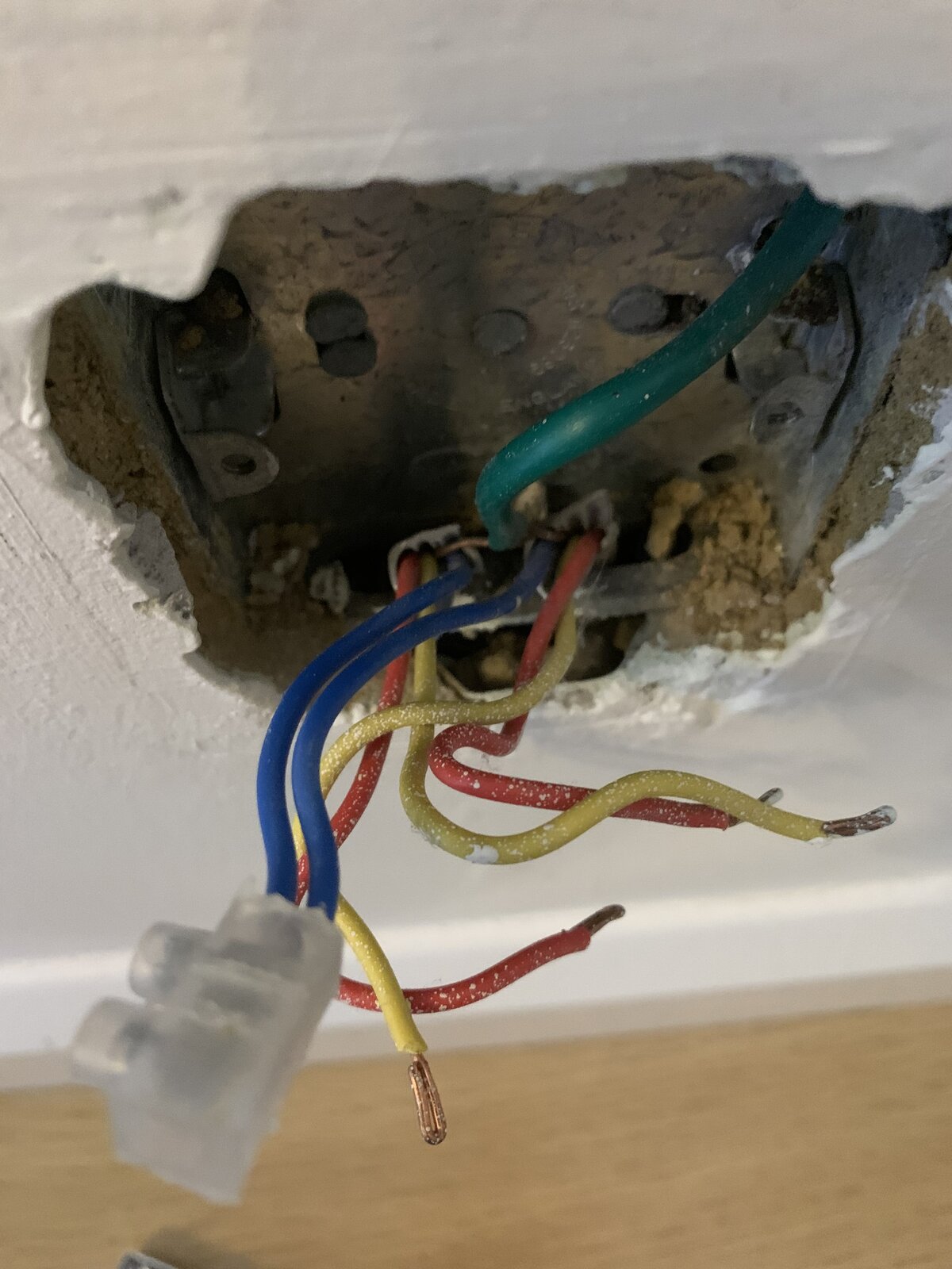

Hi, I want to cover an existing socket (first picture) with a blanking plate and move it further along the same wall to one that is currently blanked (second picture). The current socket has 2 core cable and the blanked one has 3 core with a terminal block over the blue wires only.
Can anyone advise if this is possible?

You can certainly blank the one, but the one that isn't blanked it's unclear what it is but unlikely to be on the right circuit. Could be some kind of redundant lighting circuit perhaps with 2 way switching?
You can, if you wish, remove the socket, join the pairs of wires and cover with a blank plate but what is the point?
The other one looks more like a disconnected light switch, so no, you cannot put a socket there (unless something really strange has been done).
A socket on a ring final is normally fed with two core and earth 2.5 mm² cable. In the main 3 core and earth is used for lighting so seems likely the other wiring was for a standard lamp likely a radial not a ring final.

Given that there are wires left unterminated, I sure hope (whatever it was) that it was disconnected at the other end.
Thanks for the replies.
The second picture (the 3 core cable) is located close to the floor along with all other sockets in the room. It isn't the height of a light switch, not sure if that would rule it out being on a lighting circuit?
Guess I will have to see if/how much power is going to it?

The first paragraph, it is intriguing, we have a roughly similar setup in our bedroom, one switch at the door and one at the bed, and the switch at the bed has the lamp connected. I used 3c+e to connect them.
I think the blue would be neutral and the red and yellow are the switched lives, either one is live depending on the position of the main switch., The switch at the lamp end would switch the light between those two.
There may have been a second lamp that was daisy chained, and they used 3c to chain it for some reason? Lack of 2c cable perhaps.
Hopefully that makes sense.
To the op, you would need to remove any other blanking plates in likely places and look behind the light switches etc.
You can probably get detectors to follow the cable across the wall if you're struggling.
And when you work it out, assuming it is 1.5mm² cable or more you can connect a new socket with a fused connection at the other end, so no need to dig up your wall. But it might be less hassle to just dig the cables out and drop new ones in as an unfused spur.
