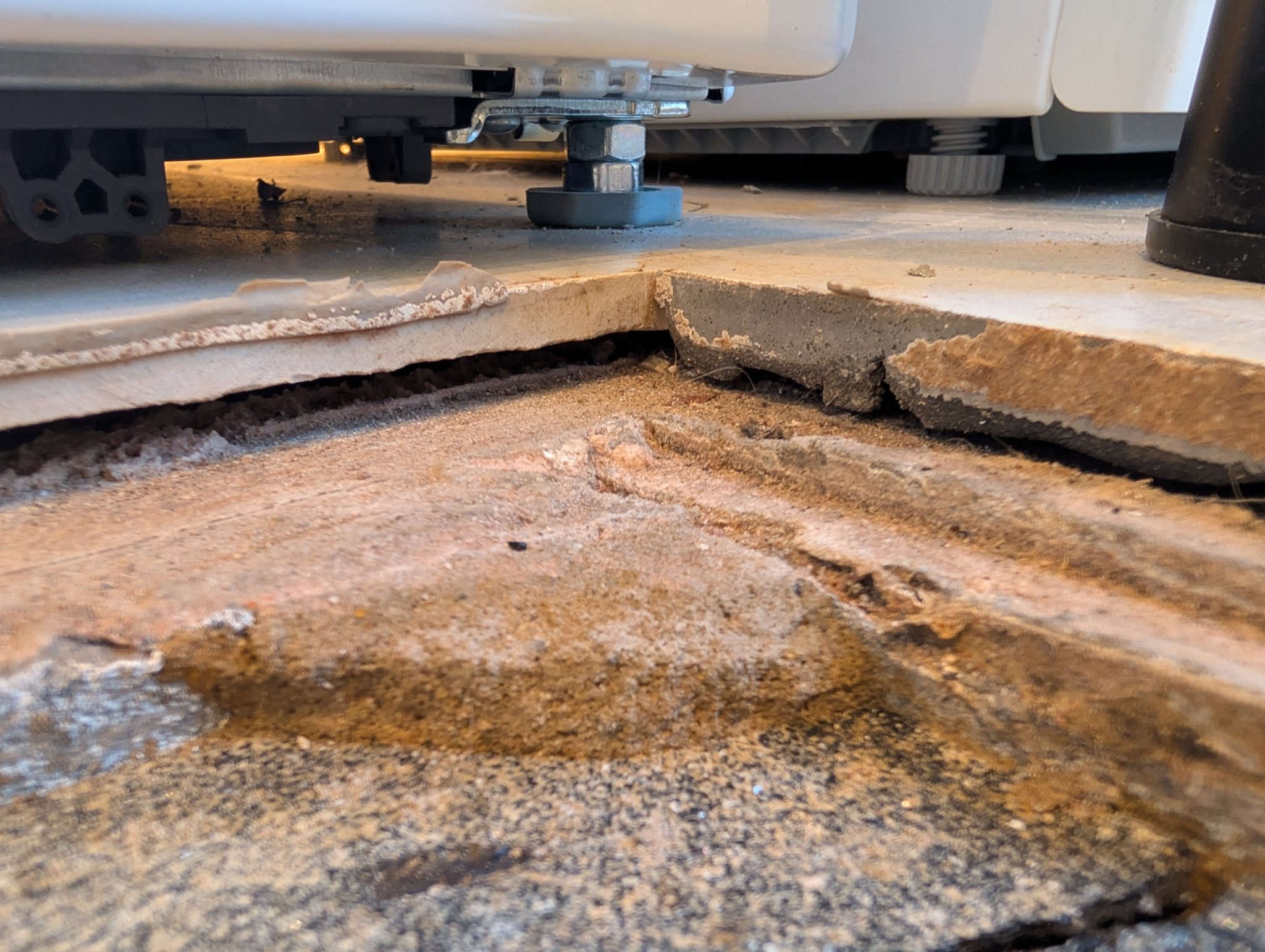

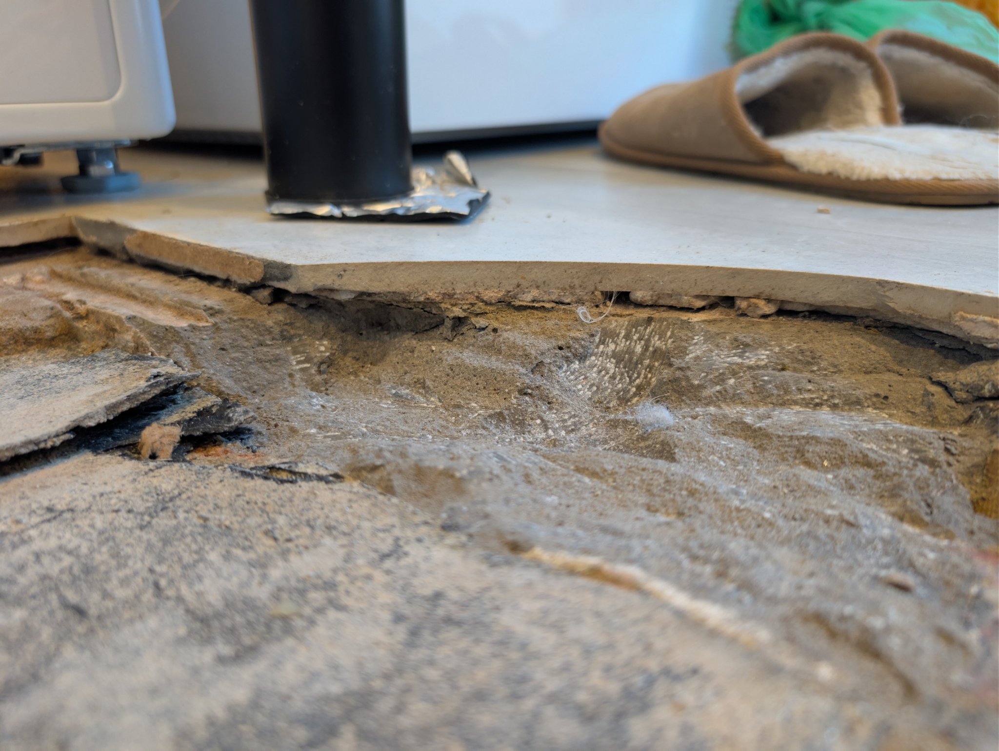

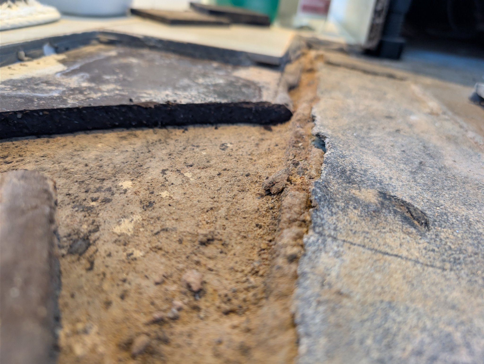

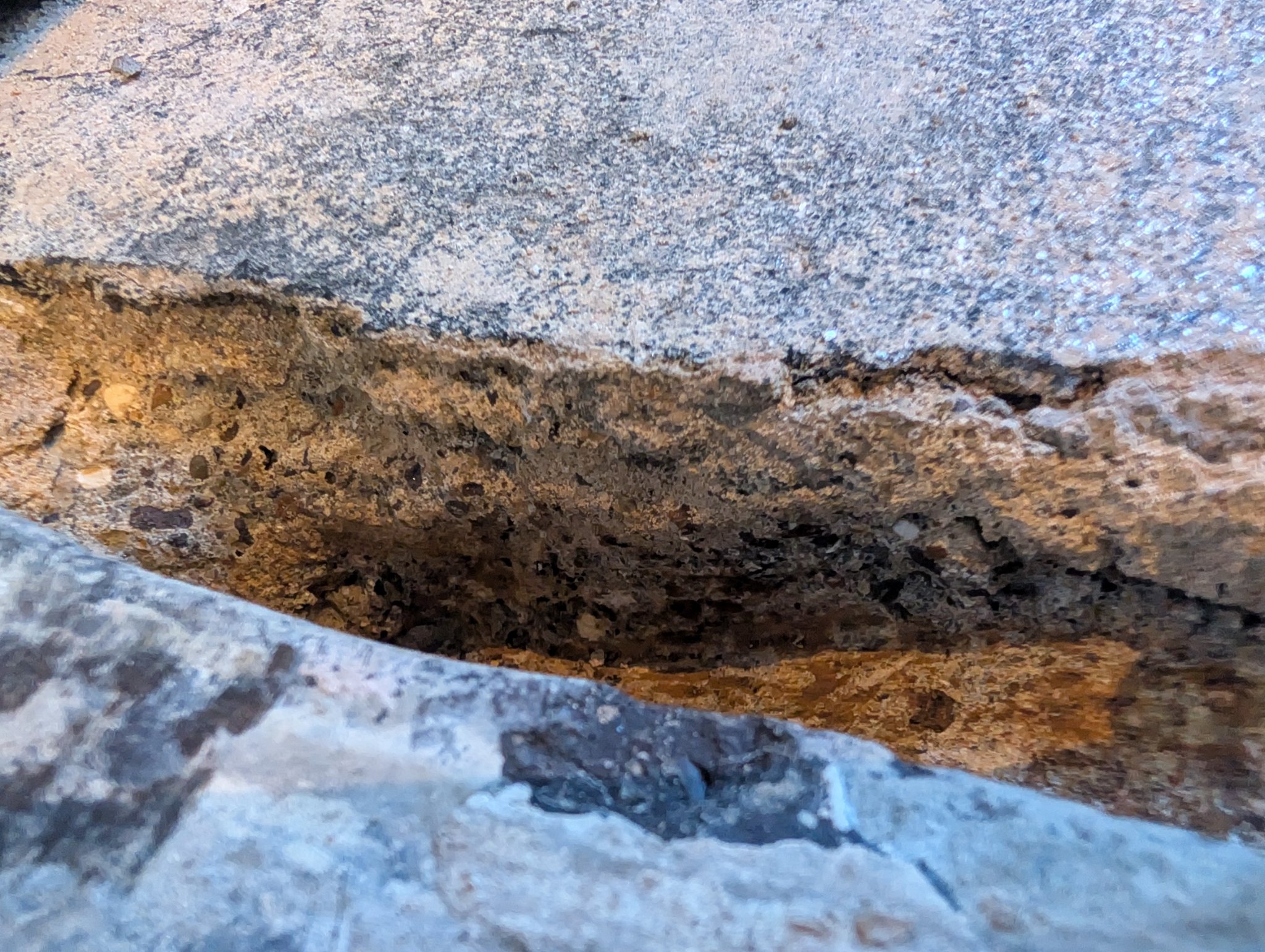

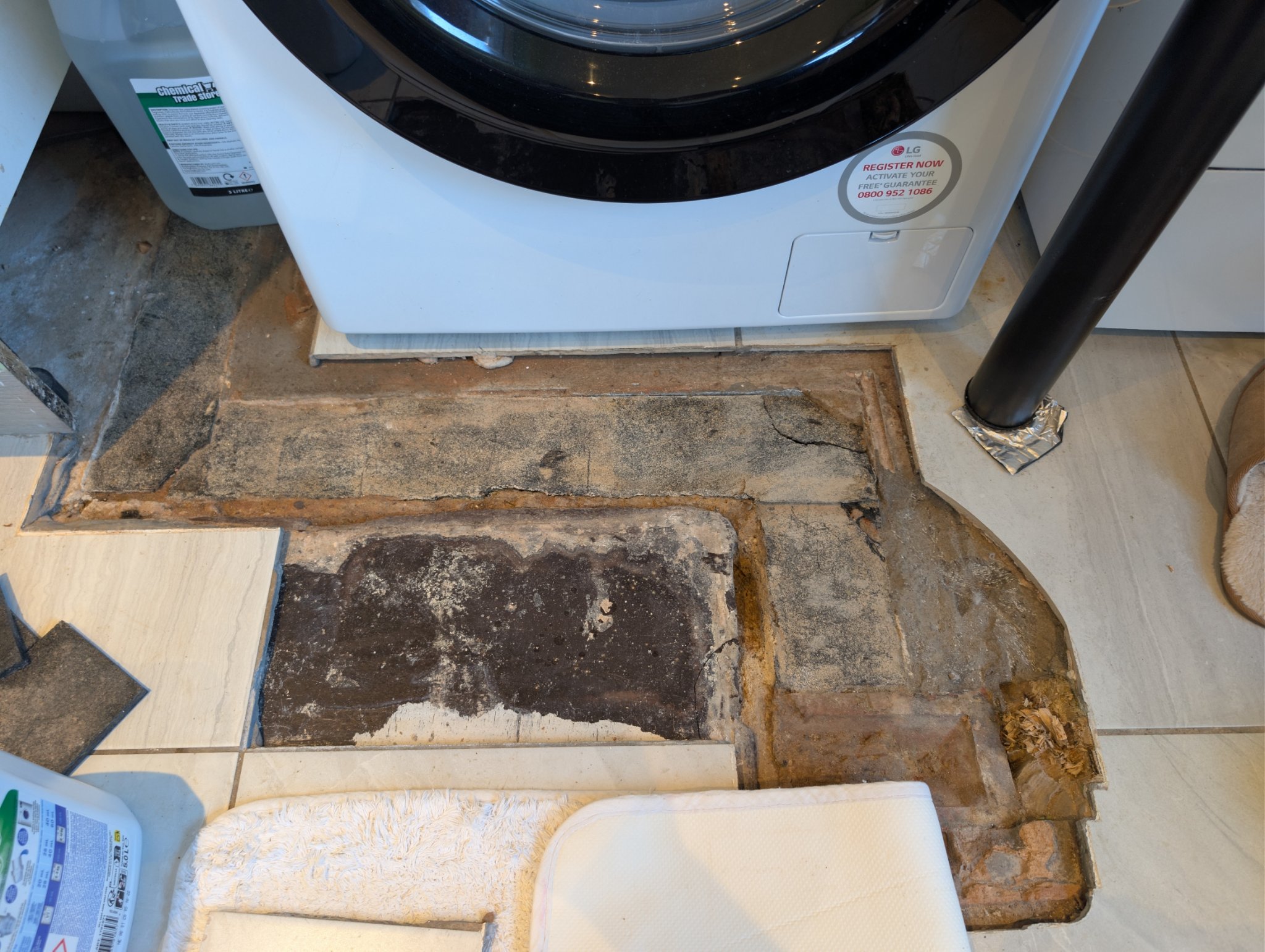

Hi everyone,
This was surprising... I have removed a partition wall which was creating a small cubicle in my kitchen. Previous owners had a combi boiler and washing machine in it, but there was simply not enough space in it, so I decided to open it up fully to the rest of the kitchen.
This is 1960s bungalow, and to my surprise this wall wasn't made out of breeze blocks but typical red bricks. My sub floor is made out of concrete (I think) but I honestly do not know what am I am looking at now after removing this wall. It seems like there is a bit of wood, brick, concrete, asphalt and some other dpc layer.
How do I fill this "gap" and tile over it all?
I had somebody who is going to help and they said pva and tile adhesive will do the job. From what I tried to read, it would be better to go with some cement to fill, liquid dpc, sbr and then tiling over, taking few weeks now for all of it to dry properly. Is there a quick 5 day turnaround solution perhaps?

Any original plastic like tiles stuck down with that black bitumen will be asbestos although low risk.
1964 bungalow here
I dug down where I took walls out and lined with plastic dpc and poured concrete.
About 75 to 120mm deep.
I scratched through the black bitumen with grinder and used a self leveler over the lot. 2 pack self levelling so no water was used to mix. I was told it will stick and so far 20 years on its good.
Tiled over the lot
Bricks, suggests it could possibly be structural, did you investigate before demolishing?
Yes, we had a structural engineer coming over checking things. This was structural for the chimney and kitchen setup, I think he said something in terms of keeping a wall supported for side to side movements. However, that whole thing is gone now as well. And no joist or roof construction been supported on it.

Ideally the DPC wants lifting (and pinning out of the way or removing) a course of bricks removing, the trough lined with DPM and then filled with screed mix. If the rest of the floor is insulated, add a wee bit of PIR in there too, if you have the depth.
