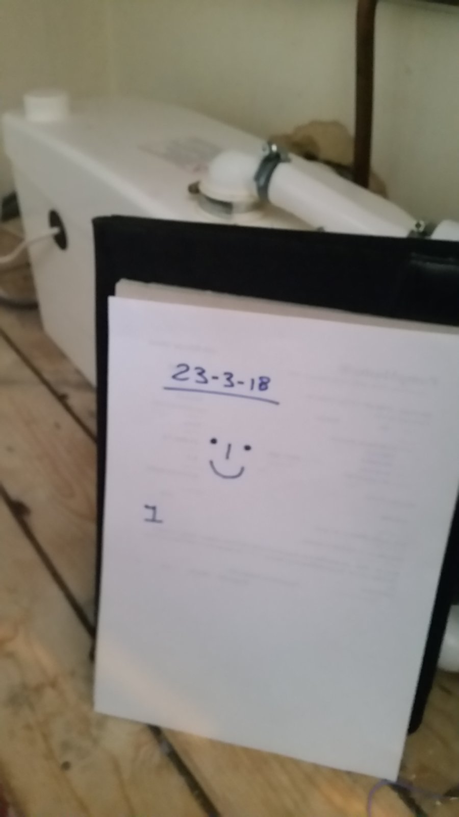

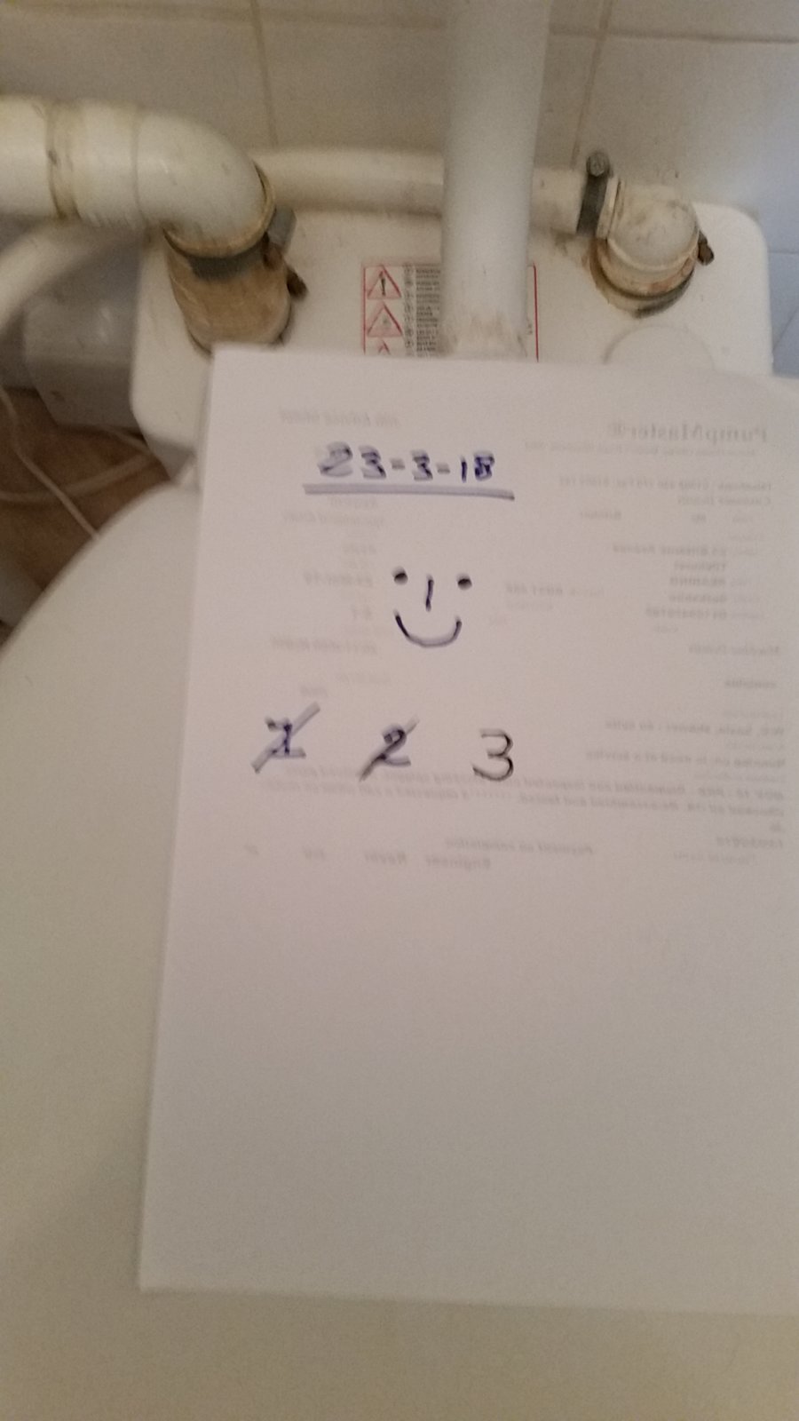

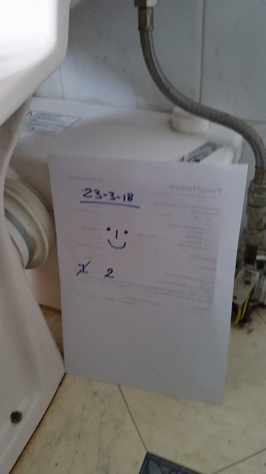

Saw a Grundfos installation guide for the WC-1 today and noticed that they allow a 3m horizontal before the rise! Sounds crazy to me and goes against everybody else but it`s there in Black & White.
