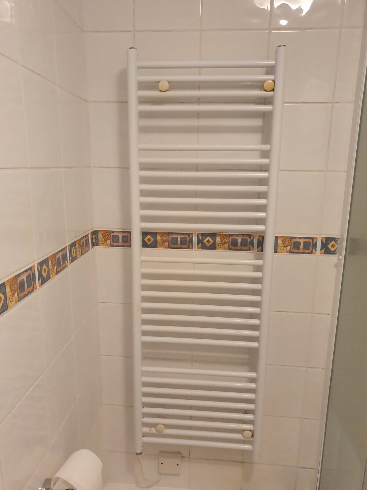

When the heating is turned on, all the radiators in the flat is on. But the towel rail in the bathroom does not heat up. I have a combi boiler. Photos of towel rail are attached.

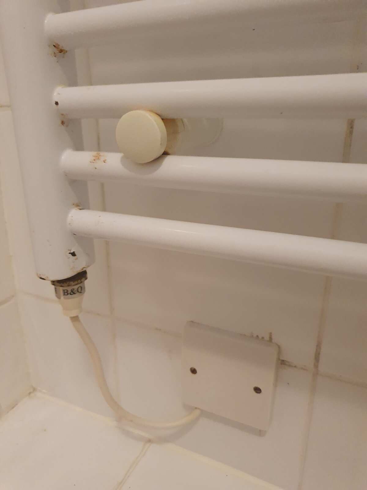

Looking at the towel rail - there's a wire coming out of it at the bottom but no valves(?). I'm confused and wonder if the rail is even connected to anything?
Thanks in advance

I see no pipes attached to it, so it must be an electrically heated one. This might have been done to save on plumbing work, or perhaps so it could be heated when the CH was turned off.
The switch for it might be on the other side of the wall where you see the electrical outlet. Or the cable might go into the floor and emerge at some convenient (or inconvenient) point. It might be close to the bathroom door. It could be inside the bathroom, as long as it is away from the fixed bath or shower, or perhaps hidden in a cupboard.
It will most likely be a switched, fused, conection unit, preferably with an indicating neon.

it might be on a timer. Some low-power rails can be wired to a lighting circuit, and might come on with the light switch, or the extractor fan.
It's possible that some previous occupant disabled it because they were enraged by the cost of electrical heating (about four times as expensive as gas). Unfortunately, unless you have having work done on the central heating, it will be quite expensive to plumb in a radiator or rail and will perhaps involve taking the floor up.
It's simply an electric towel rail, no connection to the heating system. Allows towels to be warmed when heating is not required. Look for an electrical switch in an adjacent room or cupboard, (for safety reasons only Pull Cord switches are allowed in Bathrooms, this will probably have a wall mounted switch outside the room.)

Thanks for the clarification. There is a switch located just outside the bathroom. Ran some tests;
1. Turned the switch on
2. Turned the switch on and bathroom light on
Changed the fuse in the switch and retested 1 and 2. For all scenarios I left it running for 15 mins to 30 mins and there were no heat generated.
Does it sounds like it has been disabled completely?
The element may have died, you need someone to rest it for you, starting with finding out if it has a supply.
