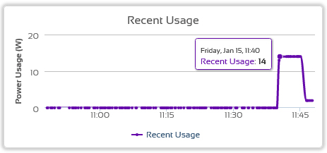

It depends on battery and how charged, my charger works in stages, so when looking what car used I get a graph like this Jag battery charge Jan2.jpg the jump in output when something happens at 11:40 am every day does not really show what that something uses, as the charger will only output at 0.1 or 0.8 amp in this case so even it the car used 24 amp for 10 seconds it would still show the same as 4 amp for a minute.
So the meter on the supply will tell you what the battery uses, but not what the motor uses, it depends on how the battery charger works, lead acid batteries often do have a fixed voltage to charge, but more like 13.4 volt not 13 volt, and other rechargeable batteries use all sorts of devices to work out when charged, from a temperature sensor to delta V, doesn't matter what that is, just that the battery charging current may not relate to what the motor uses.
