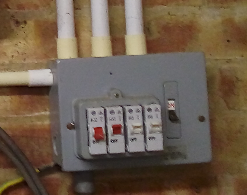

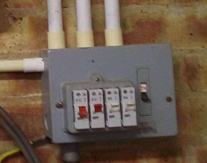

I have 2 Wylex fuse boxes in service in my home. Shed and granny annex (used as workshop/store) admittedly probably now with 50% of MCB's rather than fuses. They are not inherantly dangerous but they are 30 to 60 years old.
Bear in mind the bakelite material does get brittle with age and I will isolate with the main switch/RCD before pulling a fuse as they have on rare ocassions been known to crack.
And this one has been in use for 40 years with a test every 5 years. Each year the same 'faults: no lables and big gaps round the MCB's
I wouldn't suggest filling your existing fusebox with MCB's as the cost is likely to be very much in the same ball park as a whole modern CU.

That looks similar to mine except not mcb...and it is interesting as the last electrician said he hadnt seen one in 20 years! (wylex)
I want a CU, and can afford that (the guy who wanted cash and no bank transfers said im looking 400-600 which is fine even if it was double that) but the electrician that does have time to do the job and is registered seems already to have decided i am looking at a rewire.
Its not just the cost, its the destruction to the house that a rewire would cause.
I might put this off 6 months and save some cash so that a rewire if needed will not cause hardship, from what i have read here, i am not taking massive risks having a wylex for another six months- and logic suggests something that has caused me no issues in 20 years (1 fuse replaced, i called out an electrician to do it) is not going to suddenly become deadly.
