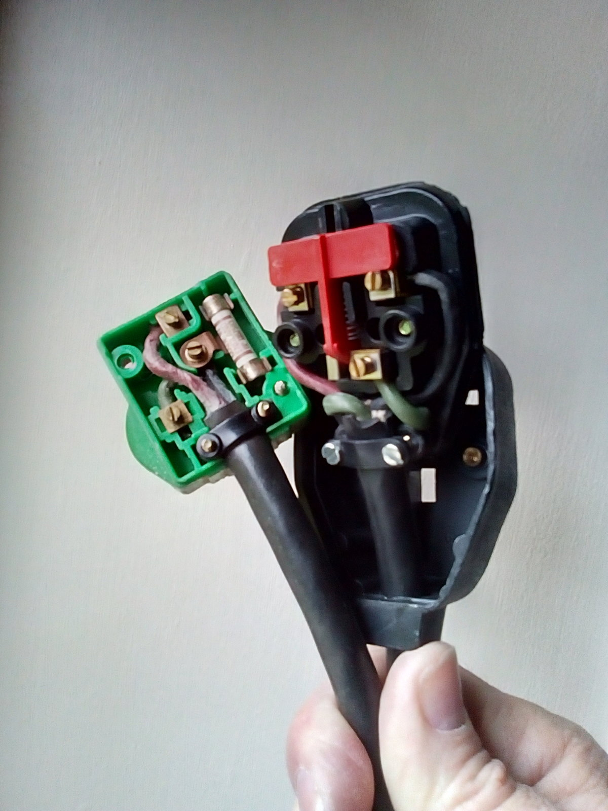

such as from jan 2019:
the extension lead

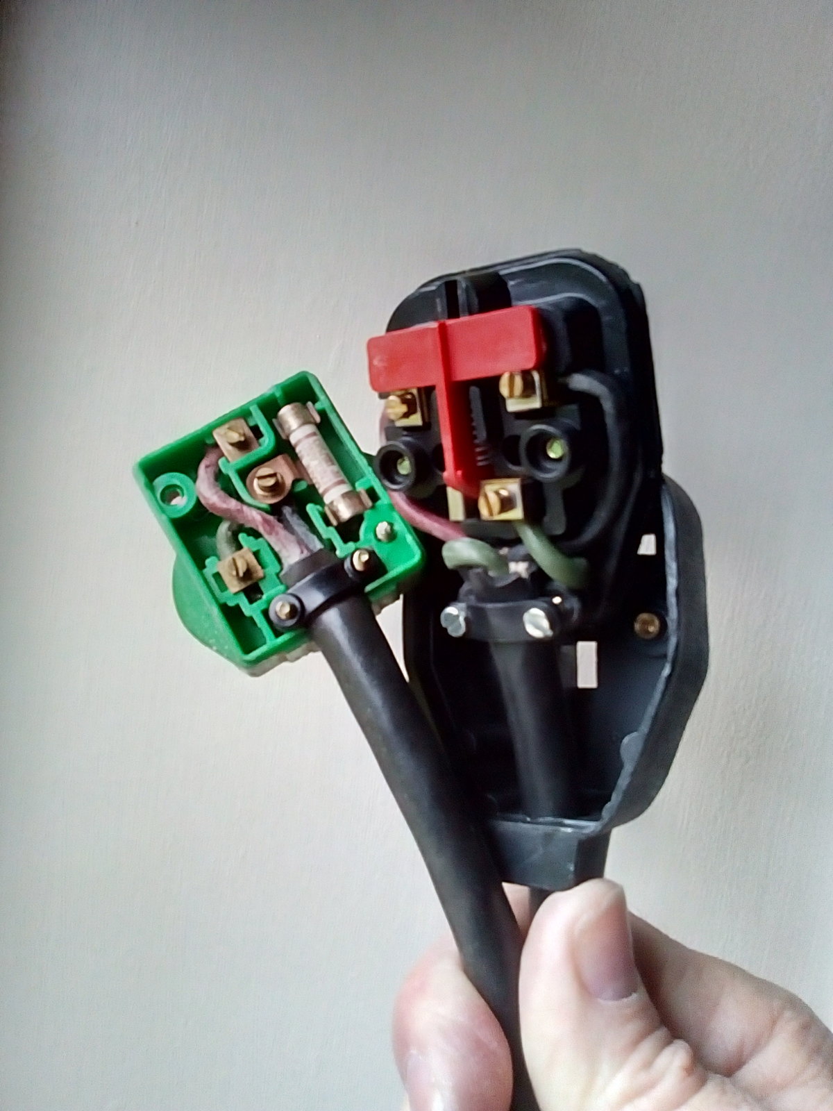

in The tenant moved in last week and complained that one of the sockets is faulty. I checked it yesterday and gave it a clean bill of health.
Called back today as the rcd operated when they used Henry but the socket a few feet away was OK (a 15A radial, labelled lounge heater, on the non rcd half of the board as opposed to the ring). I checked both sockets dead and alive.
Then tried Henry with no problem.
"It tripped when my husband Hoovered the car"
I asked for the extension lead to check
"Oh there's nothing wrong with that, we've had it for years.":View attachment 156490

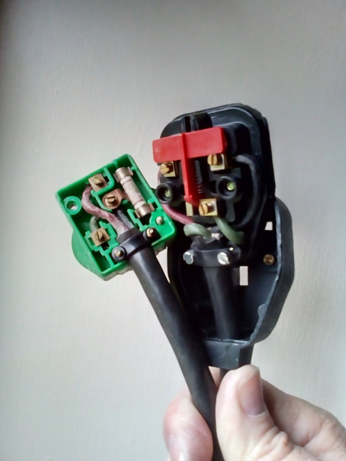

the extension leadView attachment 276638 in The tenant moved in last week and complained that one of the sockets is faulty. I checked it yesterday and gave it a clean bill of health.
