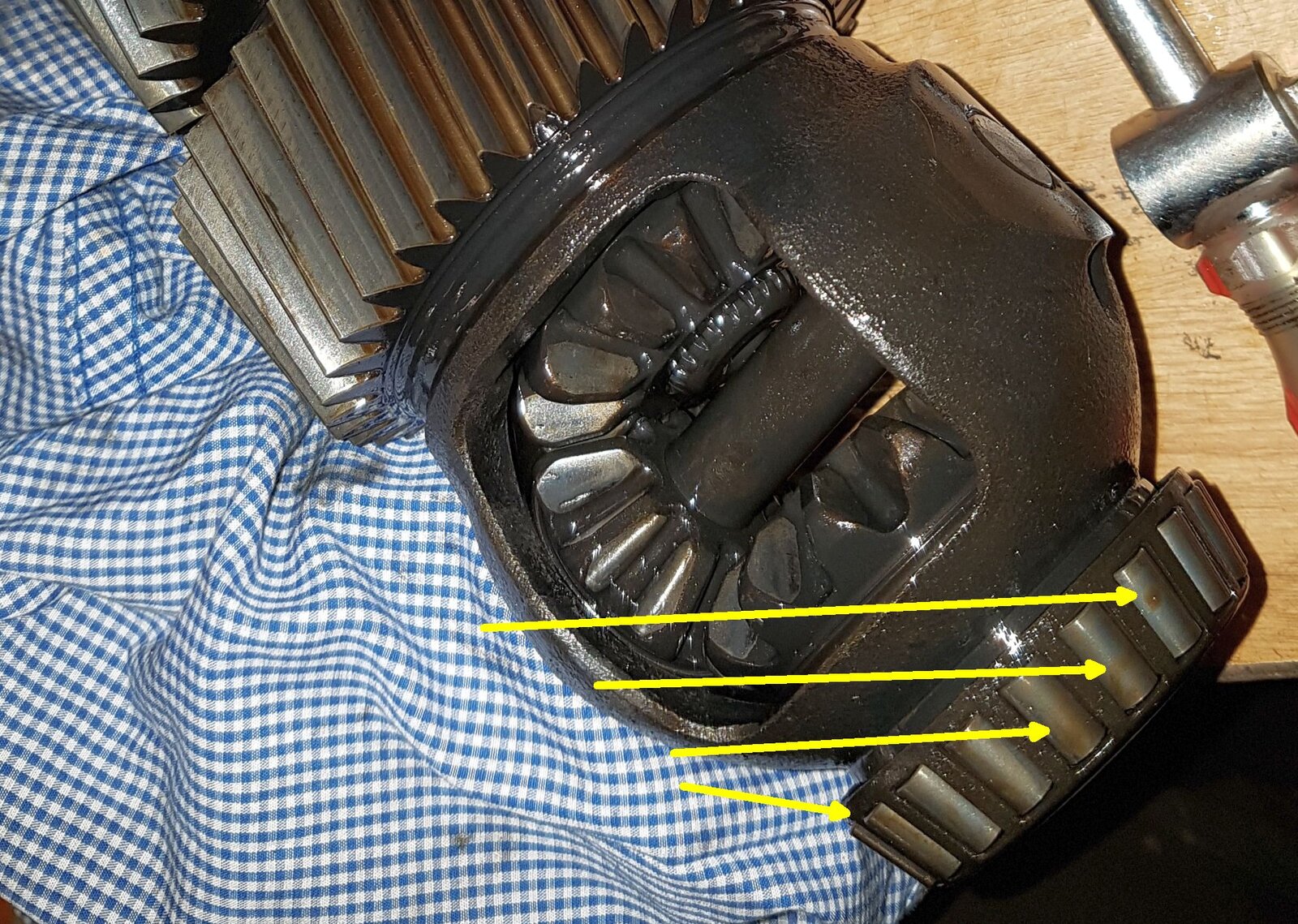

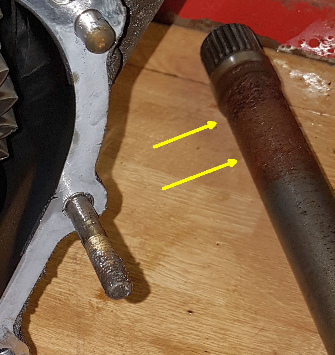

Often, however, it's not actually water getting into the engine that's the problem, but in the long term, it's what has happened inside gearboxes and differentials when water has gone down the breathers. Also, depending on where various electronic control units are, you can get problems days or even weeks later, with condensation forming inside them, from tiny amounts of water that have got in.
That guy with the underwater Tesla reckons he got away with it, but it's actually months after the event that he might well find small quantities of water that didn't prevent it from driving at the time, subsequently causing havoc.
This was my brother-in-law in Wales in a Freelander 1 some years ago:
And this was the inside of the transfer box (or IRD as Landrovers call them), when I rebuilt it about 5 years ago...

This is what awaits you some months or years from now. Water doesn't only come from flooding. Condensation produces a lot of h2o.
