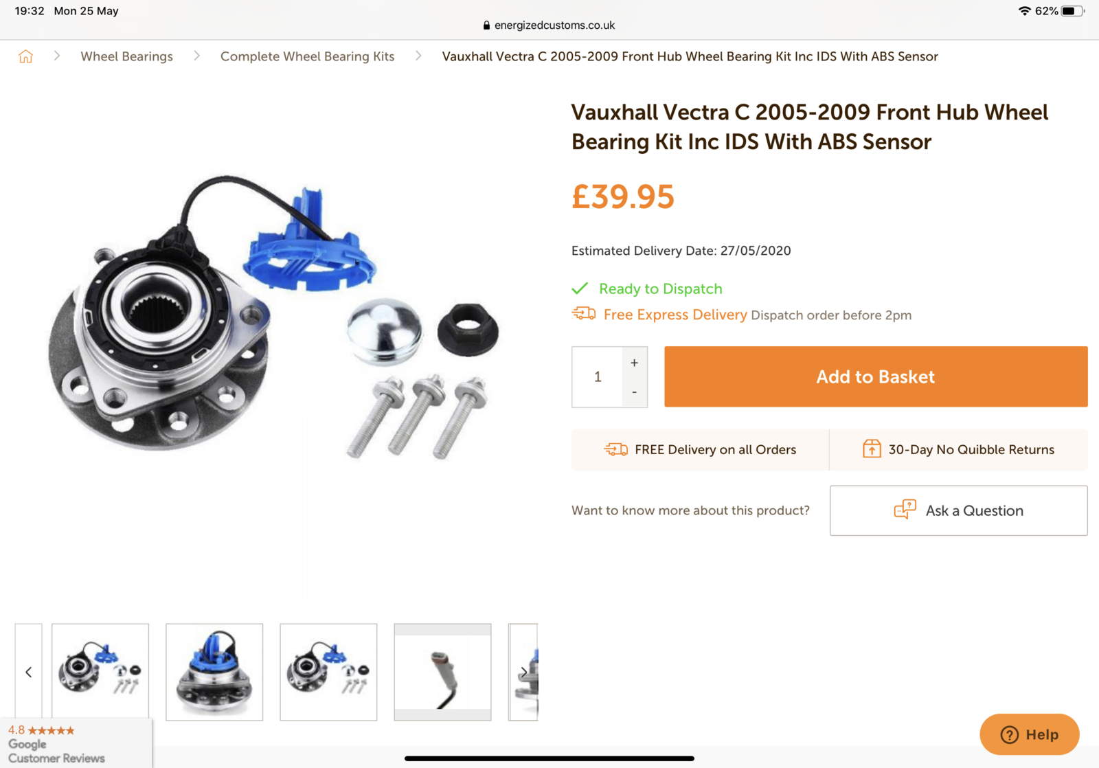

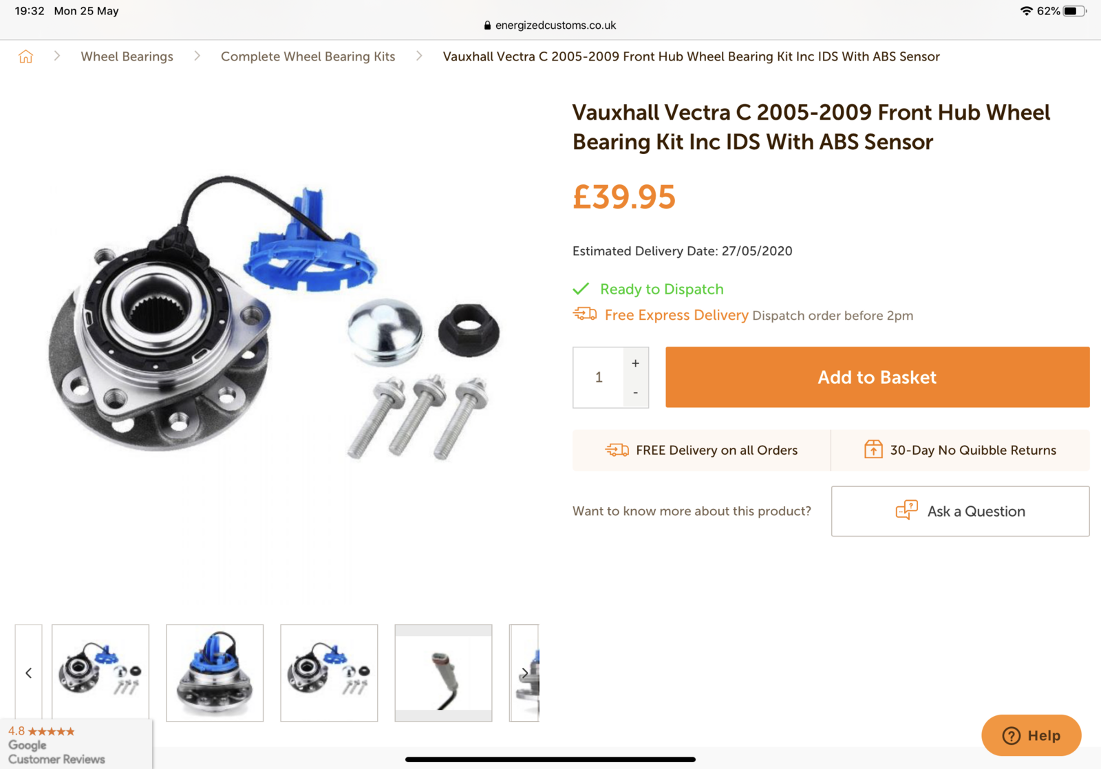

Yes, I remember when I did the wheel bearing on my previous car ( 06 ford focus ) I had a mechanic friend press out the bearing and press the new one in, I then reassembled it to the car. How much would a garage possibly charge to do this if I took the hub to them and asked them to press out and press in the new bearing ? thanks
Check first but I think these bearings come complete with the flange so no pressing out required - just a matter of unbolting and removing the drive shaft and bearing/flange carrier.
Edit. Looks like it does come complete with drive flange.
  • Hey mottie, thanks for the reply, I think you are right, it looks like it is a straight swap out replacement
