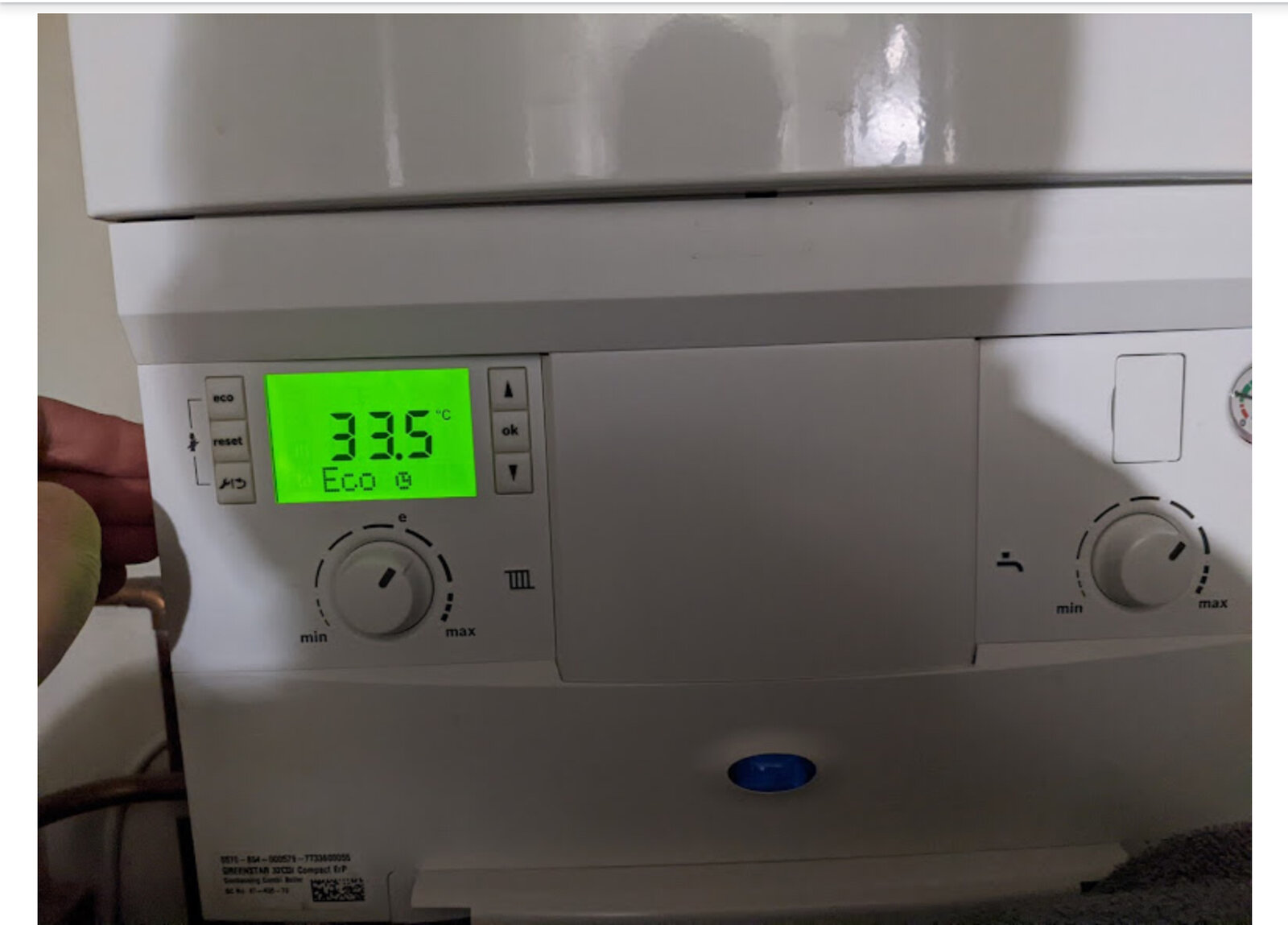

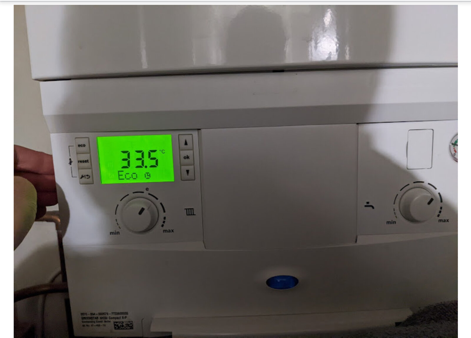

But my boiler won't let me use preheat mode. I have eco or eco with a clock picture.
Why can I not set preheat

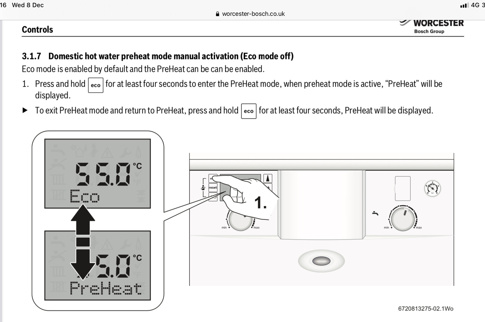

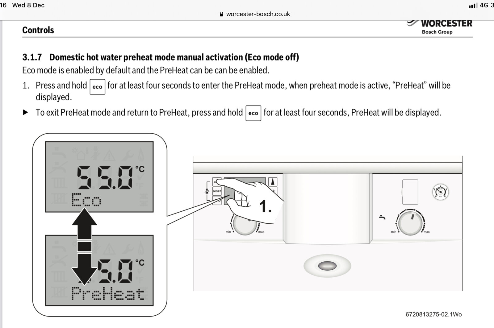

Press and hold eco button for 4 seconds, this should change display to read preheat
Hi, it doesn't do that, that is my original problem. If i press and hold, it shows "ECO" with a photo of a clock, then if i press and hold it again , it just says "ECO" without the clock.
Hmm, seems strange, manual (unless I have the wrong one) states at least 4 seconds, have you tried longer?

Yes, so it only switches between eco or Eco + clock. I think it's because the plumber wired into my dual channel hive, but the HW function on the hive doesnt switch boiler to preheat mode.
There are two options available. When new, the Greenstar is supplied with a hard wired link between a permanent live and the preheat function allowing the ECO button to work as described. The installer has the option of removing the link and wiring it to the hot water channel of a two channel programmer instead. If this has been done, the ECO button will only work when the programmer (ie Hive HW) is set to be on (which simulates the hard wired link being present). I'm guessing it isn't 'on' and that's why the boiler display is letting you know that it's waiting for the programmer to turn it on.
