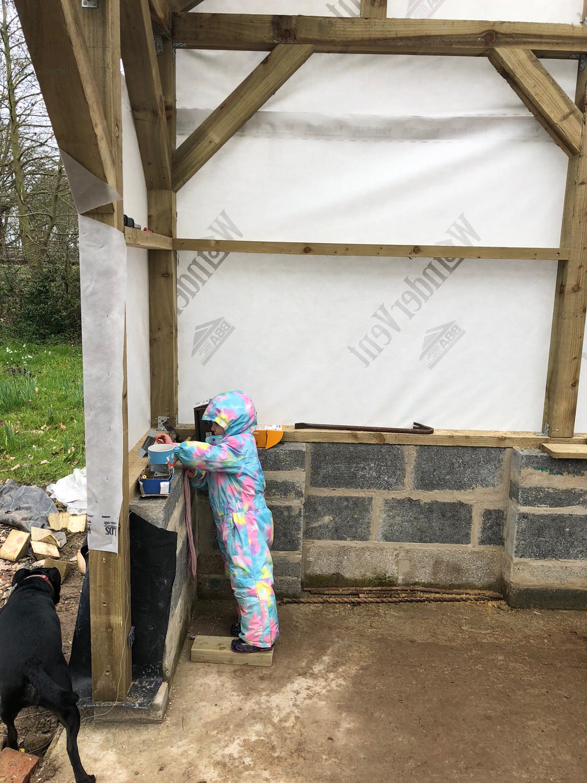

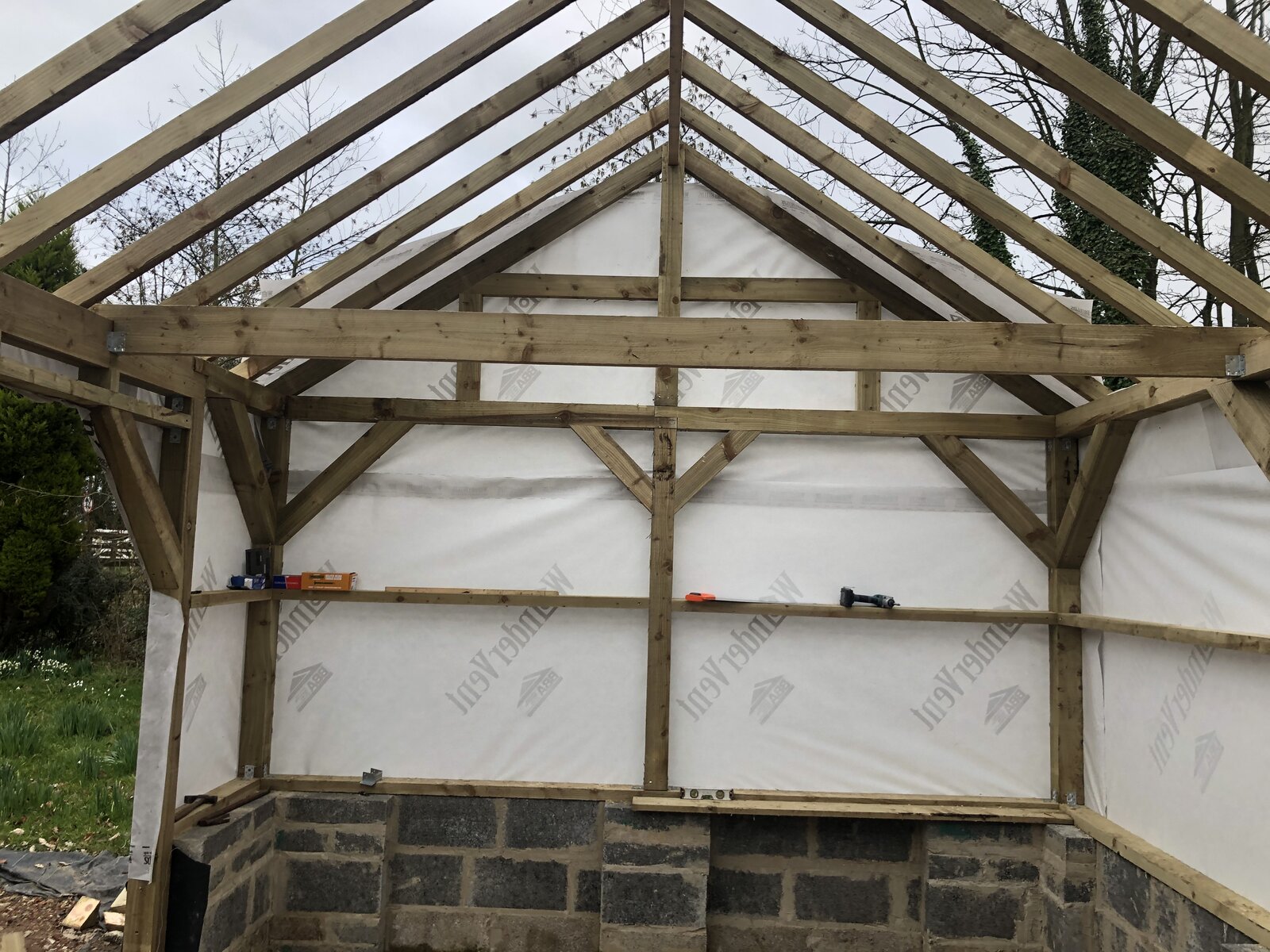

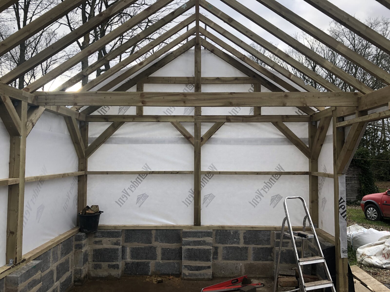

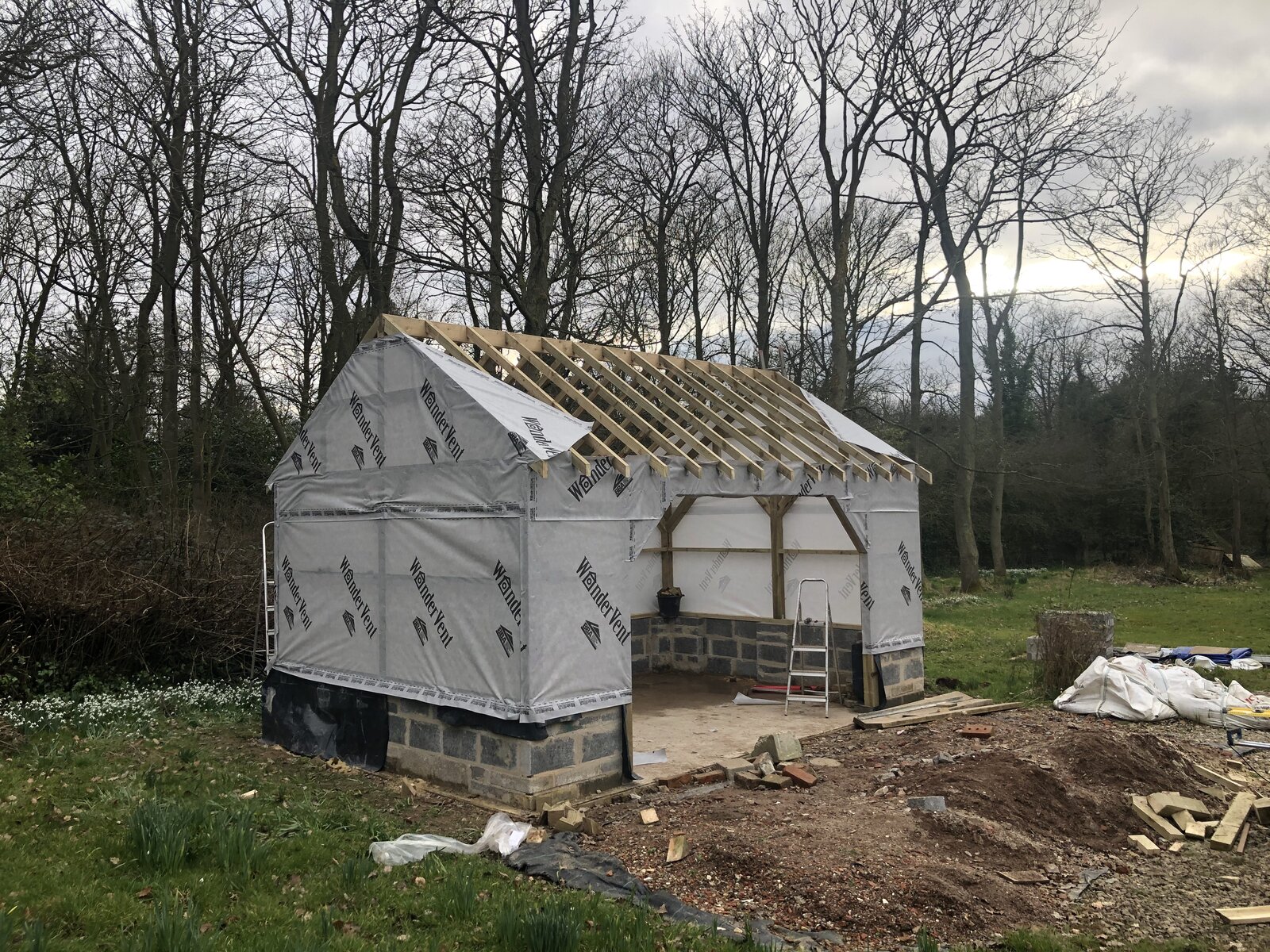

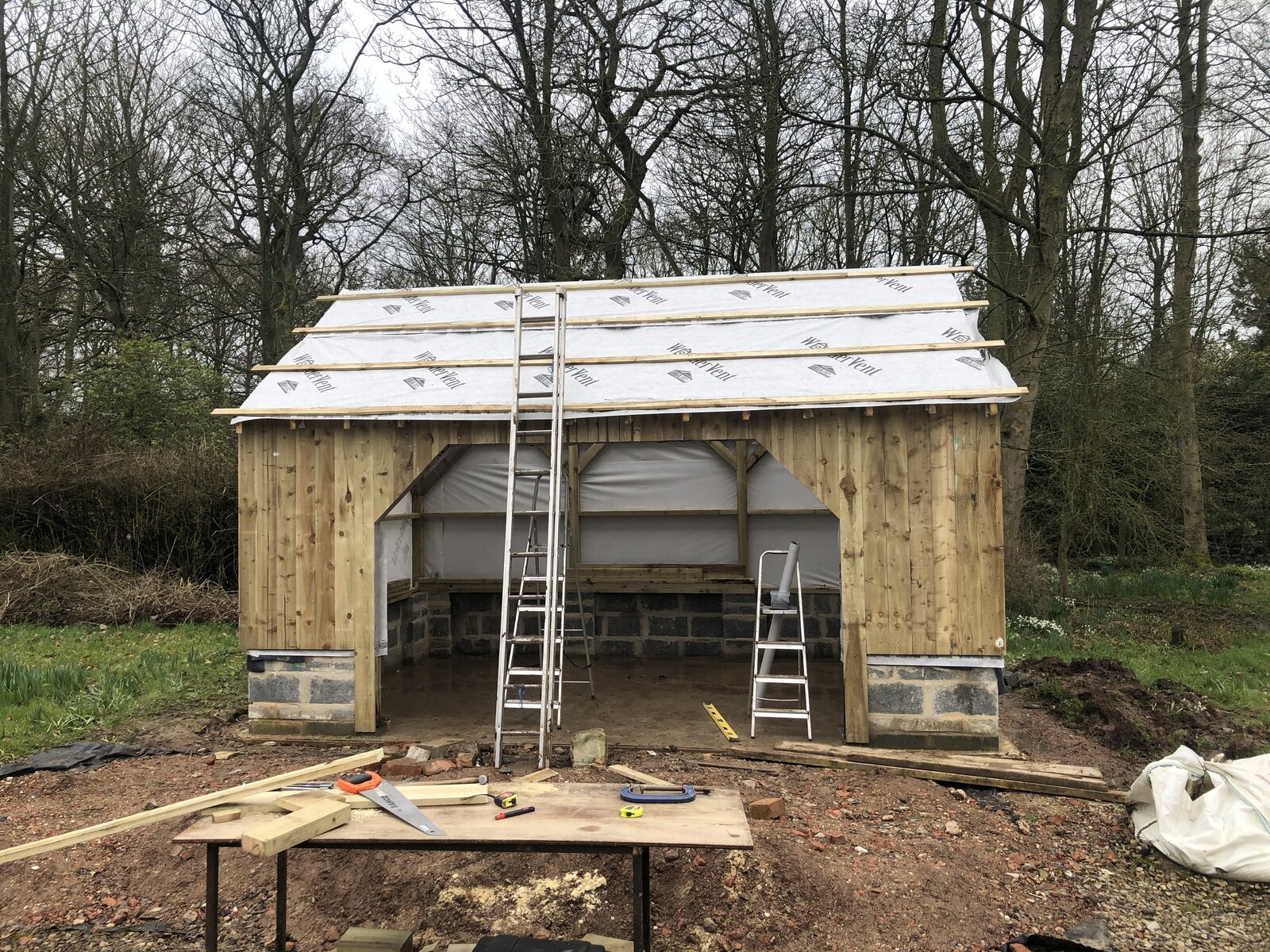

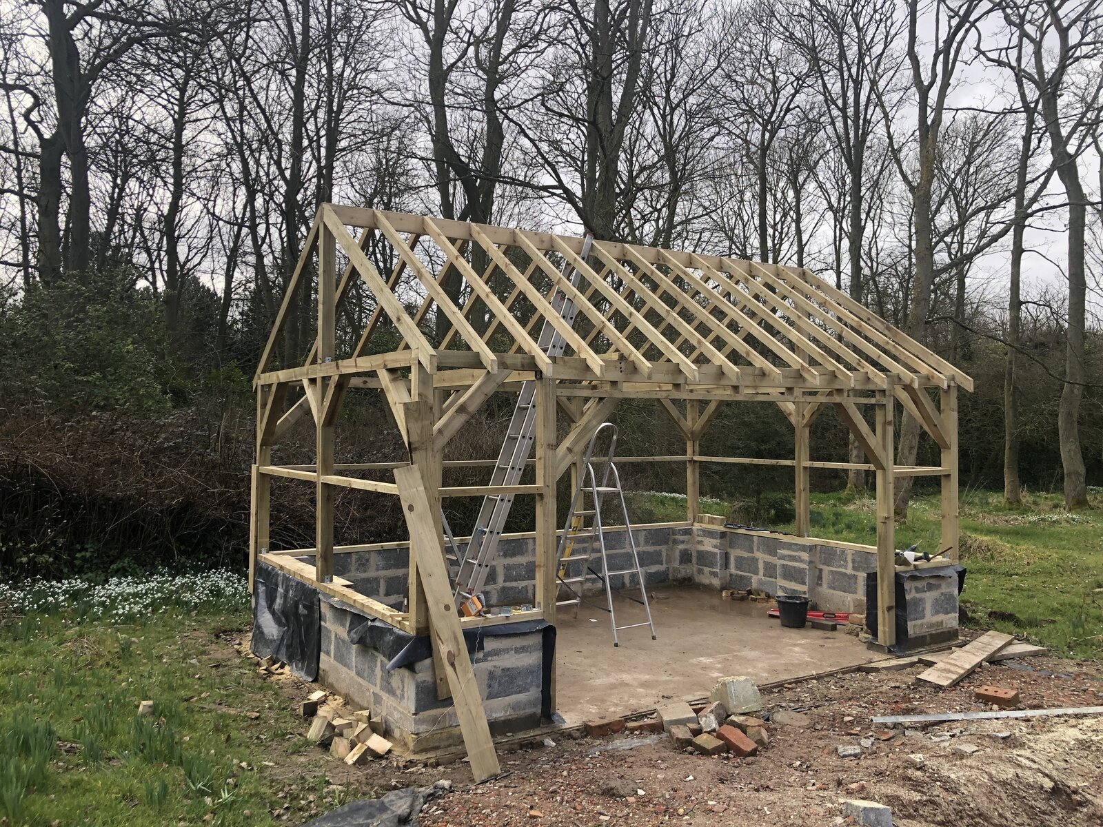

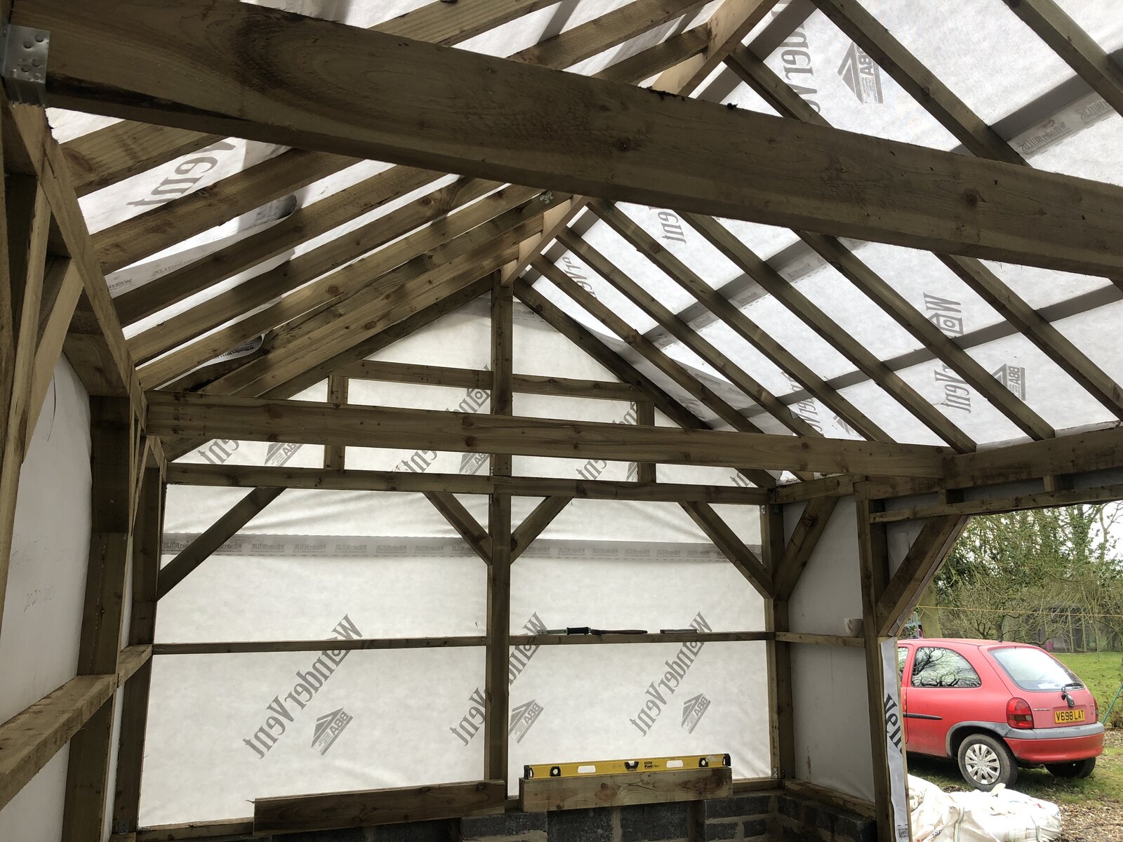

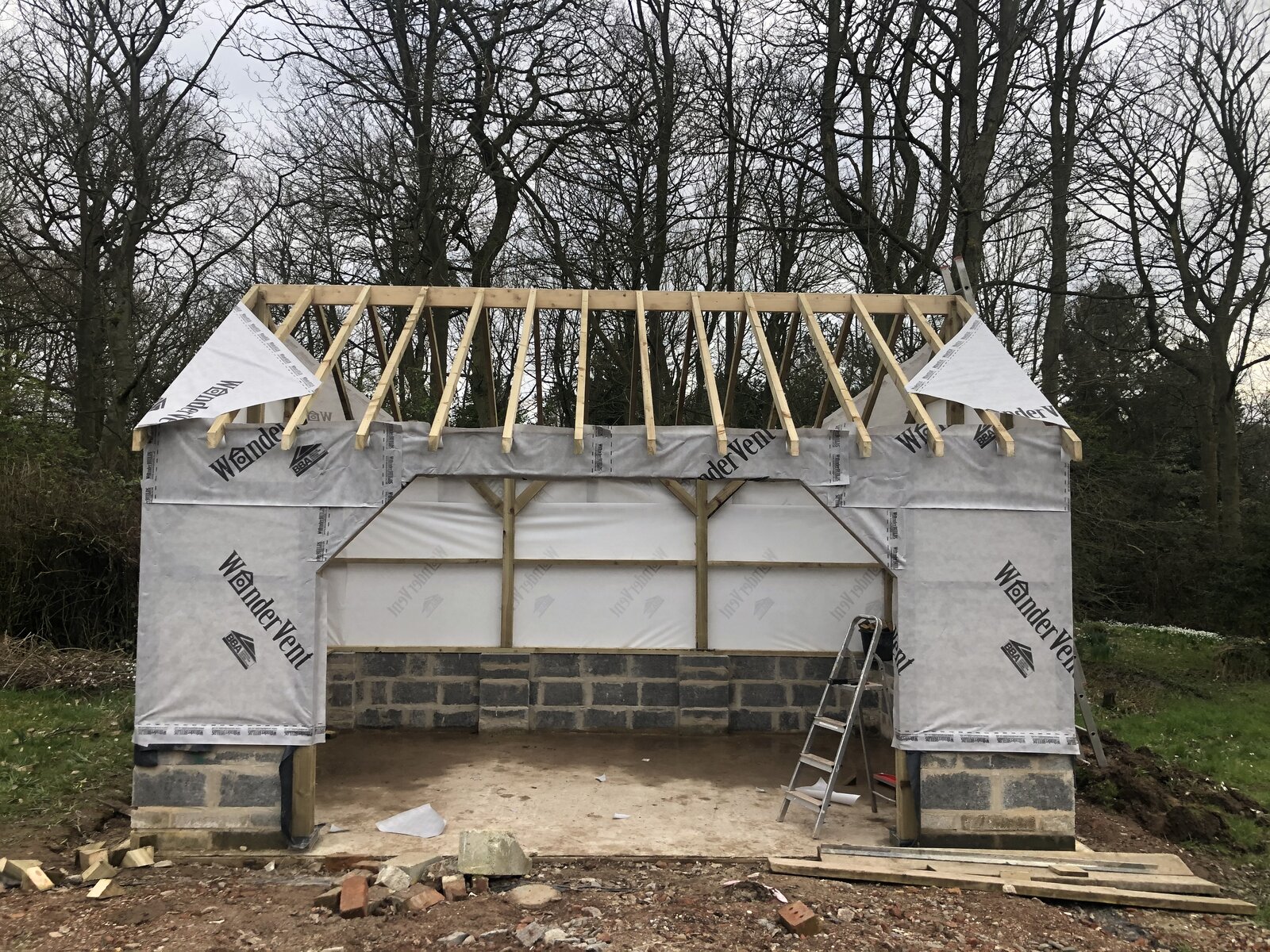

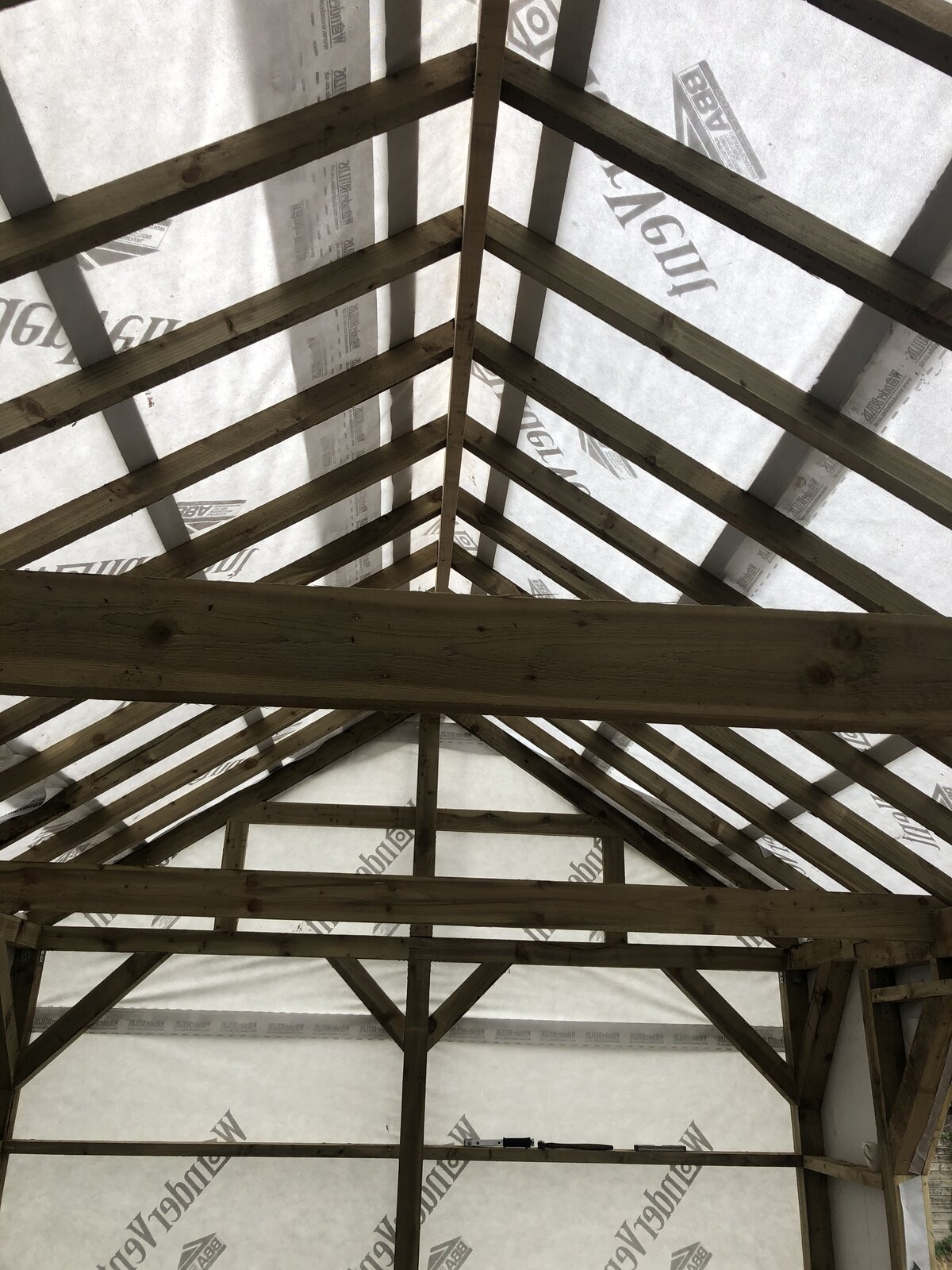

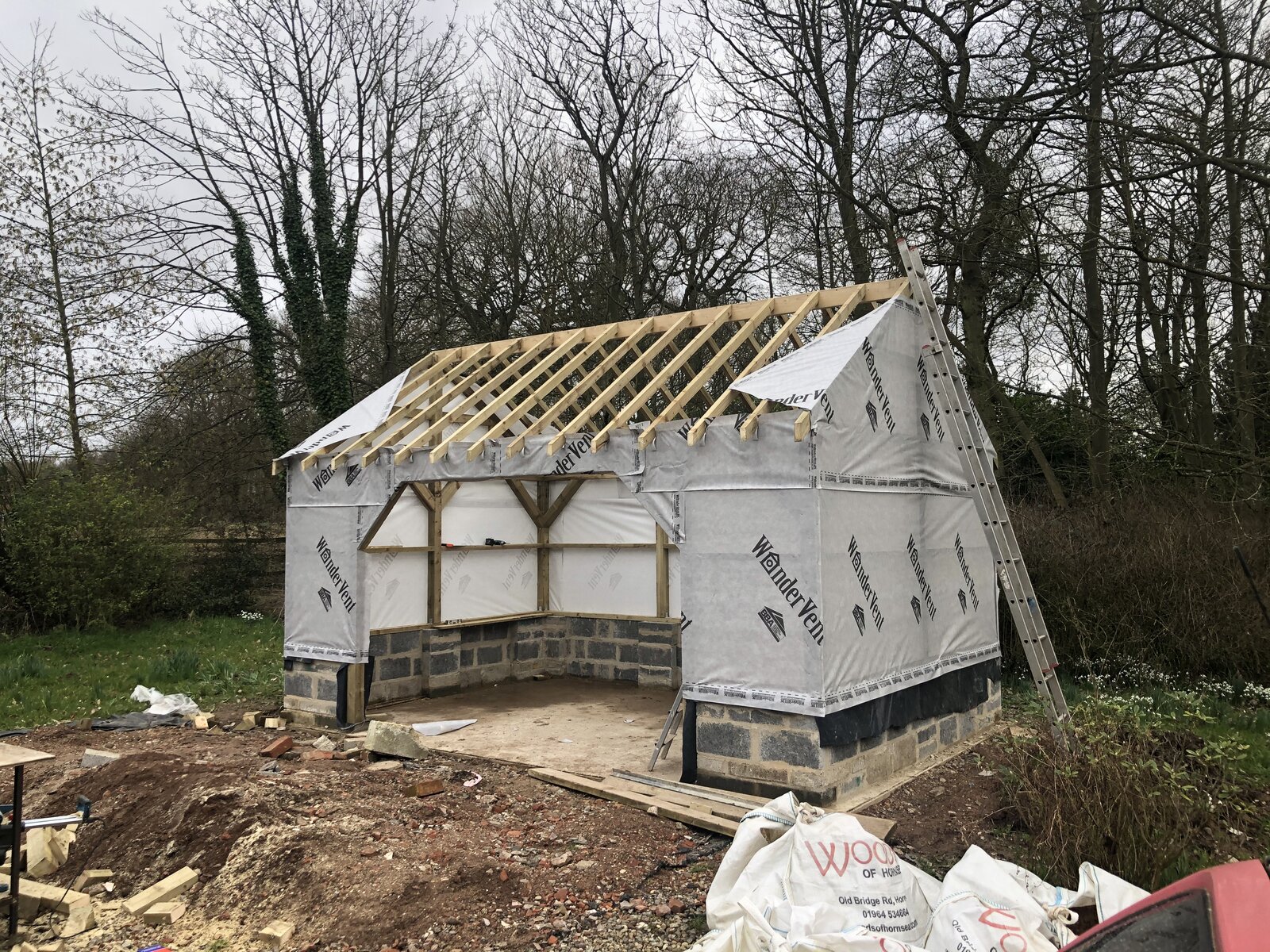

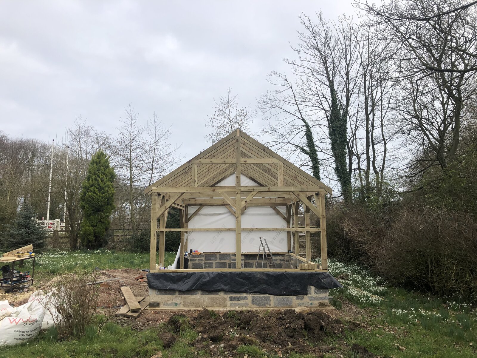

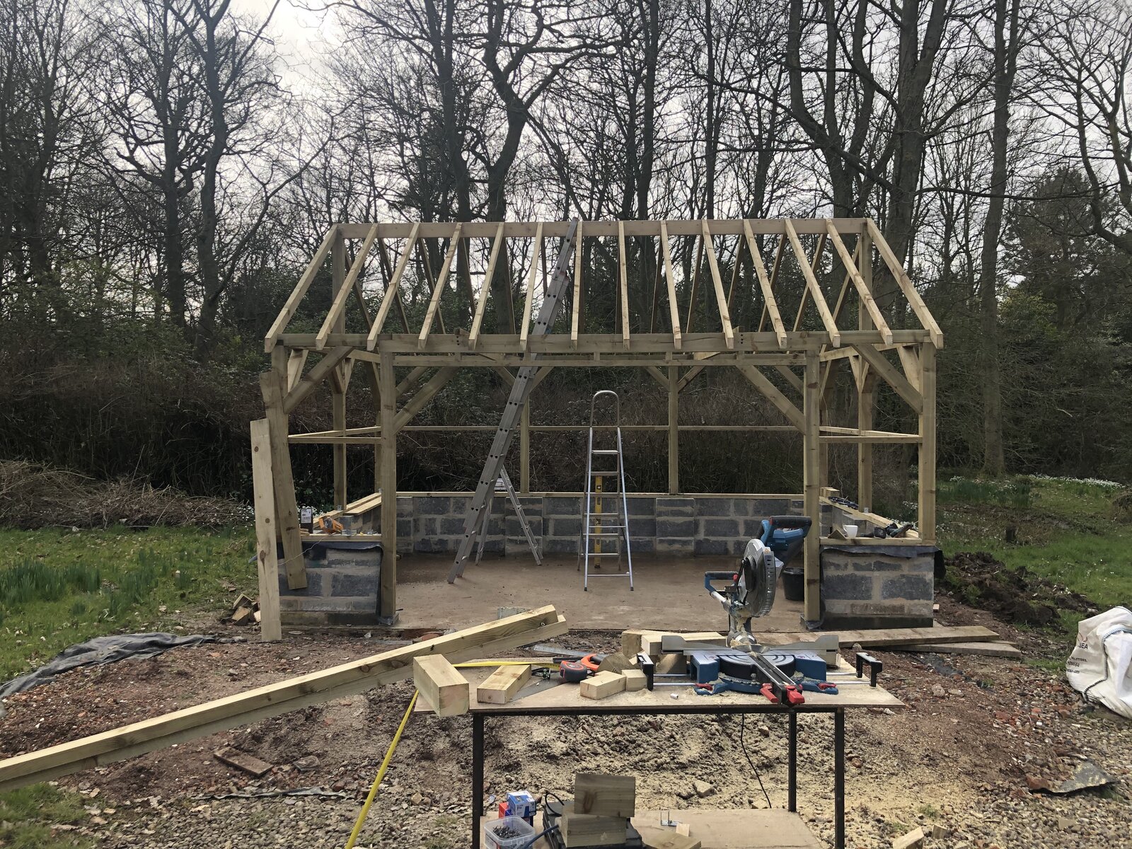

Finished bracing the frame and started wrapping in membrane. Will finish the membrane tomorrow and start cladding hopefully

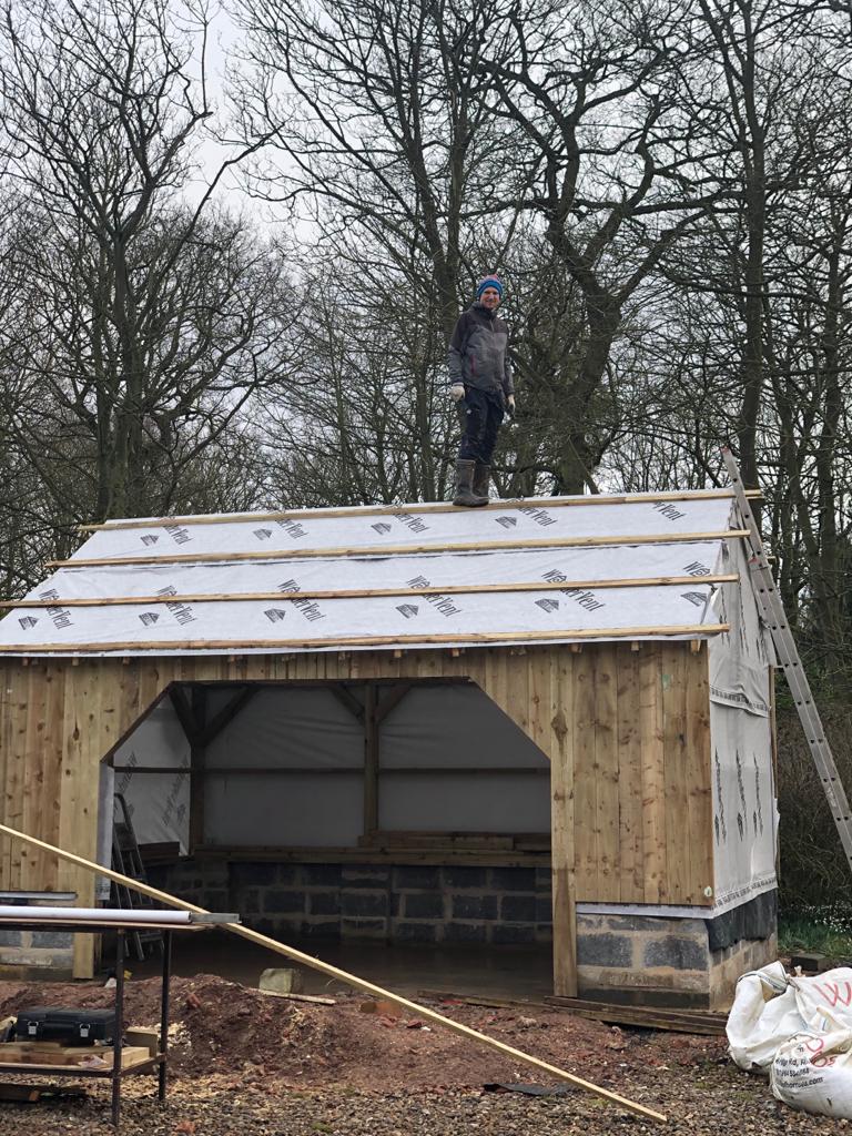

More progress made today. Could get used to this not working lark.

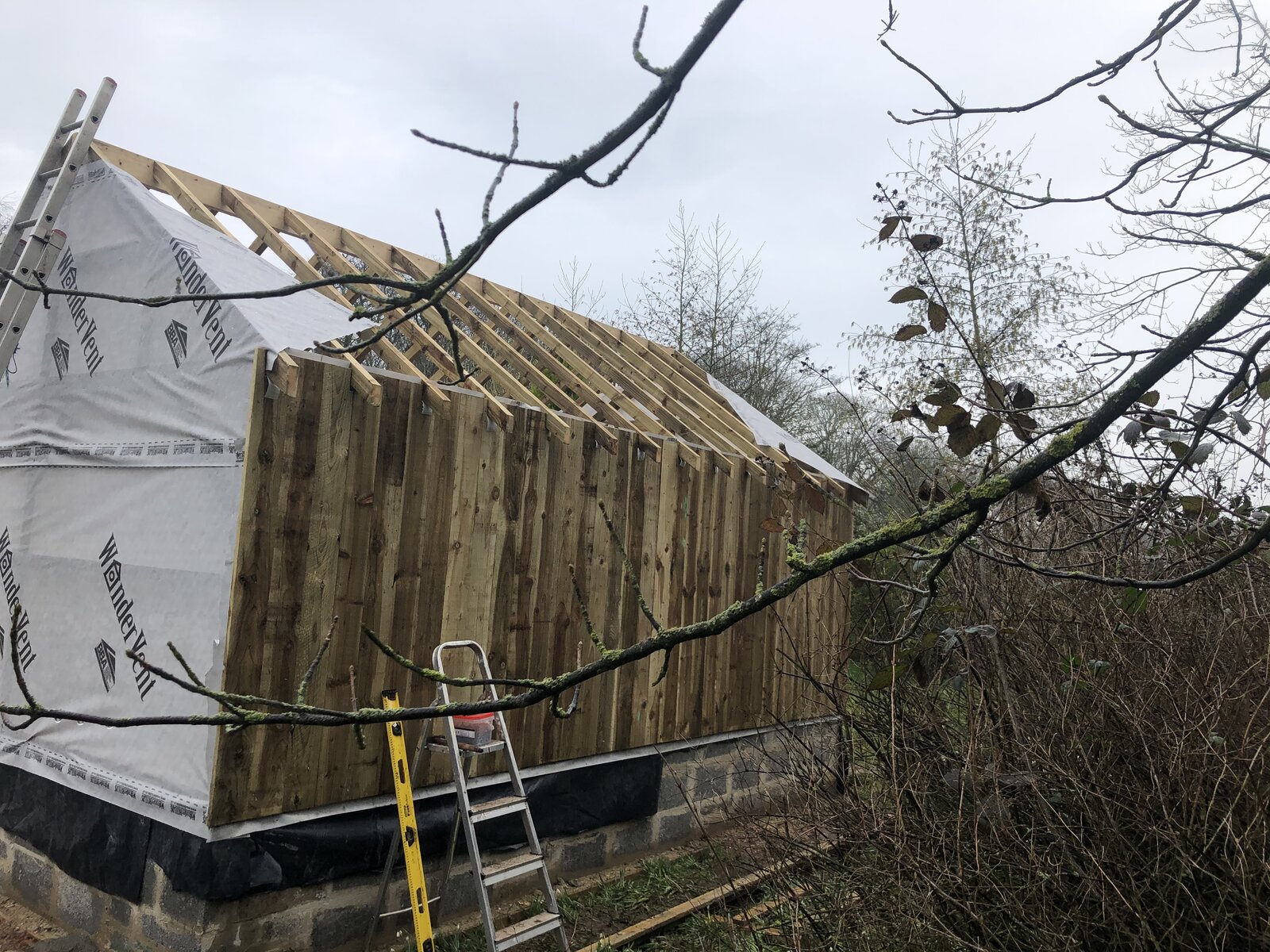

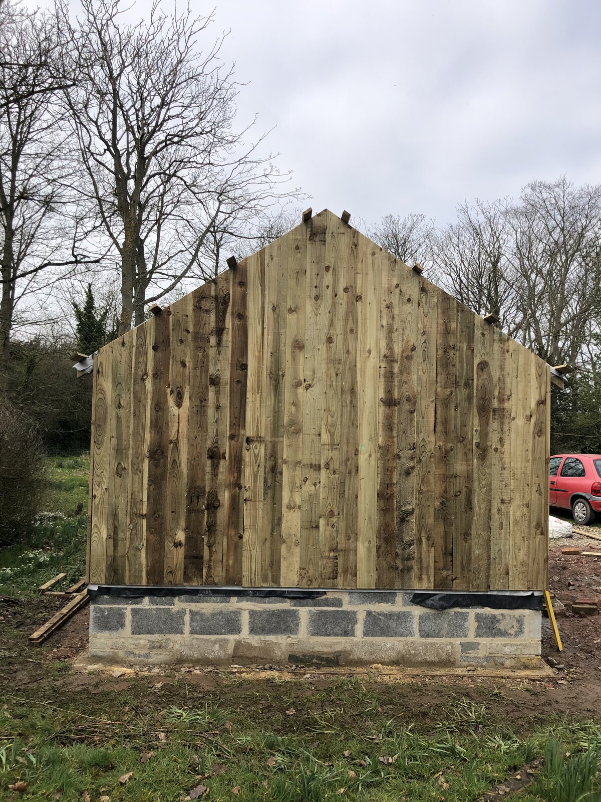

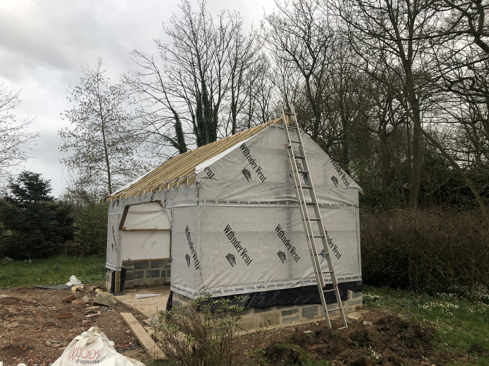

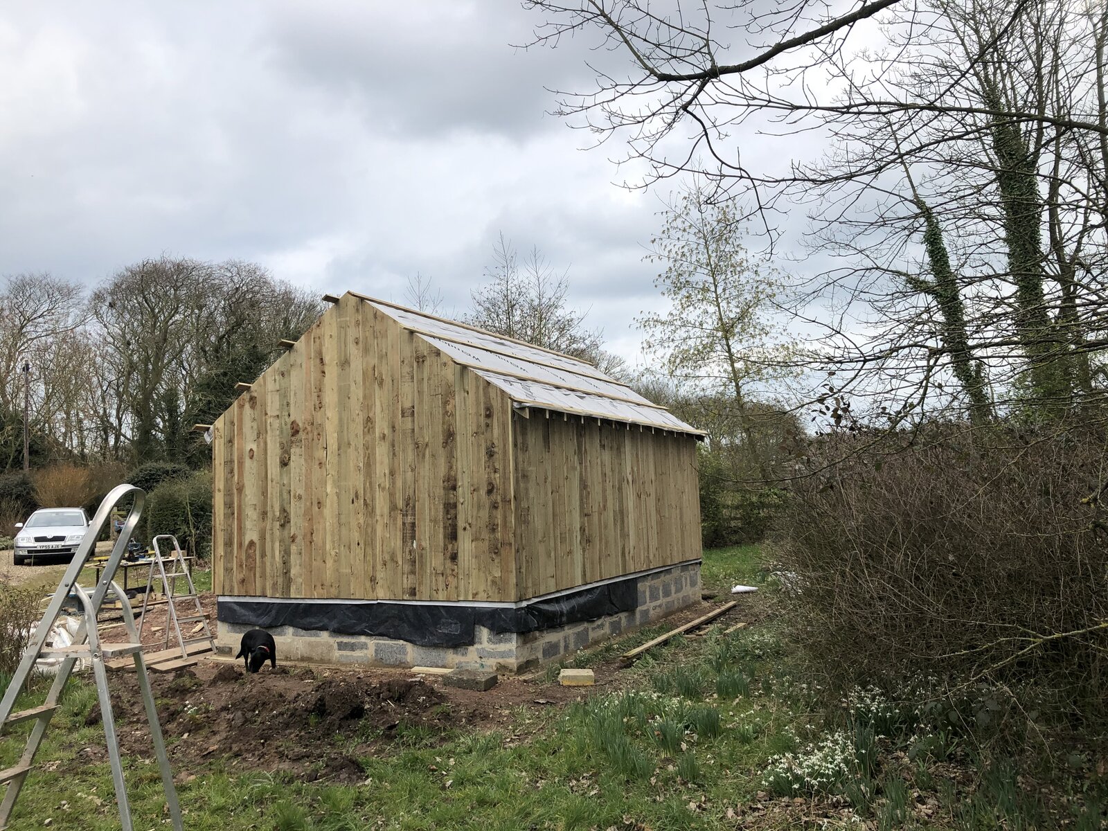

Back wall fully boarded.

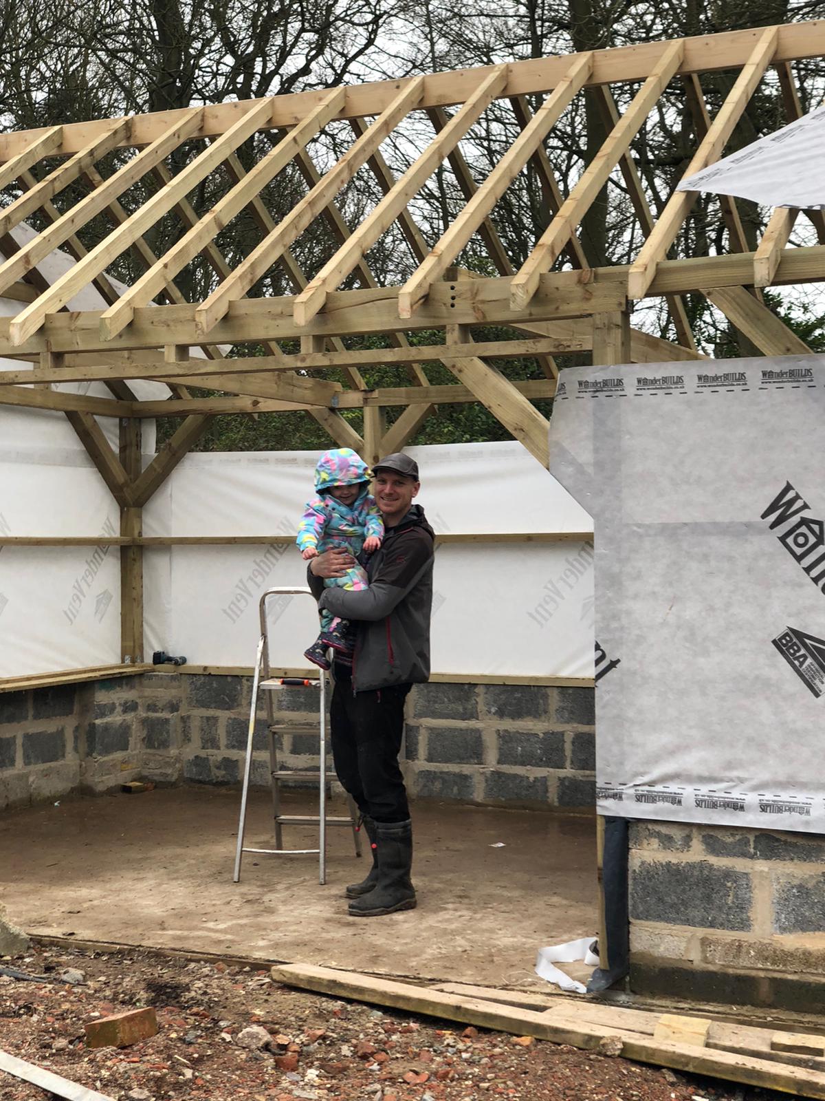

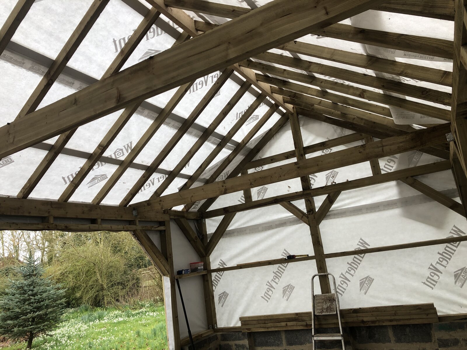

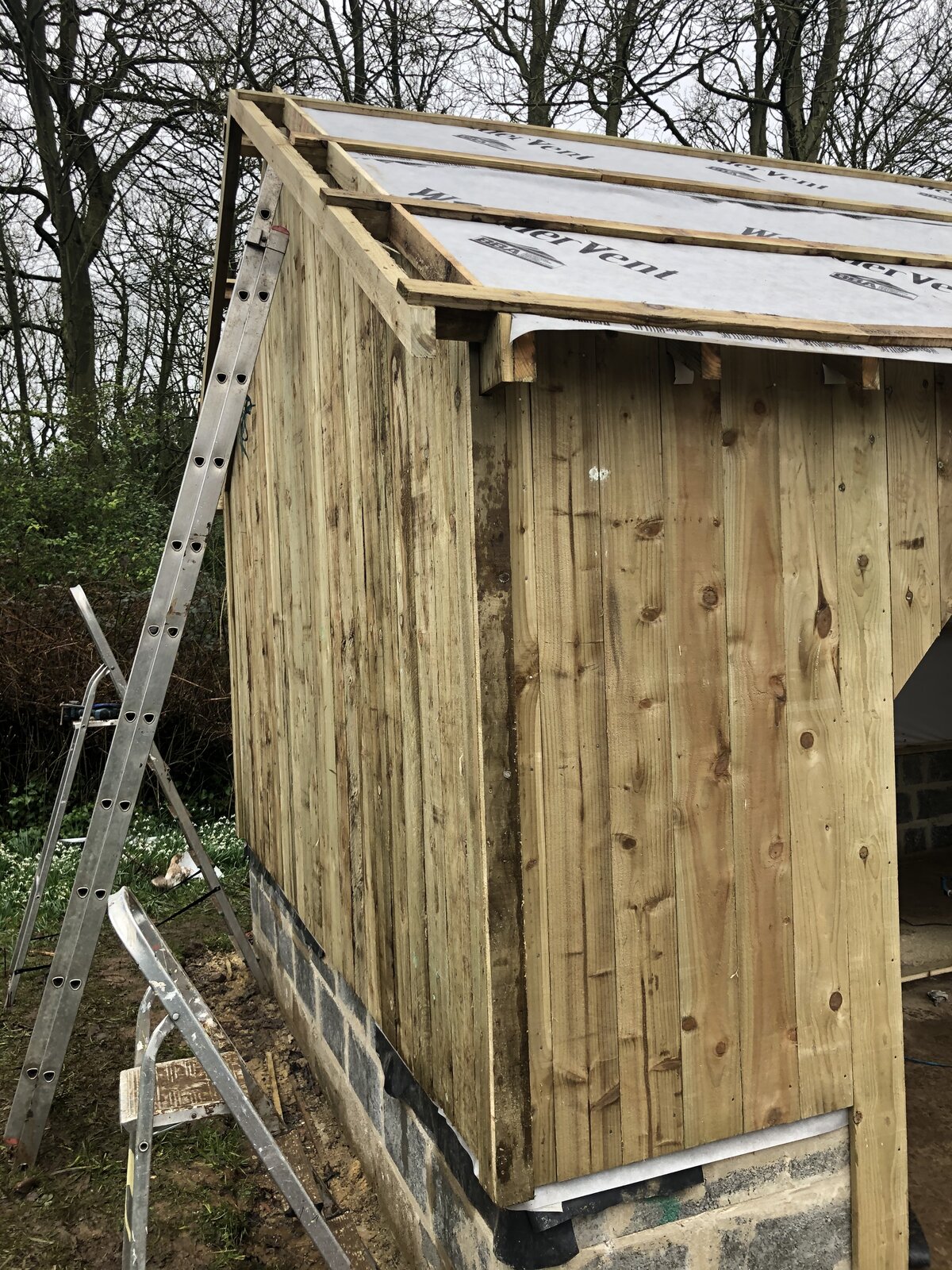

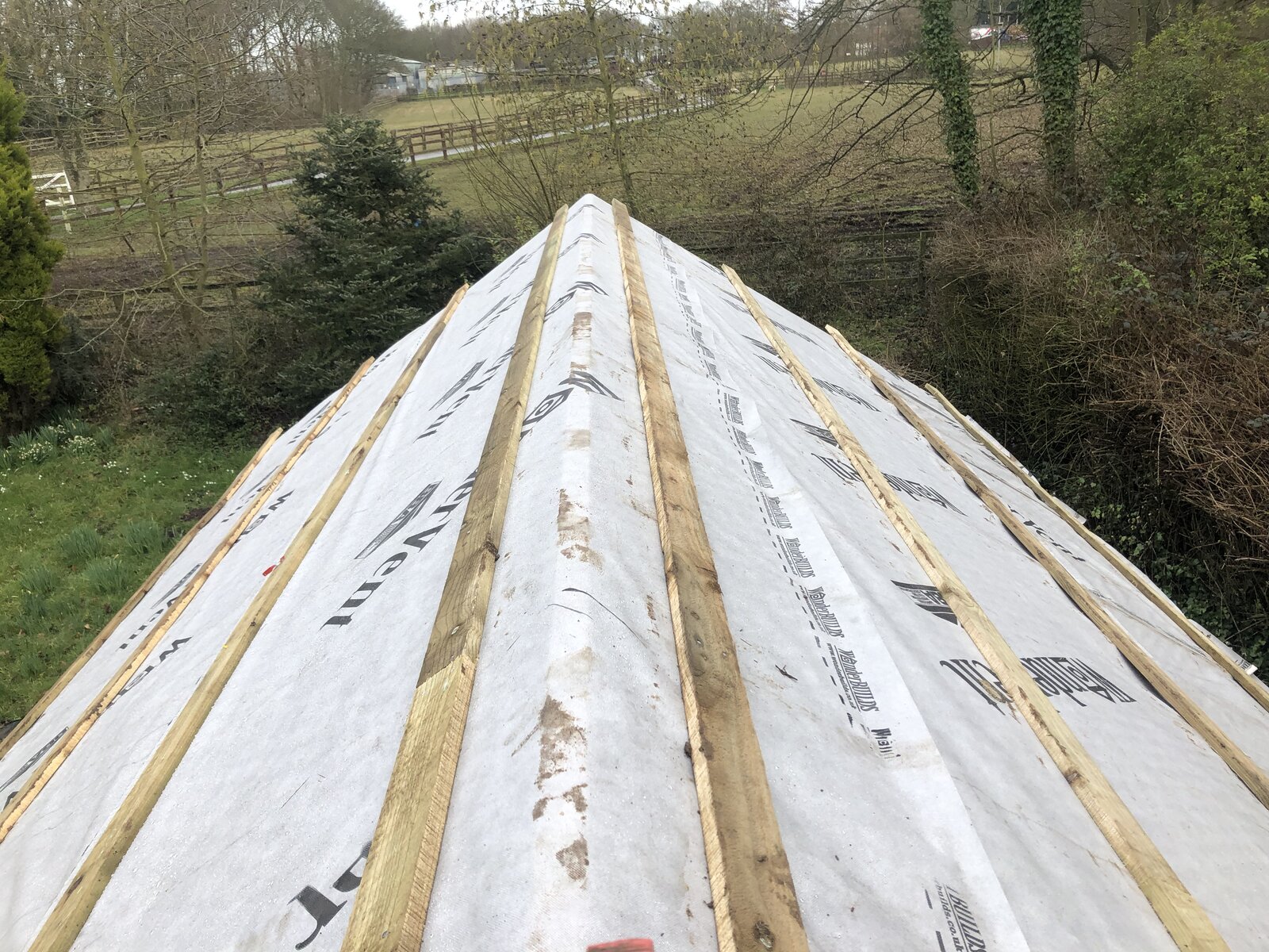

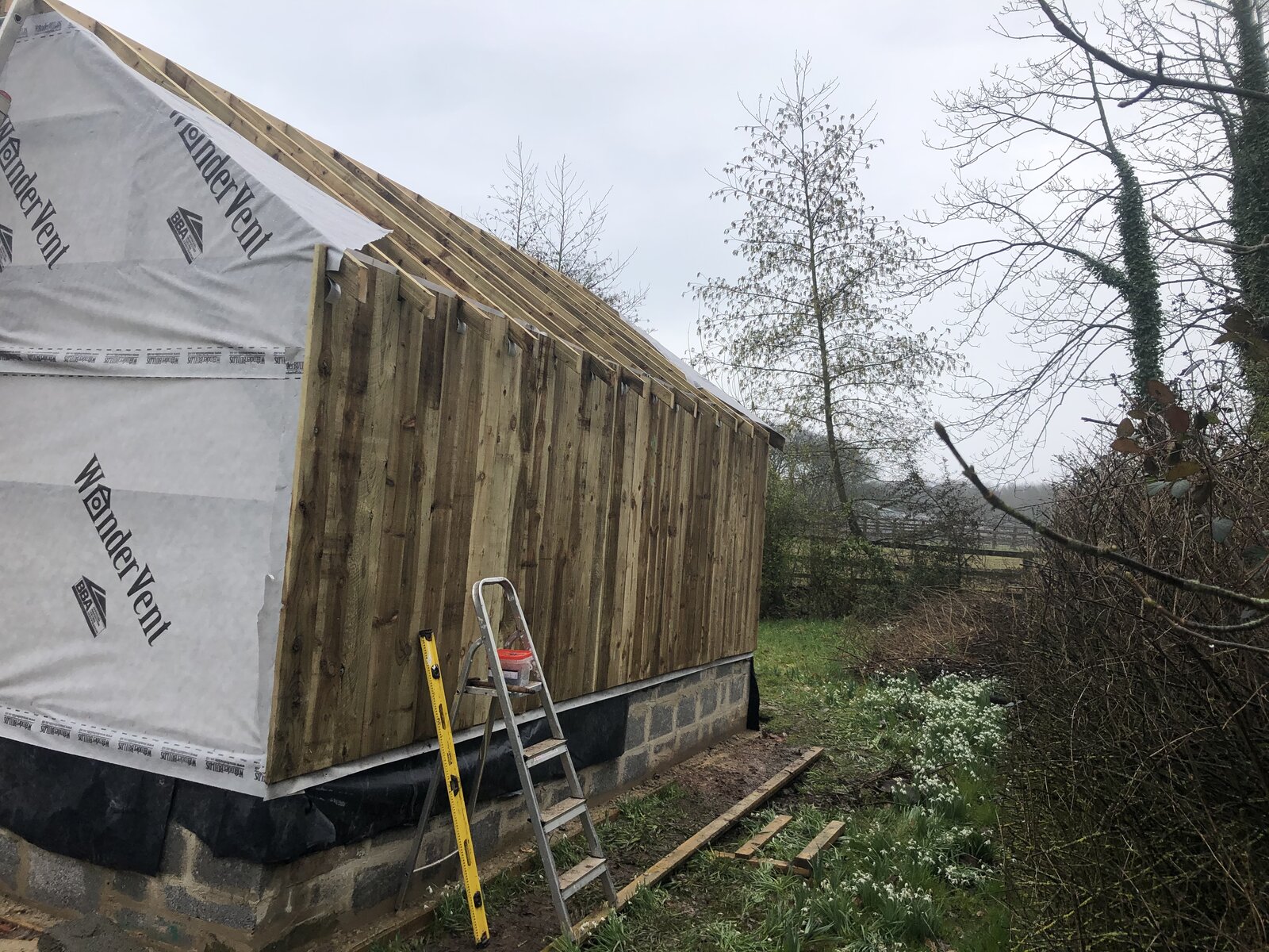

Roof membrane and battons on.
Next job is to get both end walls boarded.

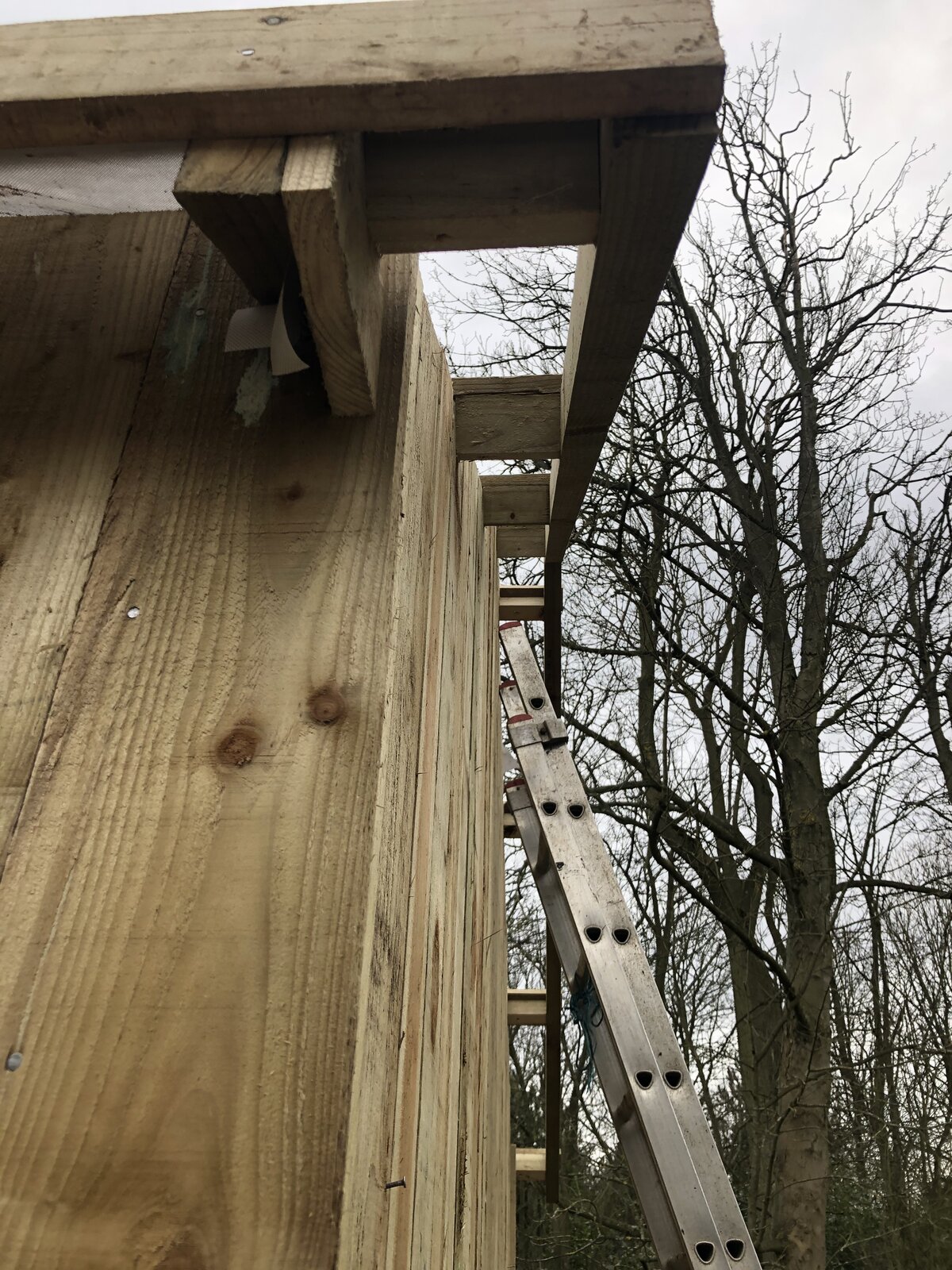

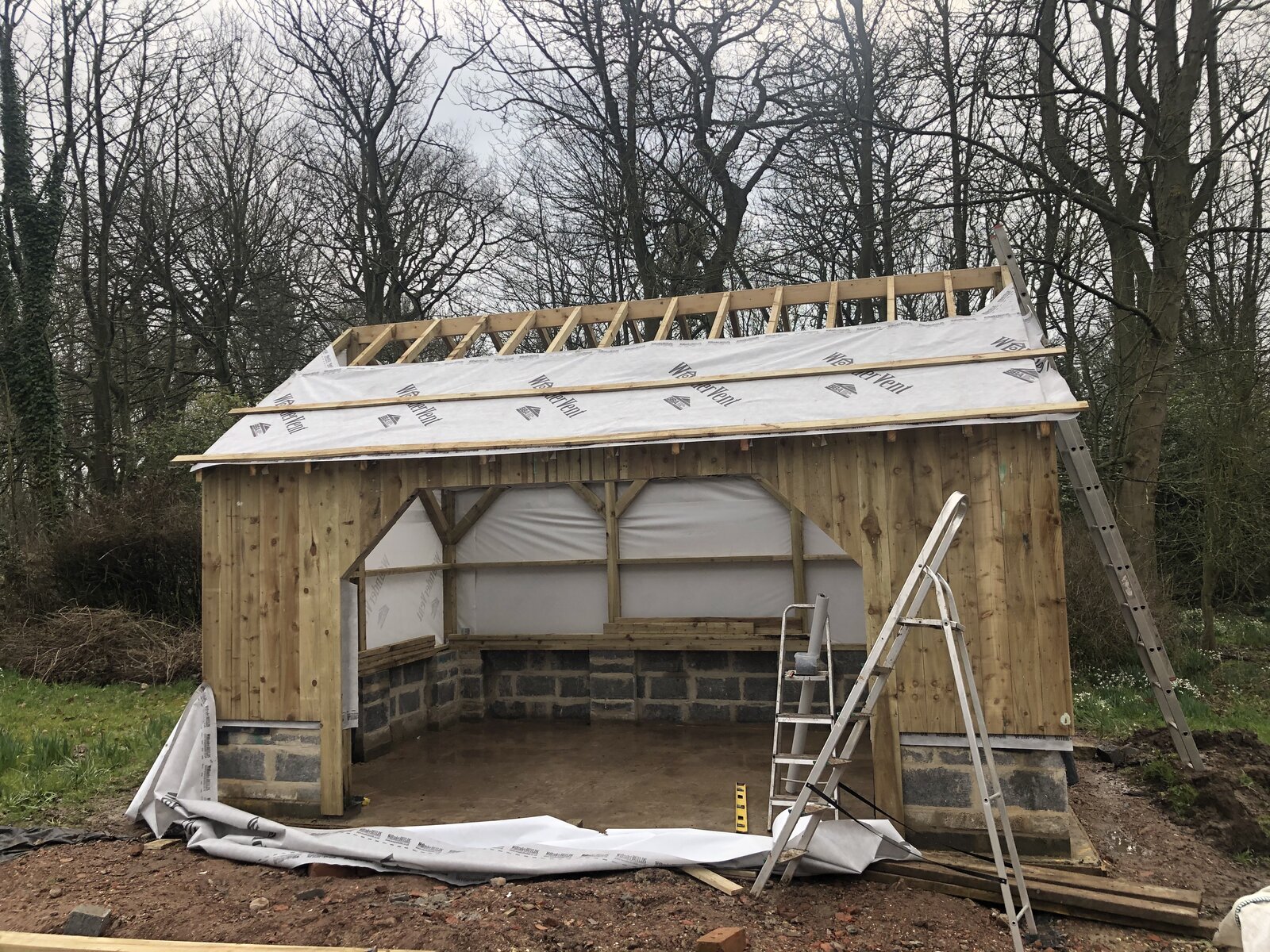

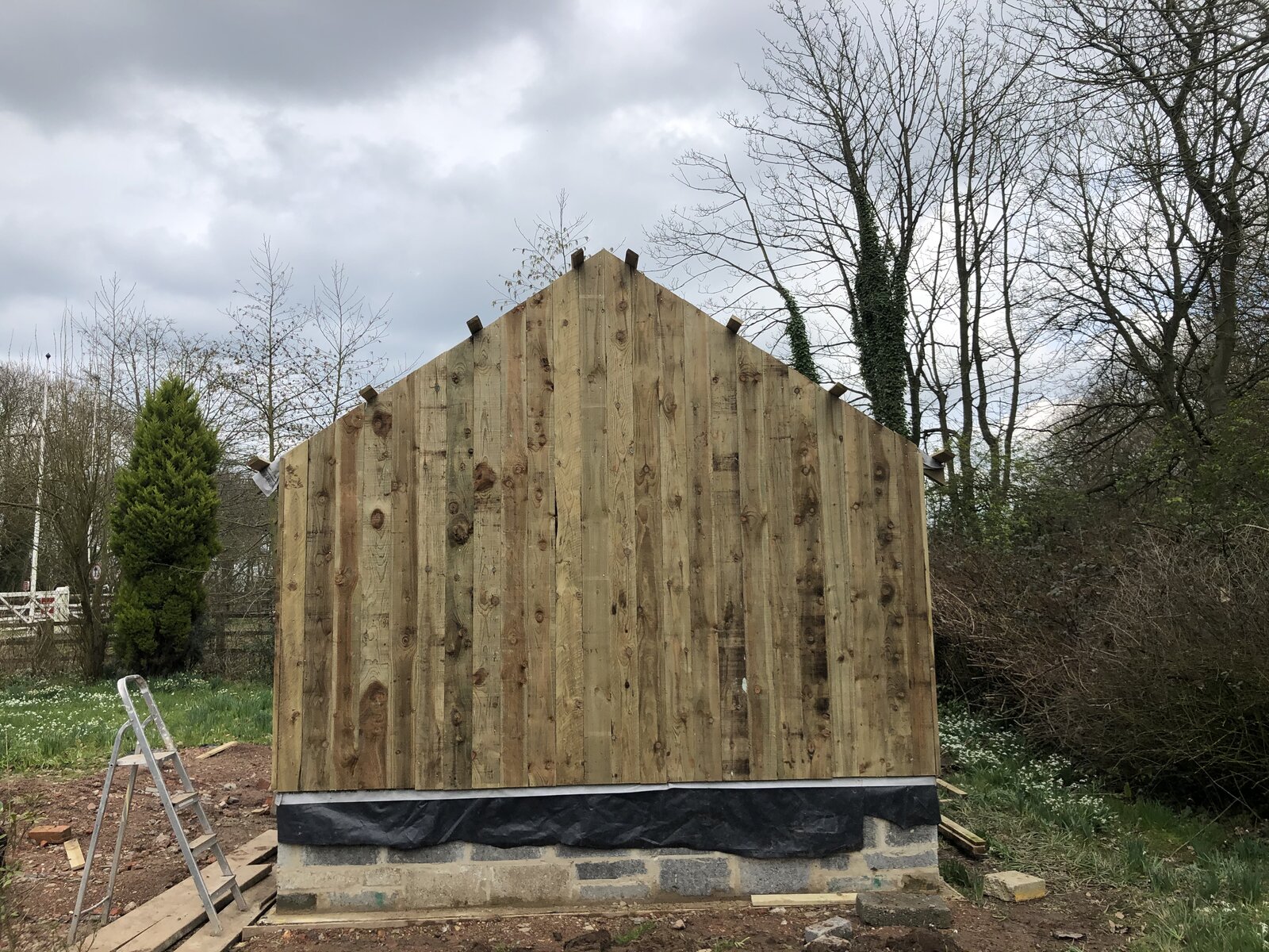

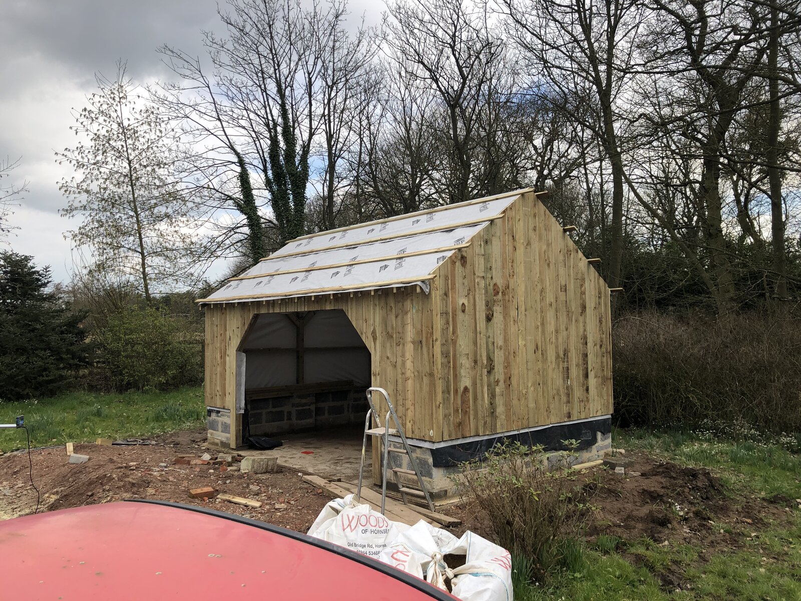

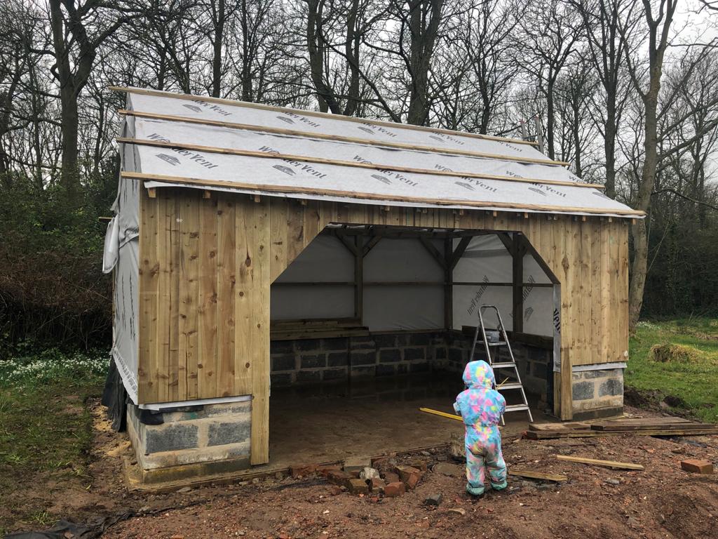

All sides boarded. Put an 8” overhand on one gable end. Will do the other end tomorrow or Thursday. Then a bit of trim work before the tin goes on the roof.

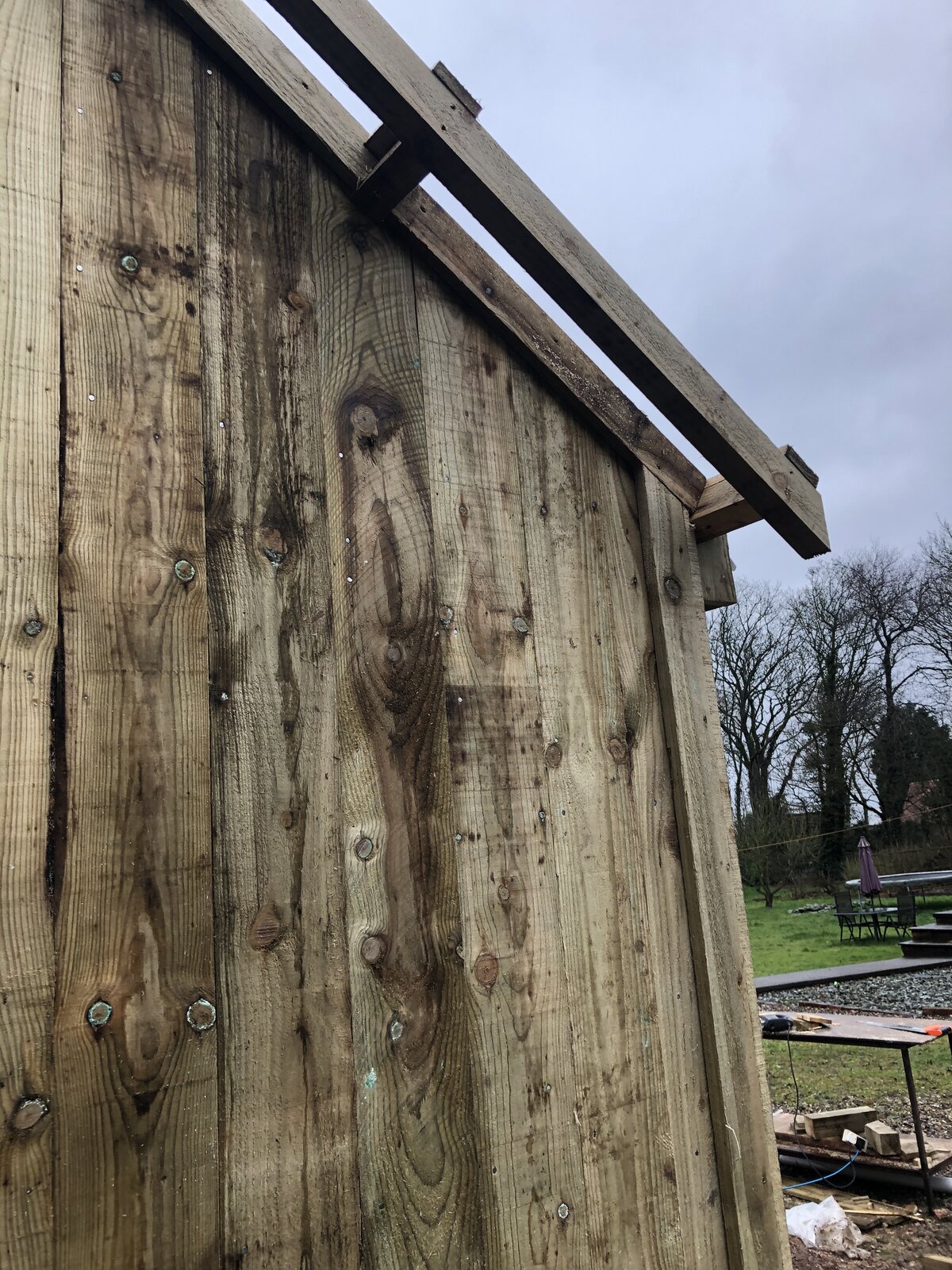

Not so great up close :LOL: but decent with limited tooling. Got my dad to thank for what skills I’ve learnt from him over the years.

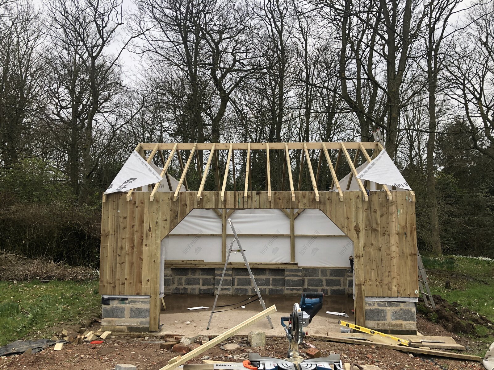

Other over hang done on the other end. You can see I have a couple rafters that are a bit low. Might have to pack the lats out so it’s not noticeable when the tin goes on.
Bit of trim work. Pretty basic but 3” late on the corners over lapping joints. Not 100% water tight but should be pretty close.
