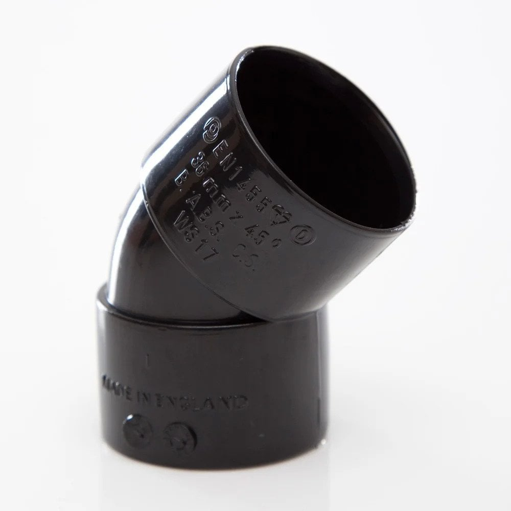

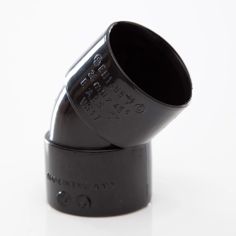

This is the 45, it's actually called a 135deg obtuse but for all intents and purposes its a 45deg bend
So 2 of them @ 32mm then a straight piece of black 32mm ABS solvent weld pipe up to the level of the trap.

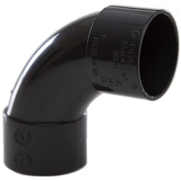

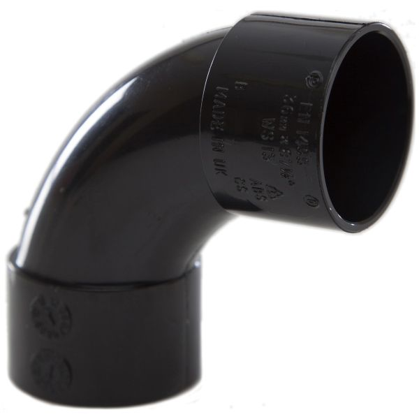

Then one of these, a 90 deg swept elbow
to bring the pipe horizontal, then another piece of 32mm pipe out to where the outflow of the trap will be

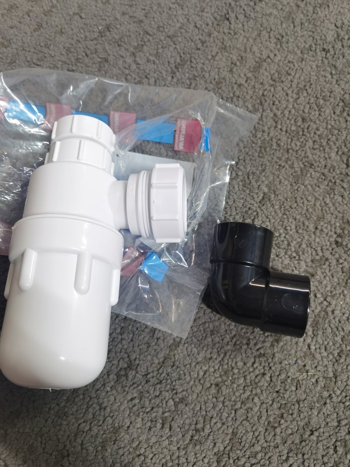

I've just thought, what would be the best way to connect to the bottle trap as its compression, and my joints are SW, would I be able to use some of the 3m black pipe and SW into the 90?
Yes, you need a section of pipe to go from the elbow to the trap. Remove the nut, O ring and conical washer, slide them onto the waste pipe ensuring correct order and orientation of the conical washer, fit the pipe snugly into the outlet of the trap, then using the nut, slide the O ring and washer to meet the leading edge of the trap outlet before tightening the nut. Hand tight is ample.

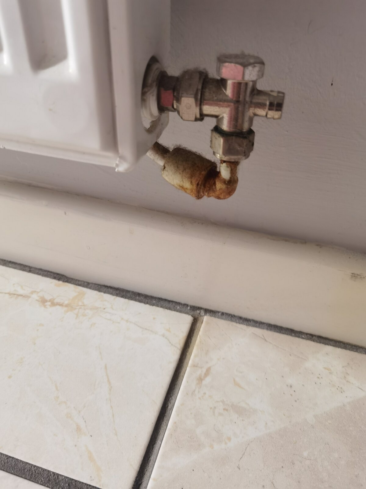

Thought I'd mention this as I've just removed the radiator cover to start getting the tiles up and it looks like it's leaked.
