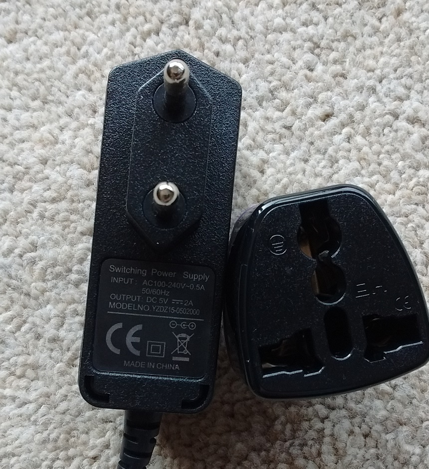

Hi. I've just bought a new media player (MECOOL M8S Pro+) which came with an adapter (see pic). I've read that it should really have a 'converter plug' which I'll get but in the meantime:
- do these adapters pose an actual danger?
- my existing media player has a 'made for UK' power pack/socket. Could I plug that into the new device (assuming it has the same V & A numbers)?
Thank you
Unfortunately, the simple answer is 'yes' - that is a diabolical object!
Possibly. In theory, if it provides 5V DC and can supply at least 2A (and has an appropriate plug on the end for your media player), it should work.

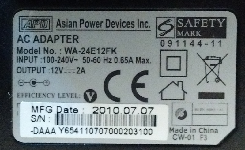

Thanks guys. I've unplugged the existing player and attached a pic of the power pack/plug's label. I think it meets with what you say above but would welcome your confirmation. Thanks again.
NO. That one has a 12V DC output, which might well kill your media player. You need one with a 5V DC output.
Kind Regards, John
