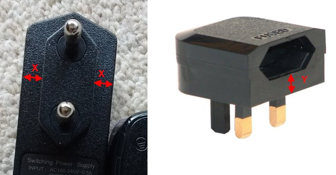

The "Euro Plug" (IEC Type C) connection of the power supply will fit the adapter.
Whether the combination of the adapter and the power supply will then fit into a BS 1363 wall socket (IEC Type G) is another question.
It may depend on how much space is available below the wall socket!
Whether the combination of the adapter and the power supply will then fit into a BS 1363 wall socket (IEC Type G) is another question ..... It may depend on how much space is available below the wall socket!
Since the device plugs into the adaptor 'sideways', it's probably at least as much how much space there is beside the socket.
Assuming there are no obstructions below or beside the socket, whether the device+adaptor will be able to fully plug into the BS1363 socket obviously depends on 'X' in the below being no greater than 'Y'. From the photos, it looks as if that's probably the case. One would hope that those who designed the PSU would have thought of that - although given the adapter they provide with it, I suppose one can't be too confident!

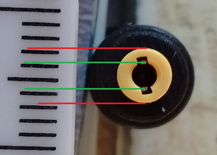

Ideally, I think I'd like a new PSU but one of the reviews of this device says “The power supply unit is a standard 5V/2A model with a proprietary connector” which suggests I wouldn't be able to buy one. By looking at this pic, can anyone tell me if that's the case? Many thanks indeed.
