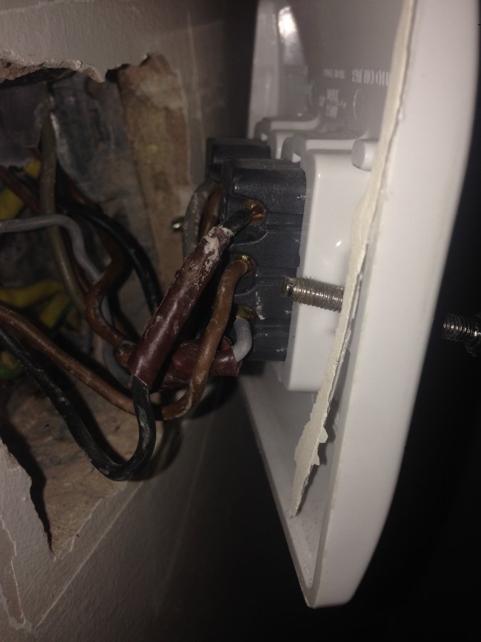

I recently had some building work done on my house and now a 2 way switch right next to where the building work was is not working. I noticed the problem an hour after the electrician left from the final fit but he claims he didn't touch it and it can't be him (there was significant rewiring but this light should not have been touched).
Now the light only works on one switch at a time so the switch positions result in:
Up Up - Light off
Up Down - Light On
Down Up - Light On
Down Down - Light On

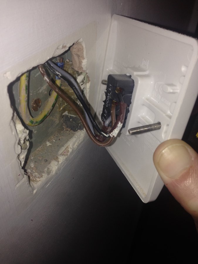

Electrician has been back and checked switch wiring which he says is fine. Says there must be a junction box somewhere inaccessible under upstairs floorboards in an area not covered by the works and it can't have been him.
Is there anyway this could happen by accident (e.g. builder drilling through a cable)??? I can only think that it must have been inadvertently rewired somehow.
Thanks in advance.
Sorry, they seem to be wired correctly.

From the logic described it is apparent that the incoming live feed has been incorrectly connected to either L1 or L2 on one of the switches, and it would be the switch that first receives the incoming live.
Incoming live should be wired to Com terminal.
Problem can be quickly fixed by swapping the wires on the switch that receives the incoming live by swapping Either L1 with Com OR L2 with Com.
As there are no Neutrals involved in a switch, swapping wires cannot result in any hazard apart from it may not work correctly.
Ok. I think -
at one of the switches the Com and one of the other wires are the wrong way round.
It's not possible to tell which from here.
It would be the same with the outgoing live so could be either switch.
Possibly, Efl, but I drew the 2 way switch schematic on a piece of paper and wired the live to one of the L1 terminals and from it you could clearly see you would get exactly the logic pattern that has been described by OP. (Sorry didn't intend to prove anyone wrong or anything just trying my bit to help)
