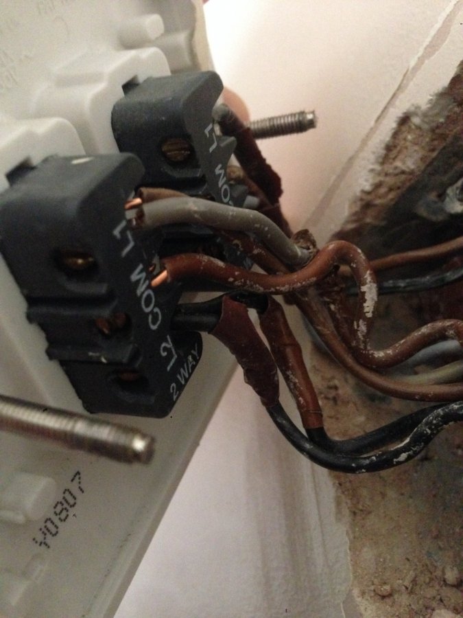

So this morning I took a switch from elsewhere in the house that is definitely working and swapped it with each problem switch one at a time. No change to behavior.
Also checked both problem switches on another single switch light fitting (both Com to L1 and Com to L2). Both worked perfectly.
My conclusion is either:
1. Wiring at junction box has changed. The rewiring involved removing a secondary fuse box and connecting more lights to main house circuit. Could have connected them to this junction box and wired it back together wrong possibly?
2. There is a nail through a wire somewhere causing it to short out one switch. Does this sound feasible?
So if that's the cause, and we assume (reasonably??) that it wasn't like it before, who changed it?
I can only think that it must have been inadvertently rewired somehow.
Nobody "inadvertently" unscrews switches and swaps wires over.
Did the building work involve any painting of the wall(s) the switch(es) are on?
I am 100% certain switches worked properly before. Used it every day for 2 years. Noticed problem (not testing, just noticed through normal use) within 2 hours of electrician leaving house.
I was thinking the junction box might have been changed to add more lights to the same circuit but I'm no electrician so don#'t know if this is likely or not.
Yes, decorators were in too on same day as electrician although it looks like they just masked around the switch as paint behind it is old colour. Other switch was in room not decorated.
Is the LHS of the ground floor switch the one operating the landing light?
Usually it is the RHS that is used.
Can we see the connections at the other set of terminals?
Yes, so it's not actually a landing but a hall way between living room and downstairs bedrooms (chalet bungalow). 2 gang switch is in the dining room next to door. LHS operates hall light (the problem light). RHS operates living room light which also has a 2 way switch. Living room light works perfectly from both switches. I will get a photo of the other side.
Here is the RHS of the 2 gang switch. This operates living room light which works fine.
