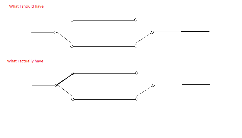

So as far as I understand it this is what I have so only one of the four switch position combinations will turn the light off because somewhere (but seemingly not at the switch) there is short between Com and L1 or L2.
In this diagram only LHS up, RHS down will break the circuit.

Last night I drew about 5 different configurations that one of them would cause similar pattern with one switch contacts being faulty i.e shorted out permanently.
Thanks, this is doing my head in too. I think the diagram I drew covers what I have. The thick black line represents the shorted switch.
The mystery is that both switches have been swapped for others and I still have the same problem so it must be shorted out somewhere else.

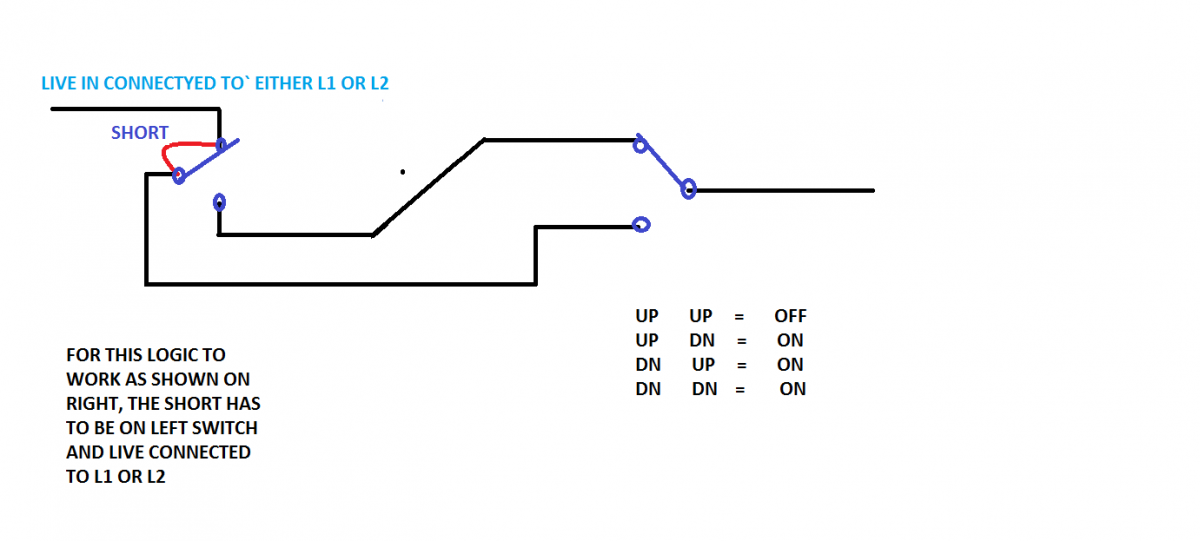

there are two conditions why this is happening,
A. One of the contacts on one of the switches is shorted out
B. Live is being fed to L1 or L2, and not common

I get option A as it is the same as I drew further up, but the switches have been replaced with others with same result.
Option B is puzzling me. Every time I draw this I get the light off in 3 out of the 4 switch combinations which is the opposite of what is happening.

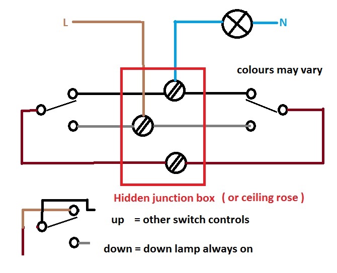

If there is a hidden junction box then this is one option for a mis wire

Bernard, found what is wrong with your ;layout, if you move your blue lamp wire to middle rail in the junction box and your Live to bottom rail then you will achieve perfect logical function Op is having and without any short circuit switches.
Now we know where we are, we can take it from here to try and resolve the issue, would be nice if you could redo a new layout and post it below. leave the other one there.(y)
Yes, that's it. Now all I need to do is convince the electrician that he must have rewired the junction box. I have just found a junction box in the roof space with at least 10 cables going into it.
