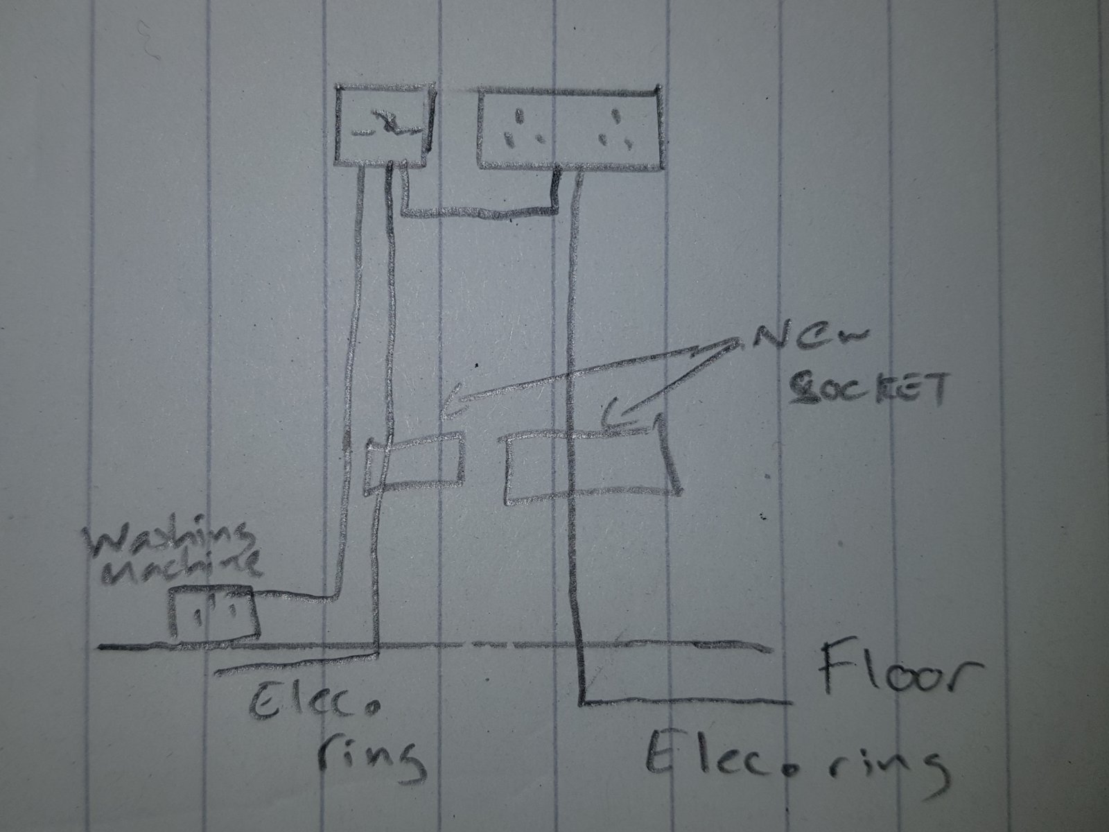

So I've drawn a diagram of how I think/hope it's wired .

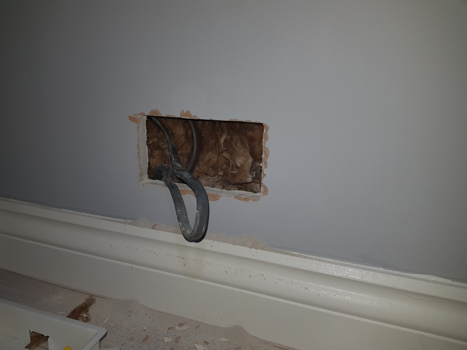

I'm going to cut the hole for the socket half way between the switches in the kitchen on opposite wall at the bottom. Hopefully I will find the ring circuit and enough free cable to fit a new socket.
If it doesn't work out at all I can always blank it off and get a pro to try fit it later.

The socket for the light could be spurred off the existing double socket next to the (unnecessary FCU).
It could.
But he might want it lower down, and if there are noggins in the way then going through the wall at a lower level could be a lot easier.
There is no requirement for the FCU, there no requirement for isolation for the WM other than its existing plug and socket. Isolation is only required for service when the WM has to pulled out anyway.

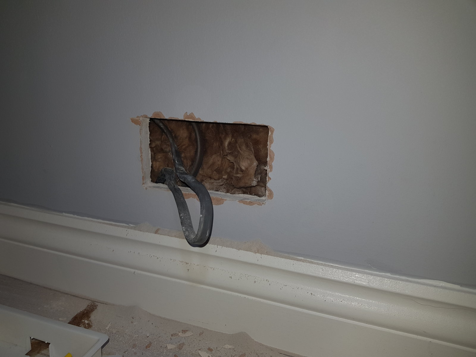

Excellent work!:Dalways a relief when you take a chance and everything goes well!
I couldn't find it at first was ready to install the blank lol. But eventually found it to the left of the hole I had cut and plenty cable to play with.
Just a wee tidy up round the edges and the OH with be happy.
Cheers for all the advice.
How did you confirm it was actually part of the ring, rather than part of a spur?
did you use a padsaw, i find that happens, i think the teeth are to course, maybe they make a finer one
