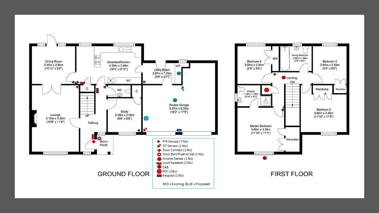

I'm planning how I'm going to extend the system and would like so feed back and/or pointers on how to configure the full and part sets.
See below diagram with red existing infrastructure and blue planned new stuff. the only thing I haven't put on there are new reed contacts on the rear and garage doors as I'm not convinced they are necessary.
So Full set - fairly obvious... everything active. Not bothered about entry and exit specific routes, would just like the system to kick in and give you so long to disarm when any sensor is triggered. and in reverse when setting. Presumably that means F/Door contact needs to be 'intruder' function? What are the general settings required?
Night set - I'd like all the sensors in the garage/utility and the F/Door contact to be active and trigger an alarm. What are the general settings required?
Part set (if possible to have part and night sets) - I'd like all the sensors in the garage/utility active and trigger an alarm. What are the general settings required?
Smoke - obviously these to be active all the time - is there any specific setup for these or does giving them the 'fire' function configure them?
Door Bell/Push to Set - Don't need this for the alarm. Is it possible to set this up to activate a trigger? (to ring a nice bell rather than the chime which is bloody awful lol) You mentioned a benign setting for this GalaxyGuy - which 'function' is this?
Future plans will be to get selfmon sorted for notifications!
Thanks in advance folks!
