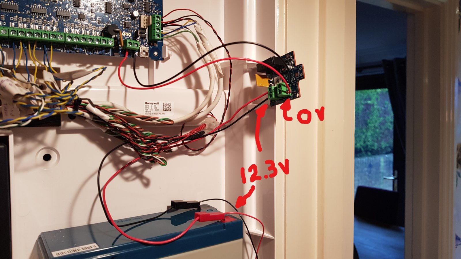

OK... so when I pull the power the lot seems to die... the LED on the panel stops flashing. Voltage at the battery drops from 13.6v to 12.3v.

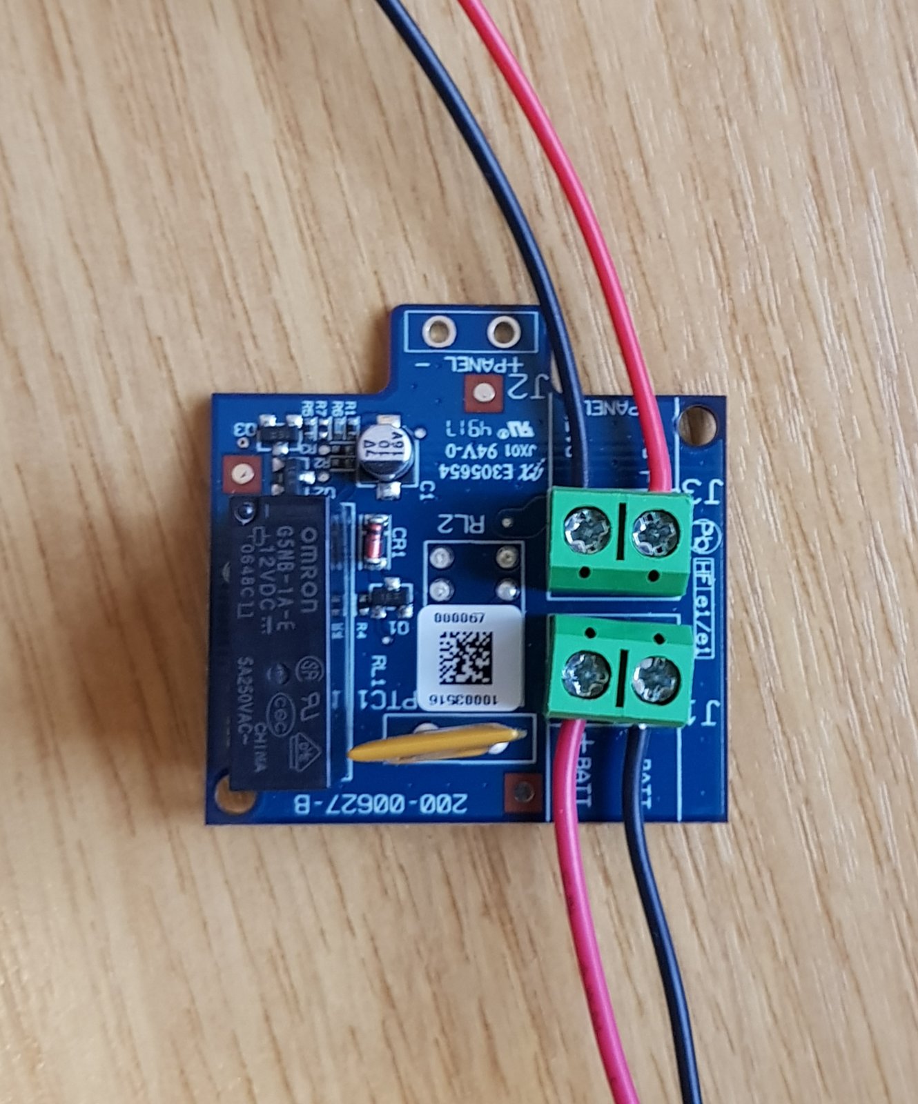

Bit more detail...
Although there is 12v at the battery there is no power coming out of this little board on the right...
So I've bypassed that little PCB and it did then let me out of the engineer's menu successfully.
However, continuing to configure the zone names and spares and also add the ethernet module I've got the problem back!?
When trying to exit engineer's mode I get "ROI 100 Batt Test Fail". When aborting out of the exit I get the error "0001 +CU-BATT".
I'm getting 13.6v ish at the battery terminals on the board, when I cut the mains the battery drops to 10v. Is this pointing to the battery or have I a duff panel?
