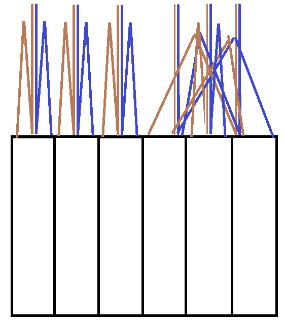

EICR just 2 faults:
'Lighting circuit incorrect RCBO rating, incorrectly labelled - C1'
'Cooker circuit incorrect RCBO rating, incorrectly labelled - C3'
Being the pratt I am I didn't take my phone so no pictures but only went see what make was required.
CU: 6 way all RCBO, beautifully labelled with Dymo.
Tenant demonstrated that 3 rings on the hob trips the 6A RCBO labelled 'Lights', he says it's only been happening since the inspection on 5th Nov.
I flicked the 32A RCBO labelled 'Oven' off and the lights above went off.
Inside it was beautifully wired except the 2 circuits in question look to be crossed over (the shower RCBO is in between them and the brown/blues have obviousely been disturbed and crossover the shower cable), as soon as I restored them to the correct RCBOs and redressed they looked just like the rest, all neat and regimented. I did IR. Loop and RCD tests which were close enough to the EICR.
The estimate attatched to the EICR is for £182 plus VAT to replace the wrong RCBOs...
Would "only" be a C2 at-least according to the "electricial safety first" guidance.
Well that was my first thought but then I wondered about 32A OCPD on 1mm²? IIRC 1mm² fuse wire is ~40A.
Hmm a bit of an innocent careless mix up or a devious money making scam ???
I forgot to mention the tenant tried to give me a bluey tip for sorting it quickly as he knew I was attending to survey, not repair and he'd been chasing it for 2 weeks.
Im sure it was innocent as it looked OK - a bit like this :ROFLMAO: :
EDIT: I make no apologies for my poor cad work :(
