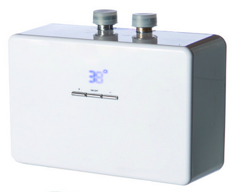

Was looking at a problem getting enough DHW to a sink, and it seems one of these has been fitted, 1772380874767.pngI was looking at the picture to see where powered, as it seems a lot of work to bring in a 4.4 or 6 kW supply, but I am hoping the bare wire is not what I think it is? I would have expected to find a mineral insulated nickel chrome heating elements not bare wires. Has this really got Approvals CE, UKCA, WRAS?
I don't think there's any shock risk if earthing and disconnection are in order same as any appliance
Seems any risk of tripping depends on the IR conditions present with the water ?

Remember Dolphin showers?
Loads still in use! Don't forget electrode boilers either, often 3 phase!
A factory I used to work in used electrode boilers to generate steam to condition leather, every so often they would trip the RCDs, a few spoons of salt used to cure them
I would have expected them to taint the water, but I don't drink the water from my shower.
Probably not great to drink from it. You can buy kettles that heat water with mains into 2 stainless steel strips. I did it with mains and 2 tea spoons a few years ago, I probably drank it at the time but don't remember any specific taste. I wonder if that's why I'm going bald...
