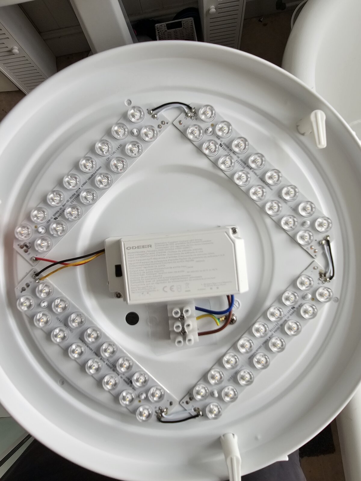

I have bought a bathroom light from Costco. As per photo it shows 3 wires to connect to.

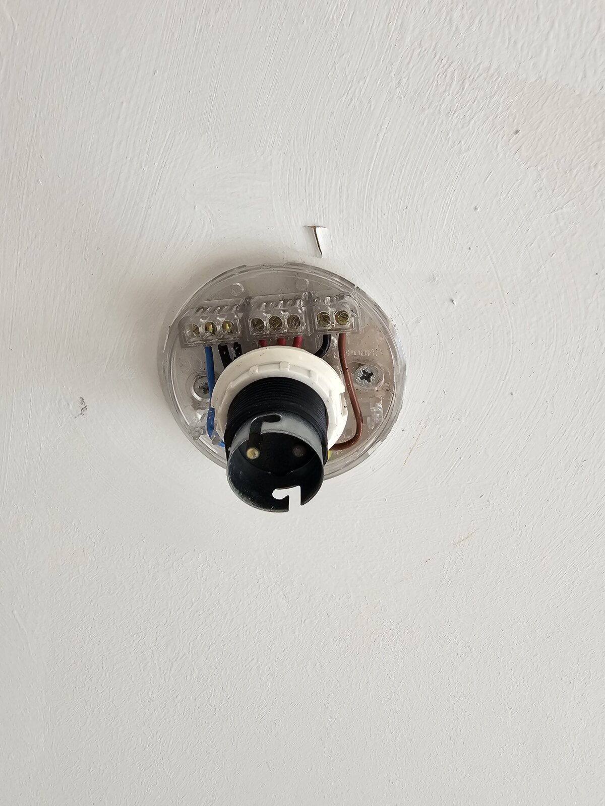

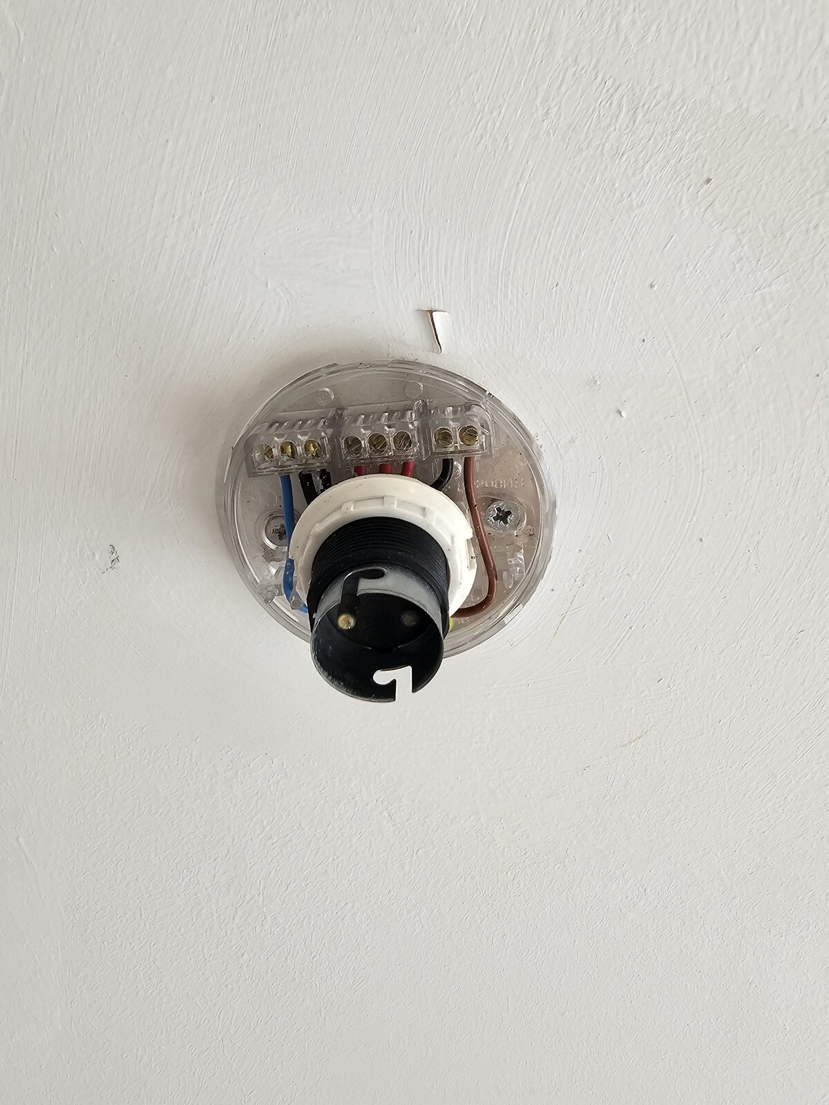

I have opened up the light fitting that's on the bathroom ceiling now, and I am presented with lots of wires, as per photo: 3 red, 3 black, 1 blue and 1 brown and an earth behind.
Is it possible to use the new light I bought or is it a no go.

Yes its possible
Make the small hole a bit bigger, 20mm cutter maybe
Put the 2 blacks to neutral
Put the single black to live (mark this wire red or brown don't lose it or you'll be in a bit of bother)
Put the 3 reds in a separate connector block (not connected to the light)
And put the earths to earth.
Assuming the cover will fit with the connections etc inside the fitting.
And make sure the power is OFF before doing anything.
The three reds in the middle will go in their own terminal block.
The two blacks on the left (N) will connect to the blue wire on the new light.
The black on the right will connect to the brown wire on the new light.
I think I do see an earth wire, that will connect to the earth terminal on the new light. If the original wiring has no earth wire then you can't use that light.
And the light should be IP rated.
EDIT: Too late Pete beat me to.
Nothing wrong with two slightly different explanations :-)

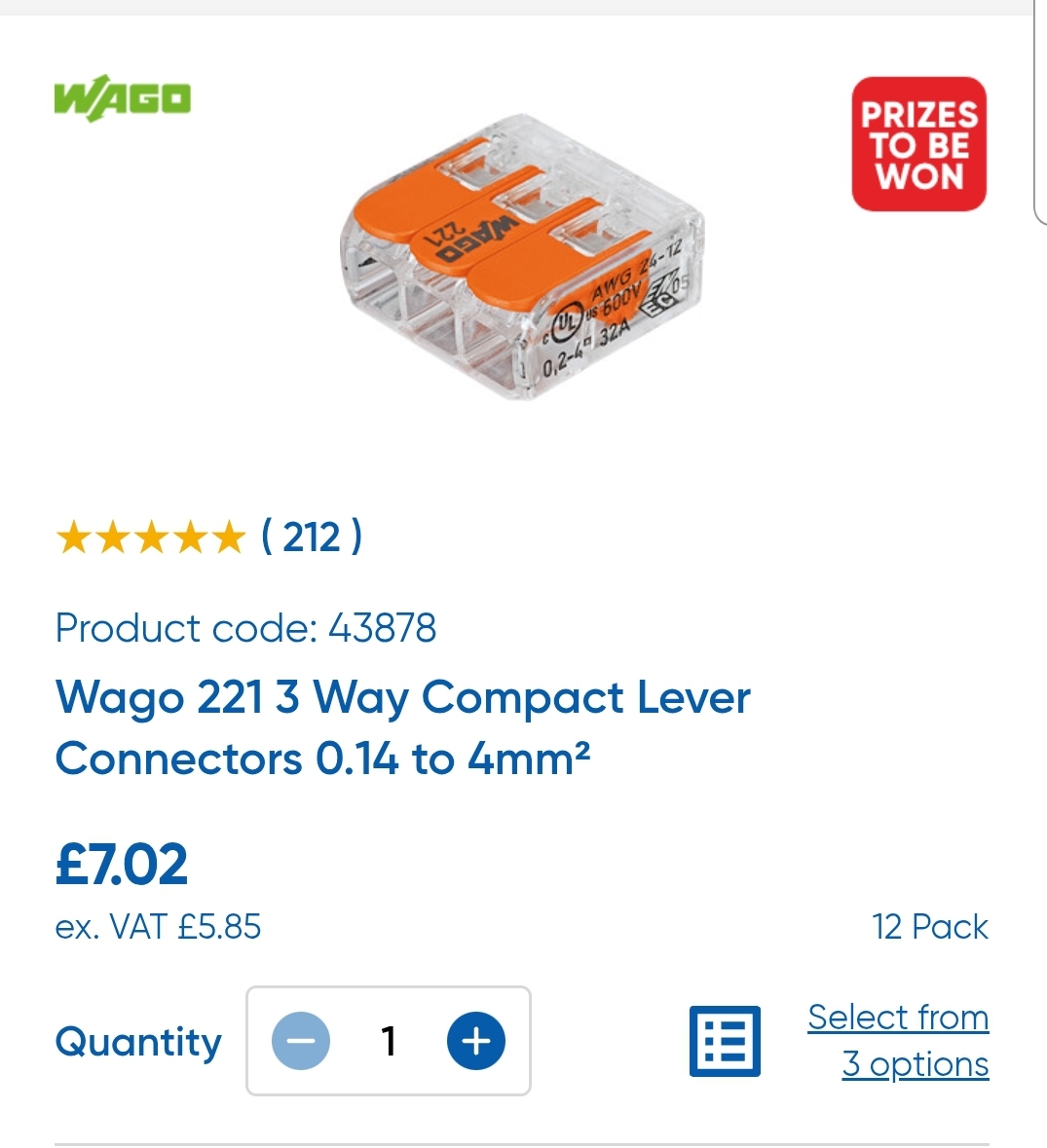

And just to note to the OP, when choosing a connector block to join the loop wires it should be rated correctly, I've seen some toasty burnt terminal blocks.

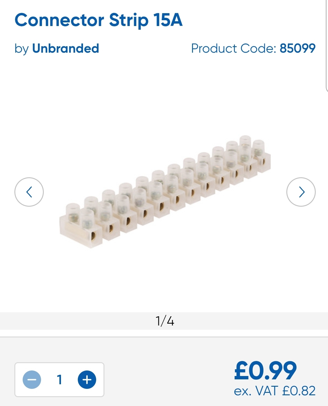

Can you please tell me which block I need. Is it the big chunky connecting block. If so I have these.

When you say one connector block, do you mean one single connecting block from the strip ie all three wires go in one hole and are screwed down. Also should I wrap red insulation tape around the block?
I have bought the connecting blocks you have suggested. I will be putting up the light this week.
