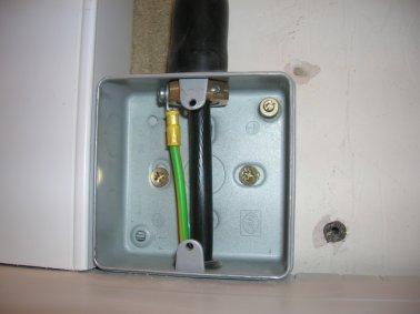

For what it's worth, I use a galv through box, affixing the SWA to it having ensured the tails are long enough to pass right through to the CU terminals. Then I use a bit of 4mm² GY to connect between the box and the earth terminal.

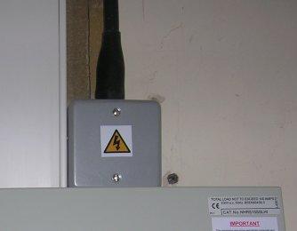

Last job I had to terminate a SWA into a domestic CU I used a single gang MK metclad surface box with a blank plate. Owner was quite specific that they didn't want anything too industrial looking so a shiney metclad seemed the way to go.....
