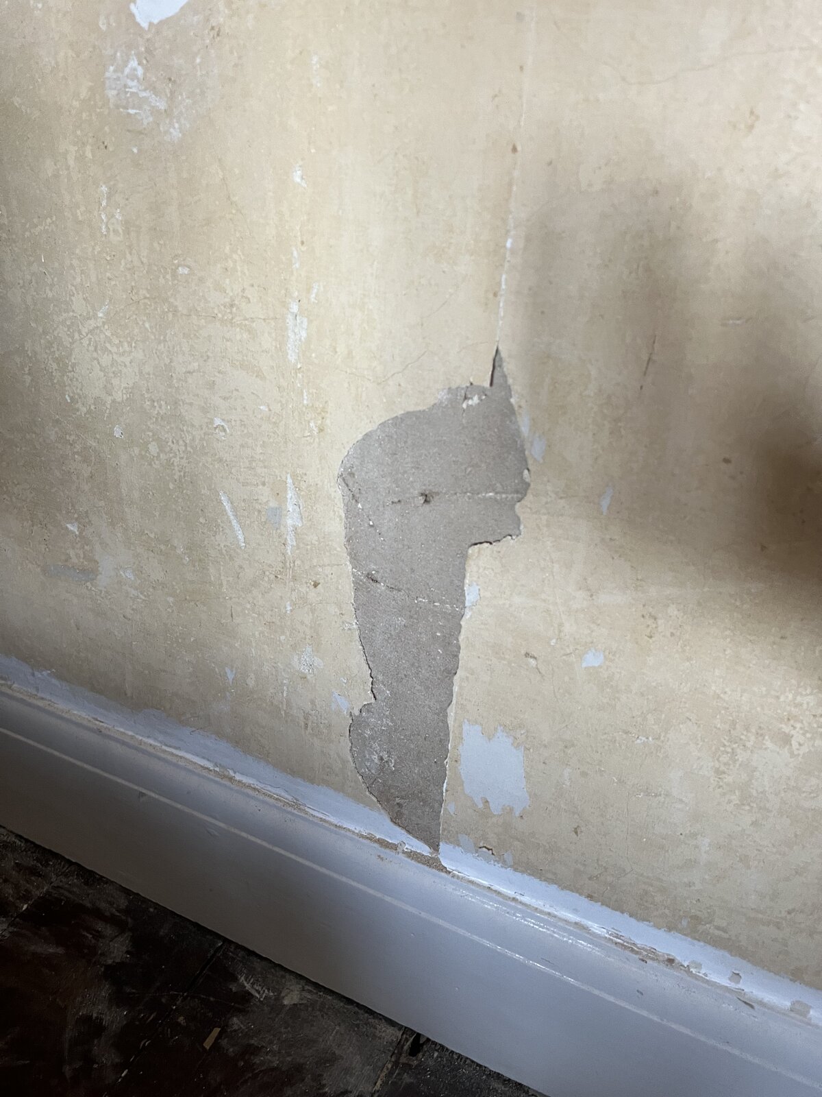

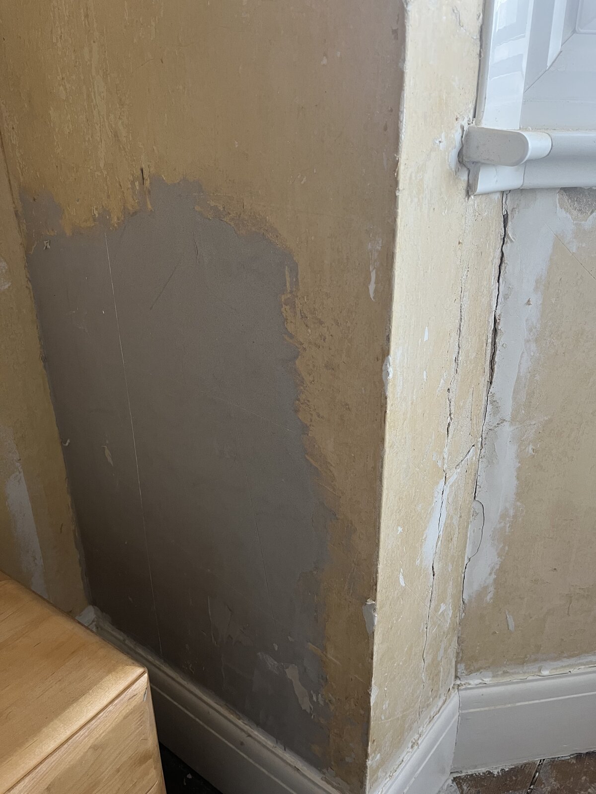

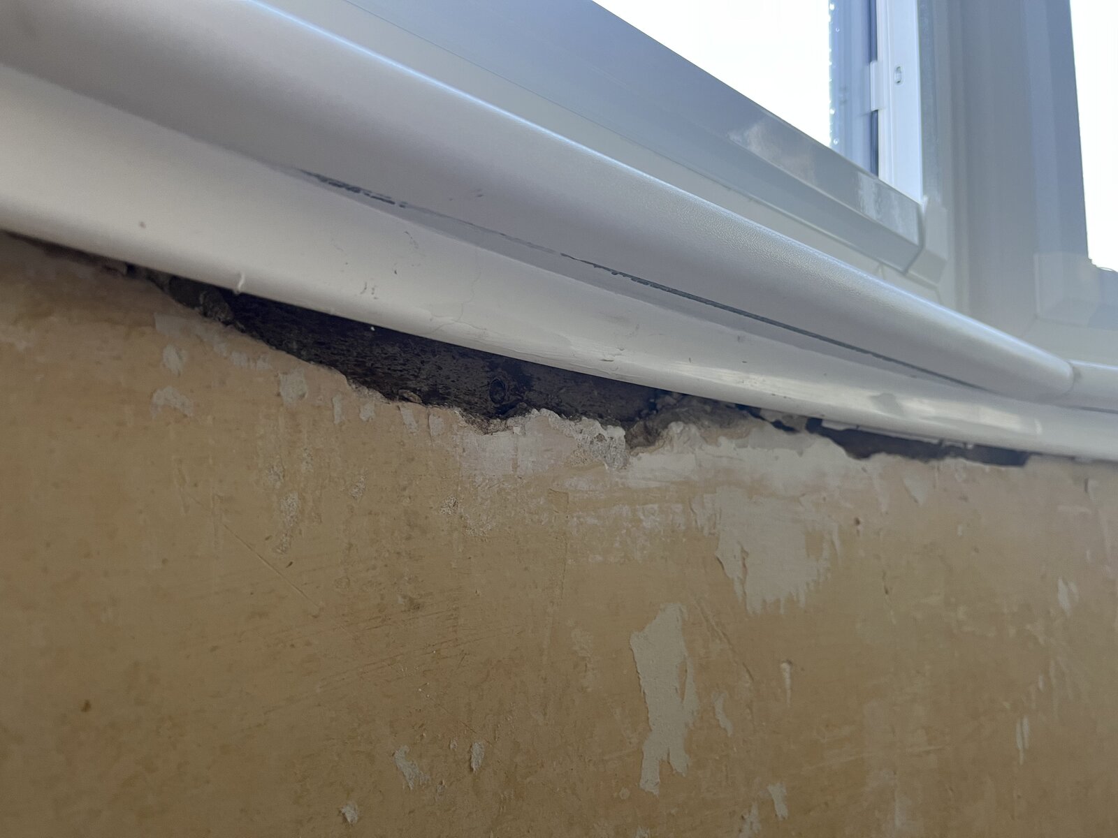

I’ve removed some wallpaper from the bedroom in our 1930s house and the plaster has come away in a couple of areas.
1. Under the window - exposing the timber of the bay window wall
2. Partition wall with another room - guess this is brick with plaster and the skim coat has come off.
Based on my limited description the guy at B&Q recommended using Polyfilla but seemed to be going off the labels rather than personal knowledge so I wondered if there was anything better suited for the task? Looks like the previous owners using Toupret or similar to patch some areas, would this be better?
The plan is to paint once repaired
Any help/advice much appreciated

Any ready mix plaster will do. Grab a couple of sheets of different sand paper to rub it down. The key is to wet it and trowel it up before it sets hard and that saves a lot on sanding. You might need some decorators filler on window.
Lime plaster?
You can buy lime plaster patching bags if it is.
I'd use Toupret TX110 if not lime
Thank you would that be something like Toupret smoothing filler or finishing plaster?
Do I need to do anything to the patched areas after, before painting?
Let it dry and if necessary a mist coat, but a small area should be fine as it. make sure the first coat of paint is properly dry before adding otherwise the whole lot will peel off.
It's in a box from places like screwfix or toolstation. You mix with water
Could use the standard one but slower setting and drying.
Up to you
It's just a general filler that can be used for thin skims or deep fills.
Smoothing filler is just for thin skims.
Is that bay single skin? Is the room cold and damp when heated?
Might be a chance to chip the bay back to brick and put some Celotex PL4050 in, then tape and skim the joints and refit the skirting.
Many people are unaware that Pollyfilla can be reinforced so to speak by adding a little PVA, done it loads of times. But don't go ladling it in because too much will make it dry rock hard. Alteratively I used a tub of Wickes ready mixed plaster skim last time I had a similar job to do a couple of years ago because it pretty well stays put rather than slowly sinking as some others do.
I think the bay is timber frame, tile hanging external and I assume plaster and lathe internally. It’s not noticeably damp. It’s cold ish, but I we don’t really put the heating on in here (like sleeping in a cold room!)
Think that is a bigger job that I feel comfortable taking on, particularly as we had new windows fitted earlier this year and would need to replace all the sills (cills?) maybe one for the next time we redecorate!
