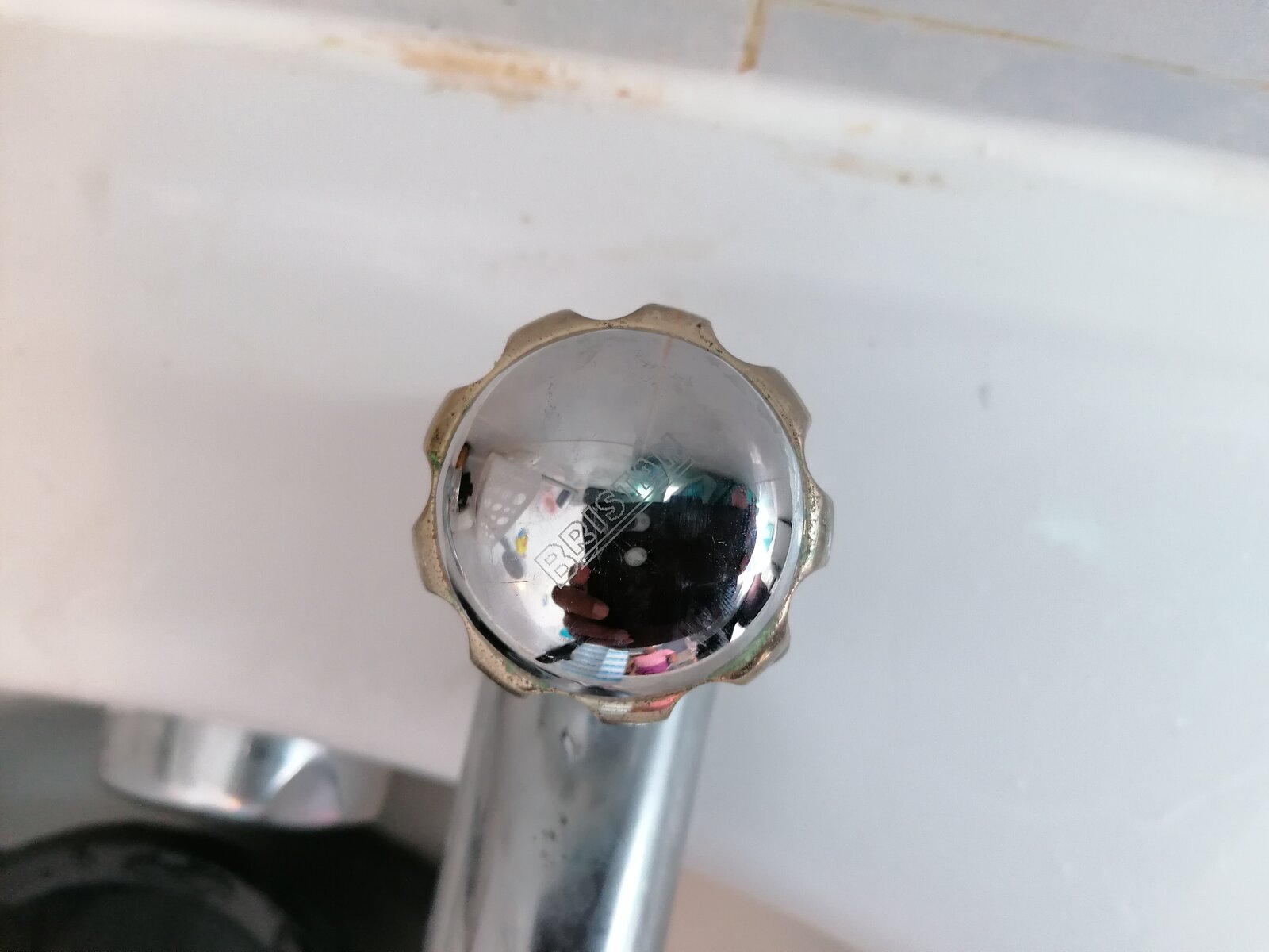

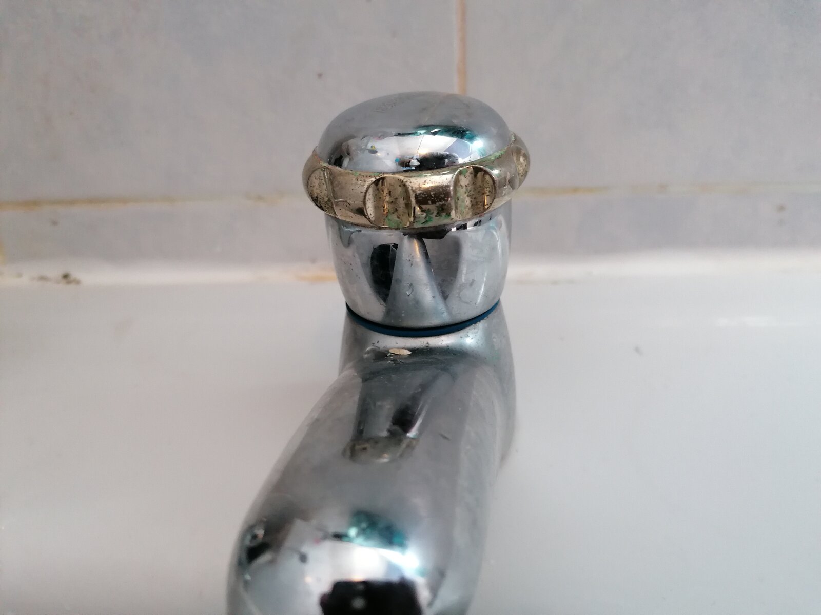

Hi,
I have an old tap on the bath. Please see the attached image.
Recently the water pressure is very low and flow is very slow.
I cleaned the aerator. It is clean.
The next step is to check the washer in the cartridge.
But, I cannot open the top cap of the tap.
How do I remove the tap cap. Please see the attached images.
I am not a plumber. Can anyone please help me?
Is that golden part a screw? It is used to turn on the tap. If I turn it will just open the water.
Pour boiling hot water over the dome and wearing rubber gloves gives a better grip.
Rubber gloves seconded! Just the dome bit unscrews.
