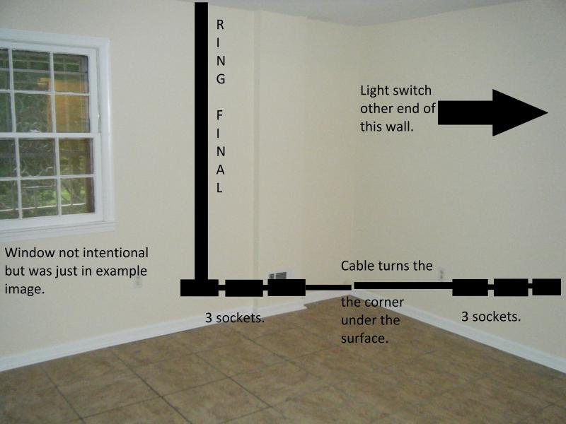

What I'm trying to describe is, for example if someone was chasing vertically down a nice block wall around 1m away from "being out the safe zone" / end of the wall doing things as normal, adds a nice flush mounted back box and socket in line with the new chasing for his/her nice new ring final (or whatever configuration they plan to use)... and then routes another chase horizontally going right or left until it's right up into the corner of the wall and then carrying on in the same direction across into the second wall/zone back so it's into the safe zone for the new wall and then another socket.
Is their chasing route complaint?
...I mean, your in a safe zone, doing things as you should, but then after your first couple of sockets you chase off horizontally to another set of outlets on a joining wall. Oh and I mean if you are only using CAPPING / OVAL CONDUIT.
I've never seen it done anywhere before so I didn't think it was allowed.
Until I managed to get the image below. Not exactly what I was describing but still exactly the same prinicable with regards to moving from one "wall / zone to another".
I'm not even sure if capping was used in that image (but I understand that's a whole different thing).
What I'm trying to get at here, is if the chasing isn't running directly in a "non safe zone" but just passing through it horizontally. Is this allowed?

The vertical and horizontal chasing and cabling shown in the picture appears to be within the regulations - assuming, for the vertical section, it is within 150mm of an angle formed by two adjacent walls or partitions - 522.6.101.(v)

As the photo you have uploaded complies to safe zones (cable within 150mm of the joining internal corner and horizontal chase from this to accessory) you have no issues with that set up.
The zones are not strictly between pairs or groups of accessories, as there can be a single accessory and providing you go directly vertical and/or horizontal from it (same wall that is) and in to the areas where walls and ceilings join (150mm rule) then that would be in compliance.
The regulations do indicate that the cable routed within these zones should be connected to the accessories, so that would indicate that the zone should only be used for circuits that have accessories within these given zones.
So no routing a lighting circuit within the safe zone of a socket circuit, unless it has an associated and connected accessory for that light circuit.

I have got an image I badly edited that tries to describe what I'm saying but to say "it's not very good" is an understatement.
I'll upload it anyway, although sorry for the lack of good software over here.
It's pretty much the same thing as the previous image but has a few sockets in line with the vertical chase before the chasing runs off horizontally around the 90° corner and then staying horizontally to a group of accessories (3 more sockets).
Like you have been saying, all the accessories and vertical chasing routes are in safe zones, it's just that the horizontal one is passing through the corner of the two walls where they join.
Nothing wrong with your cable route. The vertical and horizontal chases are denoted by the socket boxes.

And yes, all 'outlets' in the image will be part of the ring and capping will be used as good practice.
