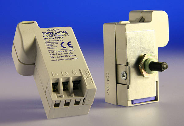

I need to replace a dimmer switch - it's 4-gang 1-way, but I want one laid out like this:
What's more, I want it to be a white MK Logic, and they don't do one.
So does anybody know of makes of dimmer where the works are held on to the plate with a nut round the body of the potentiometer? Preferably one with a low minimum rating so I can use CFLs.
My plan is to get 2 x 2-gang or 4 x 1-gang ones, remove the gubbins and fit them to an MK blanking plate with 4 holes drilled in it.

I know there be a slight gap between the units, but the back box does come with 4 point tags, so you can fit sideways.
The alto ones from WF un -nut and are guite compact, they are made by GET
The 400watt is 60watt minimum load though

If the front plate is still serviceable, why not just buy some dimmer modules a drop them into the existing?
1) It's not, as it has a small crack, and anyway it's not MK Logic
2) I'd still need to know which switches have the works held on by the pot nut and not, for example, rivited to the plate.

The Varilight dimmers have removable modules, so can be used in a custom faceplate. They also make ones with vey low minimum loading specifically for CFLs.
