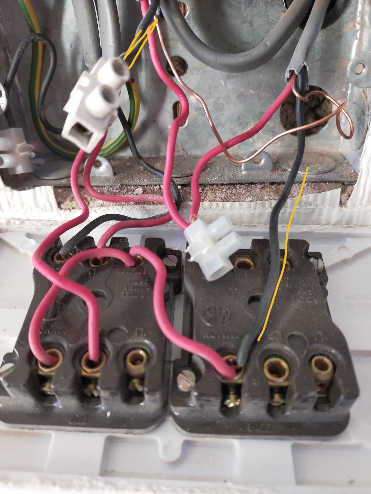

The left hand switch is a two-way. Landing light, I guess.
The next switch along is a one way. Porch light, I guess.
These two switches have their commons linked to the third switch from the left, which is in turn connected to the black conductor.
For the lights connected to the two switches on the LHS of the plate to work, that black has to be a live feed, no?
I find it odd that there are plenty of connectors in the switch box. Could one of these contain the disconnected switch wire for the hall light?
And the two reds connected in the back box also intrigue me.

The red conductor coming out of the hall ceiling should have continuity with one of the conductors in the switch box.
If not, either that is not the switch position for the hall switch, or there is a break in continuity between the hall ceiling wiring and the switch.
Is that switch you pictured the only possible switch for the hall light?
You did say the previous owner disconnected the hall light, so is it safe to say that the hall light has never worked while you have owned the building?
Is it easy to lift the floor above the hall ceiling light wiring to find the junction box?

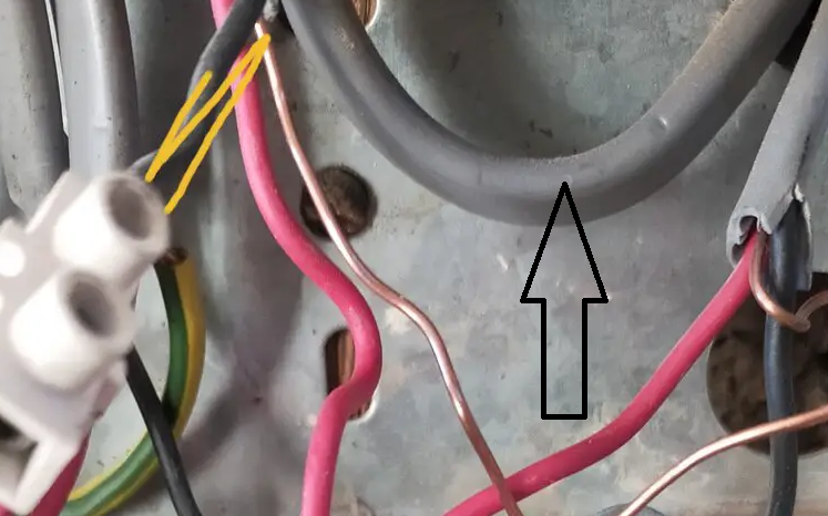

Thanks for reply definitely no continuity from rose, I'll have to try to lift floorboards the bare earth wire in the pic is from one piece of cable that has been opened, one of the black wires from that cable goes to the RHS of the switch the other is in a connector
The one I've marked in yellow and the bare earth wire

As Securespark said, (if the landing and porch lights work properly then) that black wire must be a permanent live.
So - is the brown wire in that flex hanging from the ceiling connected to any of the wires at the switch position?
Also - could you post another picture of the switch wiring so we can clearly see which wires go to the connector blocks and which cables those wires come from.

It seems strange the permanent live would be black when there is a red in the cable and it makes me wonder if it is a 'SL' from somewhere.
Have you opened the junction box hanging out of the ceiling to check how the flex is connected to the T&E.?
what's this cable doing?
Looks like you have marked 2 different blacks
They're not different Black's the Black's the reds (in the connector block) and the bare earth wire are the same piece of cable, not sure if that makes sense.
