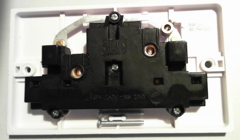

Earth fly @ socket walkthrough?
You are still required to install the link with all wiring systems when using surface metal clad boxes.
I'm not familiar with that being the case - can you point me to the right reg?
I don't have BGB to hand, but there's obviously a general requirement for exposed metal enclosures to be earthed, and I'm not so sure that there is any dispensation which allows them not to be earthed if the 'front' is removed.
Kind Regards, John
Other than guidance, which just says 'fly-lead everything' I did not think there was a requirement to provide earth continuity within an LV installation which has been effectively isolated, and deemed safe to work on.
Having said that, apart from socket outlets, there's few opportunities to test a circuit to ensure it is dead before removing the accessory.
I don't suppose there is, but there's no guarantee that a metal enclosure 'with its front removed' will necessarily be "effectively isolated, and deemed safe to work on", is there? I'm sure, for example, that many a person works within metal CUs/DBs (with the front cover removed) when the only 'isolation' is some sort of main switch/incomer within the enclosure (hence leave some live parts within the enclosure).
I'm not suggesting there is. I'm only pointing out that it is not a requirement; of course it will be, and should be considered best practise to provide the flying lead under most circumstances.
We need plastic/GRP back boxes, that aren't drywall, to drive away this rediculously outdated standard design.
As I said, I'm not so sure (but am not sure what regs to cite!). If there is a requirement for an exposed metal enclosure to be earthed, I'm far from sure that the requirement disappears when one takes the front off.
Kind Regards, John
