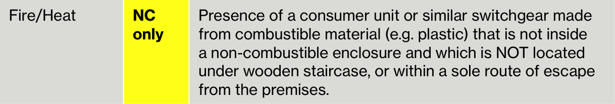

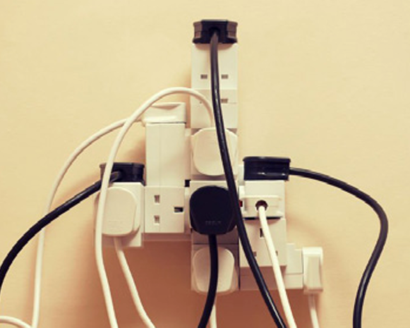

The Best Practice Guide has changed over the years, but it does have some things which I would question to if it has anything to do with the installation? 1748093115762.png It says "Inadequate provision of socket outlets" but could also be considered as being lazy, and not unplugging items not in use. The weight on the socket is clearly not good, but one could use an extension lead with 10 sockets to do the same thing, and that is permitted.
It does state:-

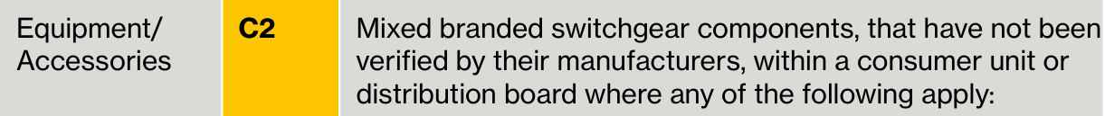

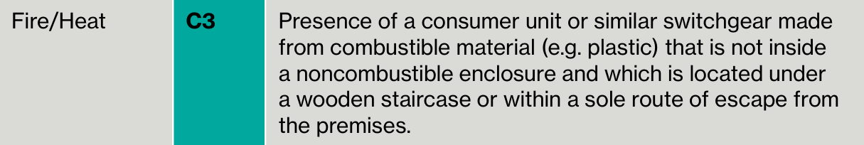

I did have a look to see if any pictures of the consumer unit. I have said before that plastic consumer units do not attract a C2 coding, then seen a picture, and realised that is not the only problem.

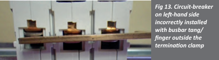

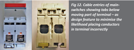

There is a list, but one can down load the BPG if you want to read the list. But I have seen so many where the MCB does not match the consumer unit, or items like bell transformers have been fitted.
In the main the consumer unit fires are caused by this
which is a design fault
but I have looked at consumer units to try and verify the buss bar is correct, and it is not easy with some models.
However, as I've said, the problem is that, if a C2 has been given for the plastic CU, the legislation does not appear to offer any mechanism for appeal/challenge
