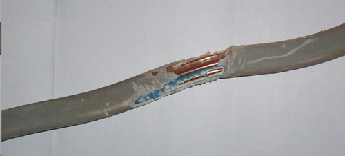

And some defects will only be found if someone happens upon them. I've seen pictures several times where rodents have removed cable insulation while somehow managing to avoid causing short circuits.
It might be my infamous picture which you have seen several times - although it is clear in this case why this hadn't resulted in a 'short circuit' (or even affected IR), and nor had it apparently killed the culprit (no skeletons in the vicinity :-) ).
However, again, no amount of studying of countless previous EICRs would have helped you to find that 'problem'!
