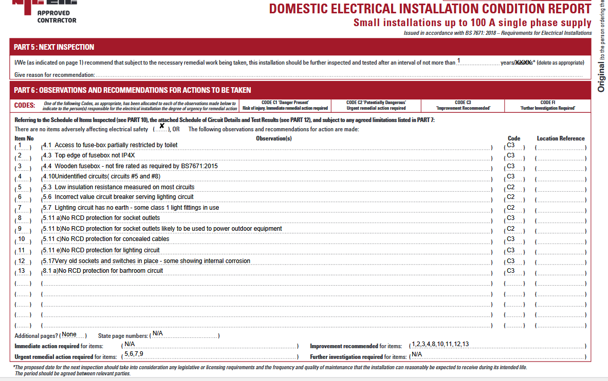

She is selling the house. Last rewired in the 60's (post '66, I believe, as there are CPCs in the lighting). Has had alterations and additions in almost every decade since, as far as I can tell.
I couldn't do it as I am not up to speed with 18th and am not independent.
Guy came round and spent less than an hour there.
Odd that he has mentioned that the intake and fuse box is partially restricted by the loo. It is next to the loo and the intake is all boxed in with the fuse box above covered with a removable box. Not really restricted by the loo.
Going round in the coming days to check the lighting earth. There is deffo a CPC in the cables and it is connected to others in several places in the circuit I have looked in the past.
Comments?

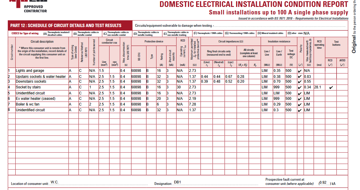

Not as bad as some that have been posted here in the past, but it's certainly not good either.
Presumably it's a wooden fusebox with the plug in MCBs, and the only RCD is one built into the socket outlet for the stairs.
Unidentified circuits should be FI, not C3

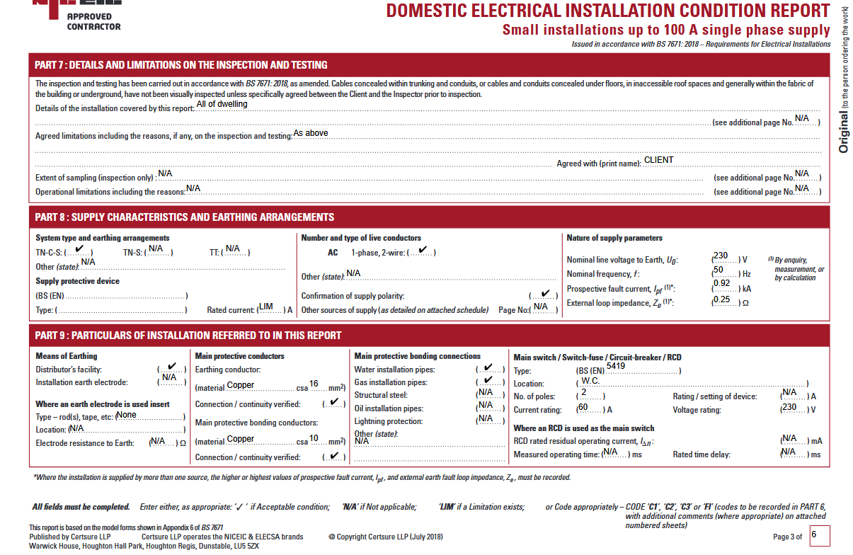

8.4 - supplementary bonding would be required if no RCD, so that should not be N/A
Most of the circuits were not tested.
Most of the insulation resistance results are very low, under 1Mohm, which doesn't seem particularly likely unless the wiring is totally ruined.
16A for a lighting circuit isn't a common value for domestic, but isn't a problem with 1.5mm wiring
If the wiring is from the 1960s, it won't be metric sizes.
16mm earth and 10mm bonding isn't what would be expected to be found with a wooden fusebox.
Resistance for the ring conductors circuit 3 are way off.

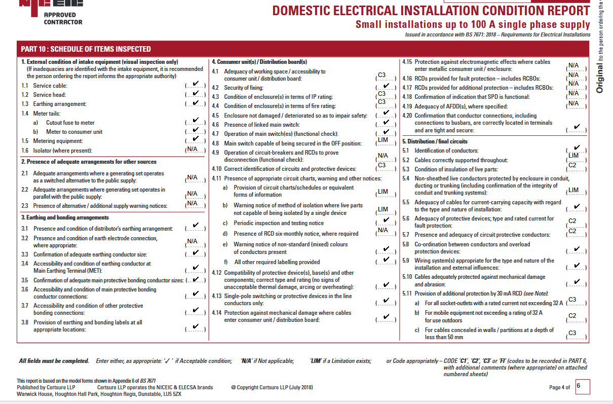

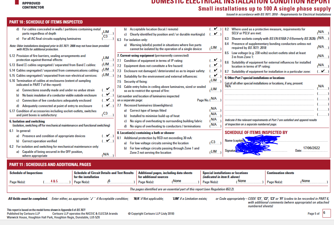

There are a lot of items incorrectly marked LIM or N/A, which appear to have been used as substitutes for 'couldn't be bothered':
4.8 - not LIM, either the switch can be secured or it cannot.
4.9 - not N/A - all circuit breakers should be tested to confirm disconnection
4.11 a and b - if required, either they exist or they don't.
6.3. - a warning label exists or not, probably should be N/A
7.5 - security of fixing, it's either securely fixed or not.
8.6 - surely the bathroom must have some equipment, a light fitting at least?
I notice one of the ring final circuits has an excessive end-to-end measurement on the neutral (rn) compared to the phase. However this has not been mentioned in the observations, which is odd as there clearly is an issue with the connections here.

Also noting listed as circuits venerable to damage when testing, which could have been another reason for LIM codes.

So you have a useless document, we can point out it says all of dwelling and reason for EICR is to sell it. So there should be no LIM entered and it seems many items marked N/A are applicable like number of points served, but it is up to buyer to get the EICR done not the seller, should the inspector make an error, then if his contract is with the seller, then the buyer would need to take seller to court, and the seller take the inspector to court, unless that bad you can get trading standards involved, so you simply don't want an EICR as the seller, better if you can simply say don't know.

TCALSS, I found good Zs readings at all the roses and light switch screws I tried, apart from the switch in the hall, which I suspect is the one he tried and formed the opinion that there was no earth. I kick myself because I ran out of time and wanted to pull the switch off the wall to check out why.
I suspect the switch box may be a pre 14th one with no earth terminal, or one with nylon screw lugs or the connection has come adrift.
Oh, and I think the pendants (old MK style with the separate ring) were pre-14th Ed. There was no earth terminal, so inside each rose was a terminal block for the CPCs.

Did you confirm the IR on the cables? If the readings are valid, it looks like a case where the inspector has determined the installation needs replacing.
