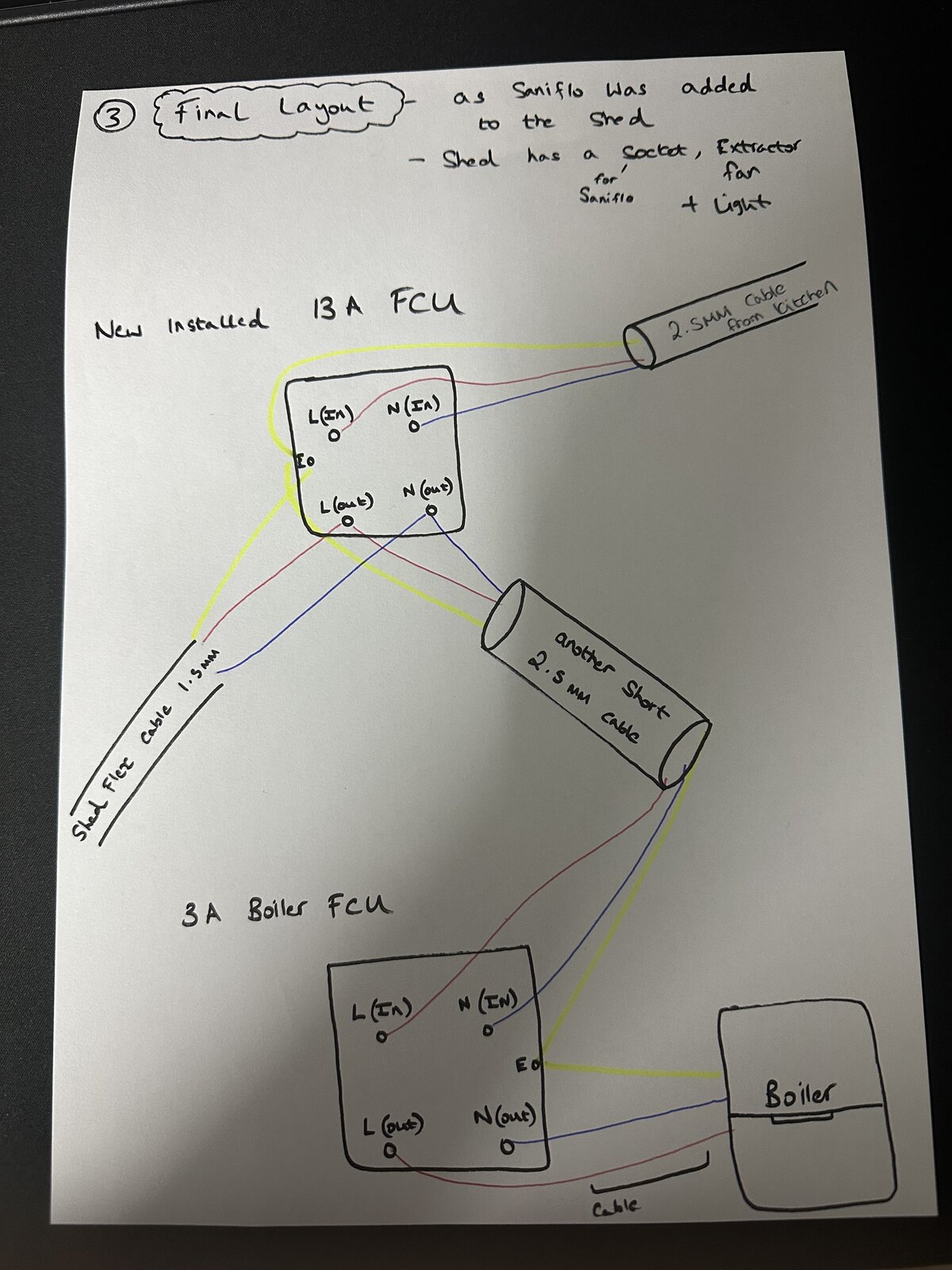

@pete01 - The supply came from one of the kitchen sockets into the 13A fcu. What left from that 13A fcu is two cables, one going to the shed, and the other going into another 3A fcu (boiler one)….obviously that supplies the boiler.
If the first spurred FCU switches off everything after it then it's fine.

@ SUNRAY - for the blue part, do you mean how the shed cable was wired inside the 13A fcu?
Yes but only for the short duration between it being installed and until the second FCU was fitted, which was a situation which needs no further attention as any error has already been corrected.
@pete01 - I just switched off the new installed 13A FCU which is spurred from a kitchen socket. When I turn this off, the FCU next to it (Boiler 3A) switches off as well as anything else in the shed – lights, saniflo etc.
@ SUNRAY - Sorry i'm not understanding what you mean? Would it help if i told you how things were wired before the new 13A FCU was installed...is that what you mean?
All good then (y)
No I believe I understand each stage as it happened.
Which is completely correct and will not raise future concerns.

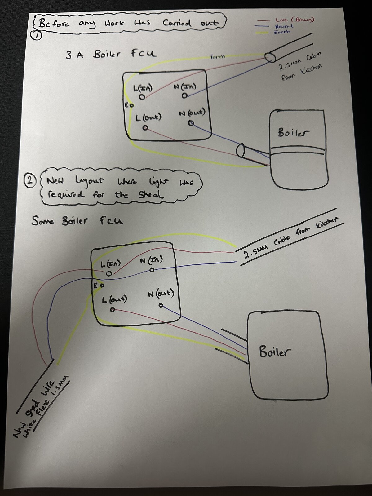

Thanks for all your help, everyone. I went to the effort of drawing how it looked in terms of the wiring to help make everyone understand further but I guess reading all the latest comments I didn’t perhaps needed to. Excuse the poor drawing!

1, was ok
2, was wrong
3, is ok
Which tells us that the last person to touch it realised the shed was on the supply side of the fcu and moved it to the load side (y)
Yes.

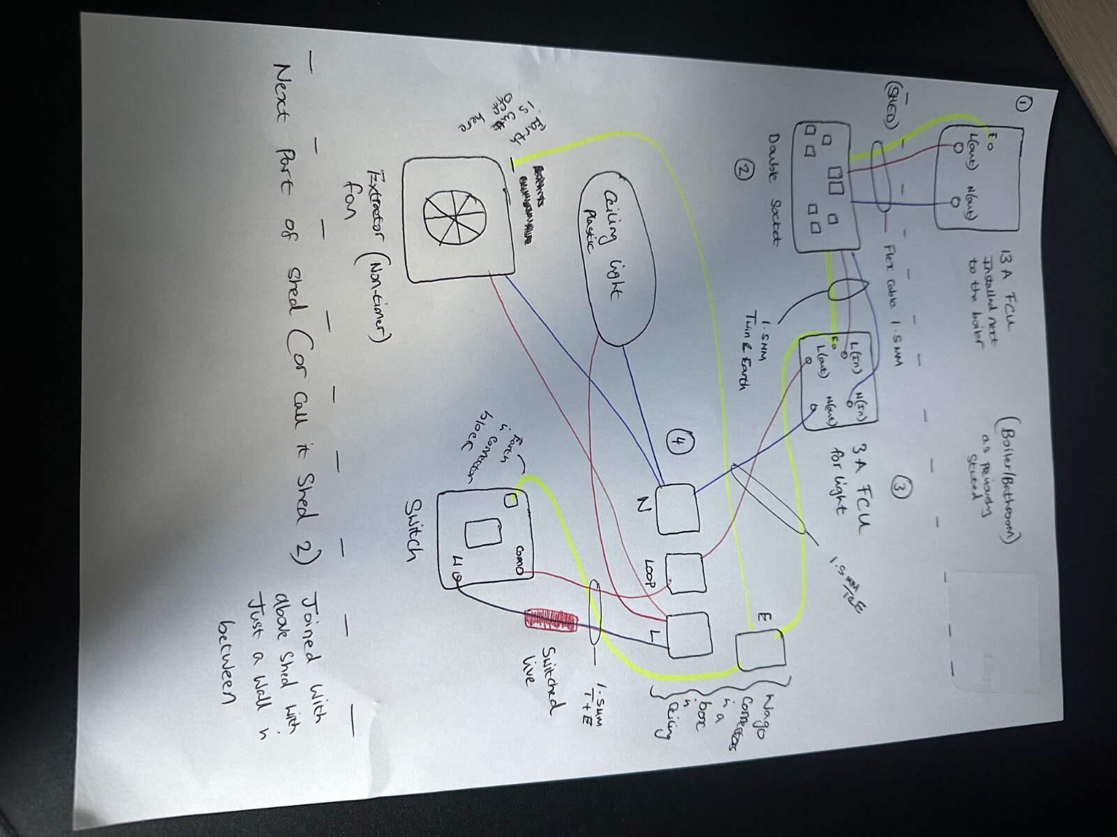

Thanks guys for your help on the previous query. I have another question regarding extending the light in the 2nd shed room. The picture shows the current layout of how electrics were done in the shed room. So inside the bathroom as mentioned previously the 1.5mm white flex comes from the 13A newly installed FCU and goes into the shed room into a double socket. From that double socket a 1.5mm cable goes into another FCU (3A), which is then used for the ceiling light, switch and extractor fan via a ceiling rose (wago connectors). I have another part of the shed joined to this current shed room which has a bike etc where I need a light and a switch.

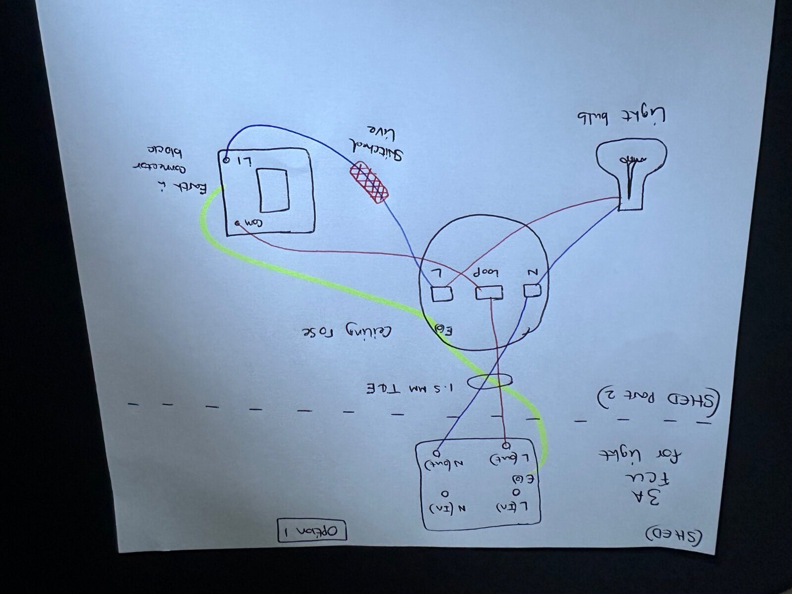

Option 1- Can I just take a feed from the 3A FCU (the out part) and take it to the next part of the shed for the light and switch…Please see drawings.
Or
Option 2 - Between the 3A FCU and ceiling rose next part of shed, do I install another 3A FCU?
Or
Option 3 - or do I just take the feed from the wago connectors from the shed?
