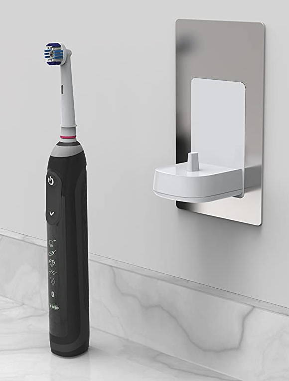

It seems scrolling back on this thread it does exist temp.jpg however it is a magnetic link so not sure if controlled by BS7671.
It seems scrolling back on this thread it does exist .... however it is a magnetic link so not sure if controlled by BS7671.
As you say, that uses an inductive coupling, and therefore has absolutely nothing to do with the discussion about the reversibility etc. of connections to toothbrush (or shaver) sockets/'outlets'.
