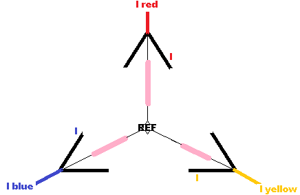

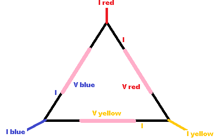

The thing about 3ph is there are variations on formats such as star / delta and rather than have a variety of different metering devices they may be 'adaptable'.
Single phase is easy:
measure V & I and multiply together.
This is then repeated for all 3 phases
but if the neutral is not available the reference is a phase:
Ensuring the phase rotation is maintained
In a delta connected load this may look like this:
Where the load is shown as pink.
Ideally the current is measured in each branch Shown I etc but this is not always available on it's own and will have to be measured at I red etc. The corresponding voltage is easily measured at each end of the load between the point the current is measured and the reference lead connected to the most appropriate place such as the next phase.
Obviously if there is a neutral in the system, that is unboubtedly the best reference point.

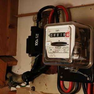

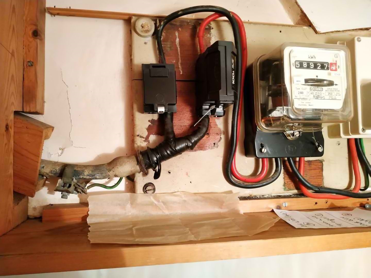

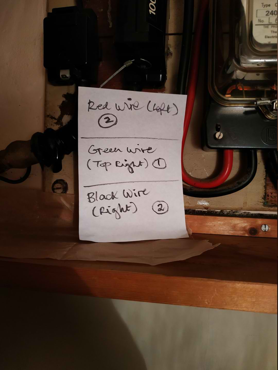

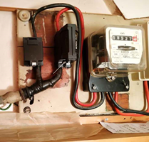

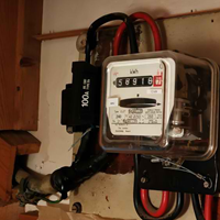

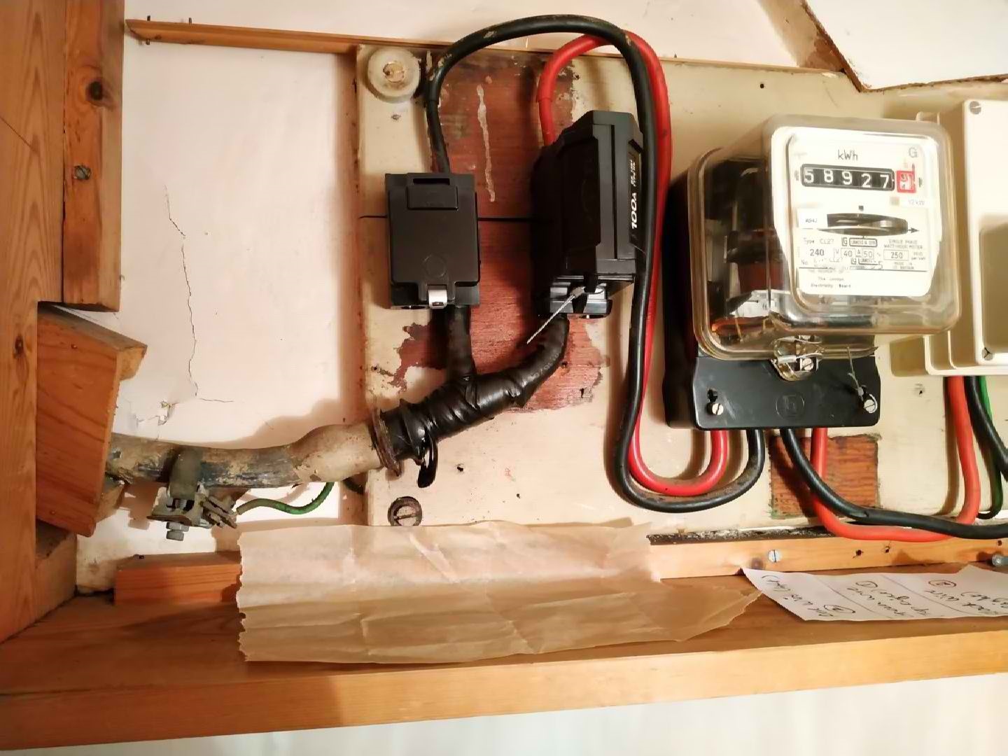

Can you send a clearer photograph of the main supply cable, ie the thing on the left of your original picture
As requested, hope this is clear enough...

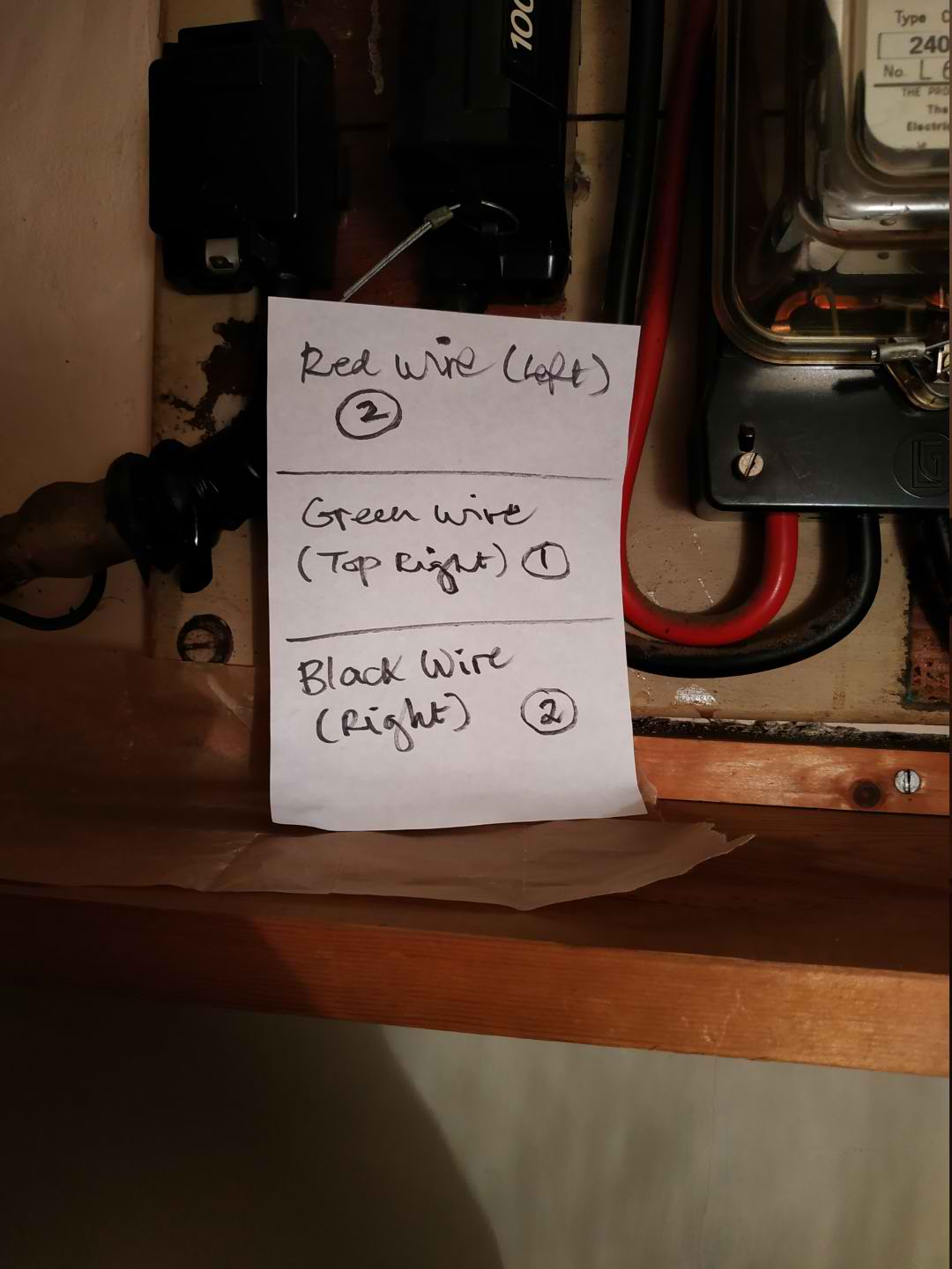

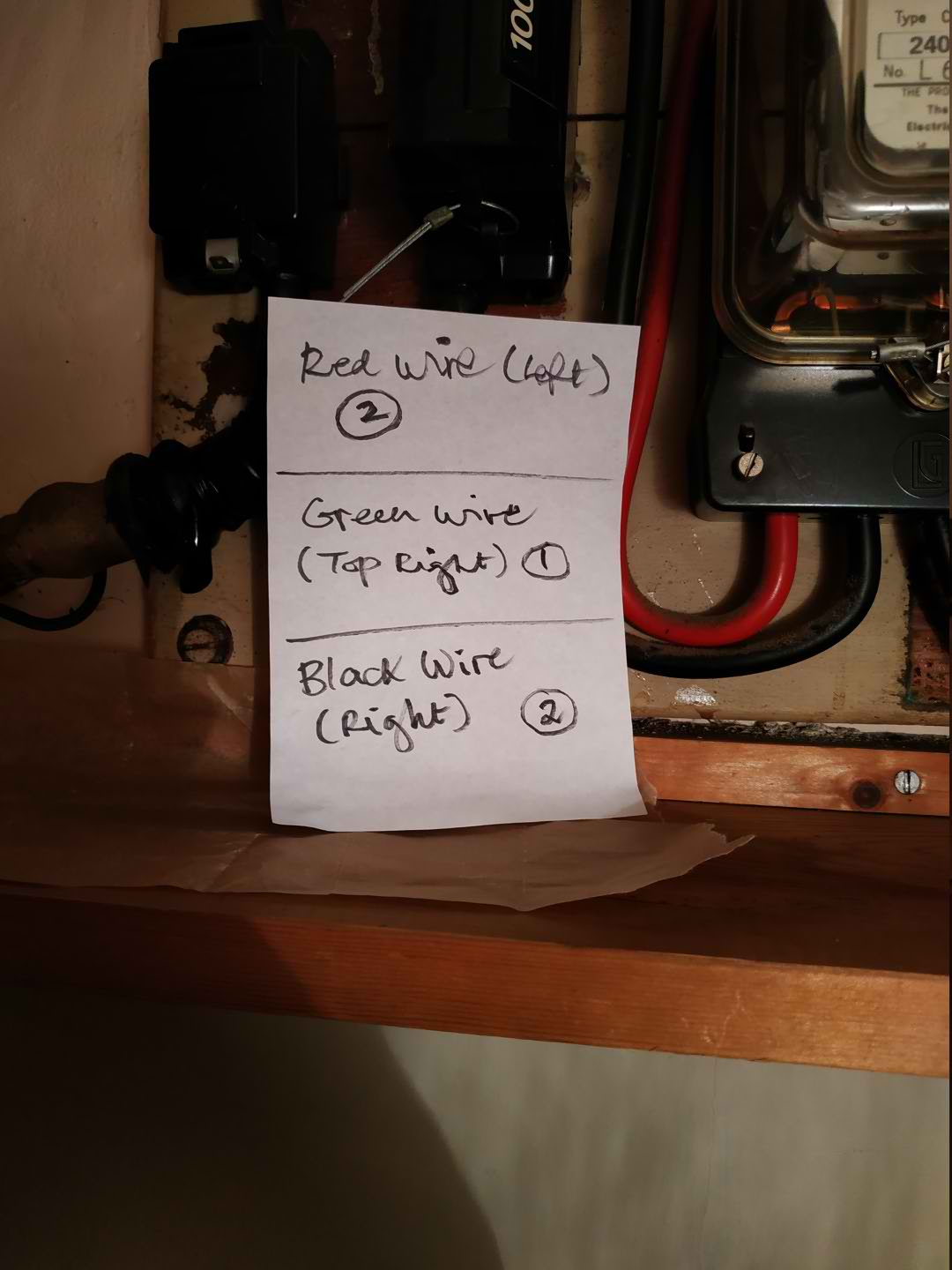

I also attach a cryptic message left in my father's handwriting (actually recopied in mine cos original was slick with black liquid - see below)...

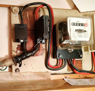

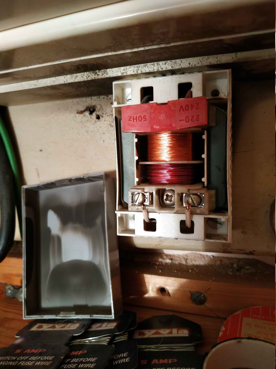

And finally... in case the original purpose of this thread has been forgotten :rolleyes:... A piccie of the inside of the doorbell transformer unit.
Doesn't look in bad shape to my untrained eye? Well, apart from the black staining of the inside of the unit's cover, that is...
P.S. In case the presence of baking paper becomes another major sub-thread... I put it in that spot as a precaution as there was previously dark fluid underneath the black wiring on the left - you can see where a little of the black isolation tape droops down, as if melted. Don't know when or why this happened... I cleaned it up, put baking paper in case of future drips but it hasn't re-occurred since.

Can I do the replacement (if it's necessary) of the doorbell transformer myself? Just shut off mains supply, remove screws, bung in a similarly-sized transformer? Do these things ever overheat to the point of burning stuff?
Answers on a postcard. :confused:
[QUOTE="Propah Charlie, post: 4991895, member: 289471]
[/QUOTE]
Yes you can replace it yourself. But you need to find out why it is overheating. They don’t normally overheat by themselves. If it is a faulty cable say, a replacement will also overheat.

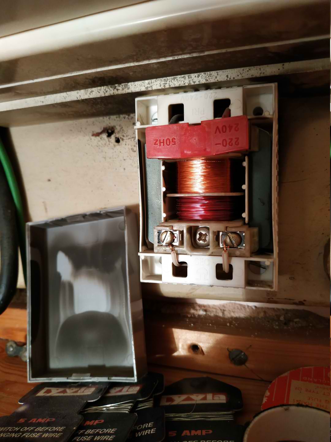

Nice one. Thanks. Doorbell transformers do sometimes get warm. Do you use your doorbell? Does your doorbell work? A jammed bell push can cause a transformer to fry.
Your house appears to be wired correctly, no obvious reversed polarity, and the last five pages - as far as you're concerned at least - was a waste of time.

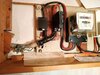

While we got hold of you, going back to my original comment all those pages ago, is that black cable ok?
In your picture it looks a bit funny.
In the top left of your picture just check the where the black cable emerges from the black service head. In the picture it looks like it could heat damaged.
It is probably and hopefully a trick of the light.
That's obviously true from the OP's point of view, but I would personally say that, for some of the rest of us, the discussion has been interesting, educational and, in at least one sense, has reminded us of a salutary lesson (see below). To be fair (to myself!), I did point out fairly early on that "that a 'straight on' photo would settle [it] once and for all" - and such a photo would certainly have avoided a lot of the subsequent speculation.
I would say that the "salutory lesson" is that we have all (certainly myself) been reminded of how misleading 'optical illusions' can be. I have to say that, even now that I am able to look at the photos 'side by side' (below), I find it "hard to believe" that the situation is "as it is" on the basis of what we saw in the initial photo. If I were a betting man, I think I would probably have put money on the fact that the right-hand branch of the incoming supply was heading somewhere significantly to the right of the fuse holder - and certainly not to an entry to that fuse holder on it's bottom left !
Of course, none of us would have had reason for a moment's thought had we be been there in person - but, as far as remote activities in a forum are concerned, the moral surely has to be "beware of photos"!
Chunky19 deserves credit for having worked it out before anyone else, but Sunray's suggestion (which I considered 'unlikely' on the basis of the photo) wasn't too far off, either.
The black is probably leaking sealing bitumen sealing compound from the lead armoured cable.
