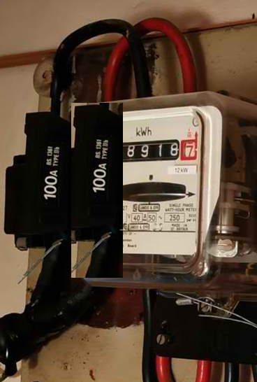

Fuse panel hot unit, smell in corridor below?

Didn't know about the doorbell transformer but learned something new. I'm hoping that's the only source of the warm-plastic-and-old-wood smell that's been puzzling me for a while until I felt around in the meter 'n' fuse unit for anything overheating. The transformer is the only warm thing in there; seems hotter than I'd expect (though I'm not sure how warm it should be under normal circs, knowing it's a transformer).
Here's hoping the home insurance emergency cover can replace it - or at least isolate it as a potential fire hazard.

I envisaged maybe the neutral could be a fuse linked out, but couldn't imagine the neutral would still be labelled 100A.

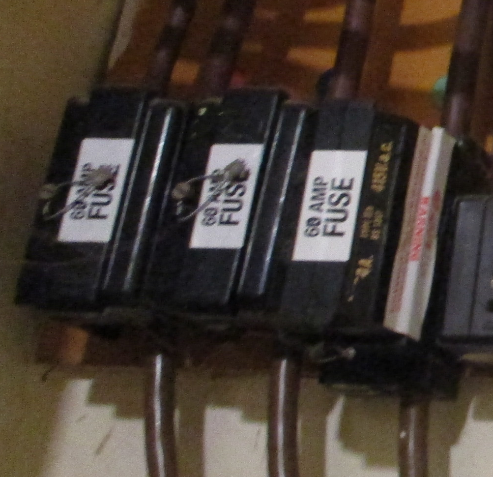

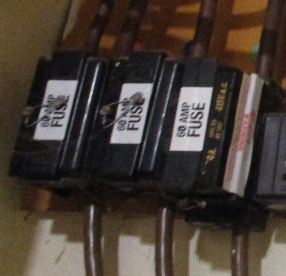

The 'labelling' to which you refer is surely the rating of the fuse holder, and therefore gives no indication of what size fuse (or link!) it contains, isn't it? In contrast, mine do have stickers which say "60A Fuse" (even though that is untrue, since I've watched 'the man' put 3 x 80A fuses into them :) ).
Edit: see pic in subsequent post (didn't appear here for some reason!)
Kind Regards, John
It is just the carrier, not an indication of what's inside it.

... and here the missing piccie ...

Can you send a clearer photograph of the main supply cable, ie the thing on the left of your original picture
