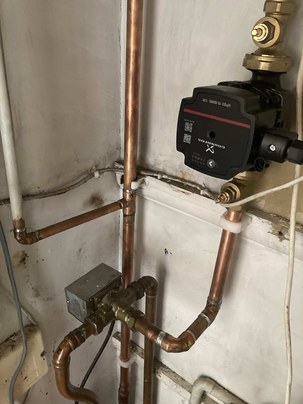

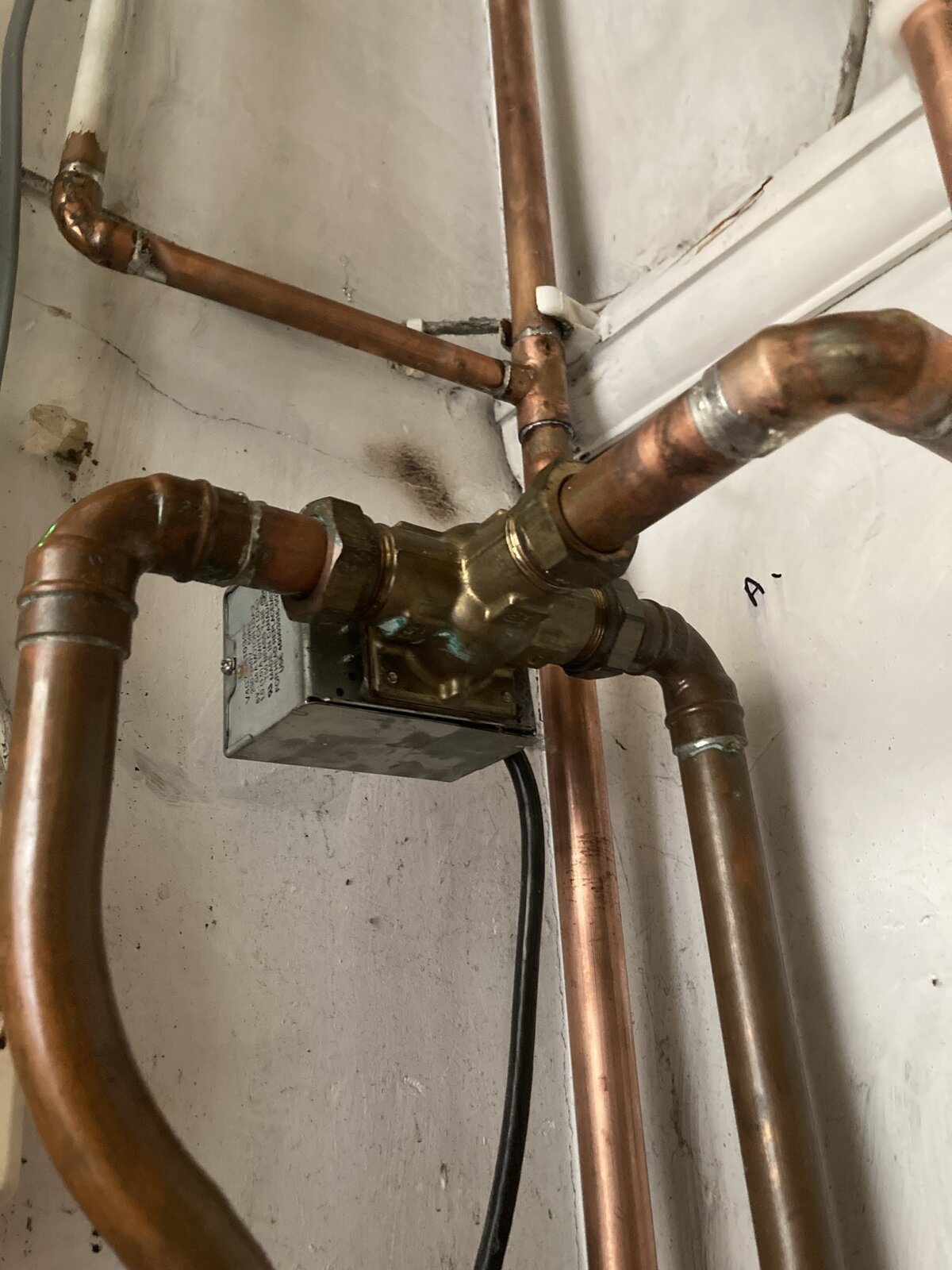

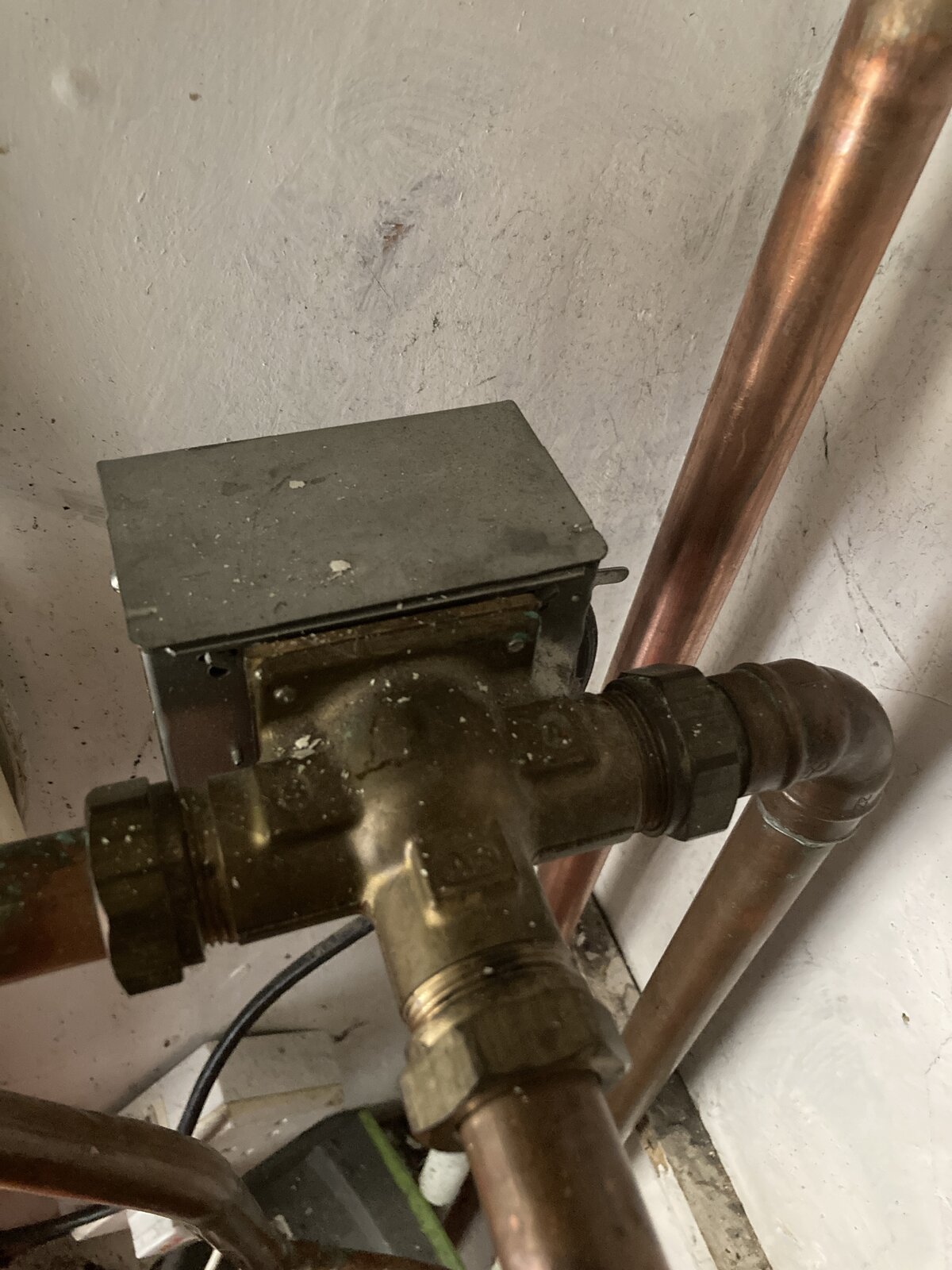

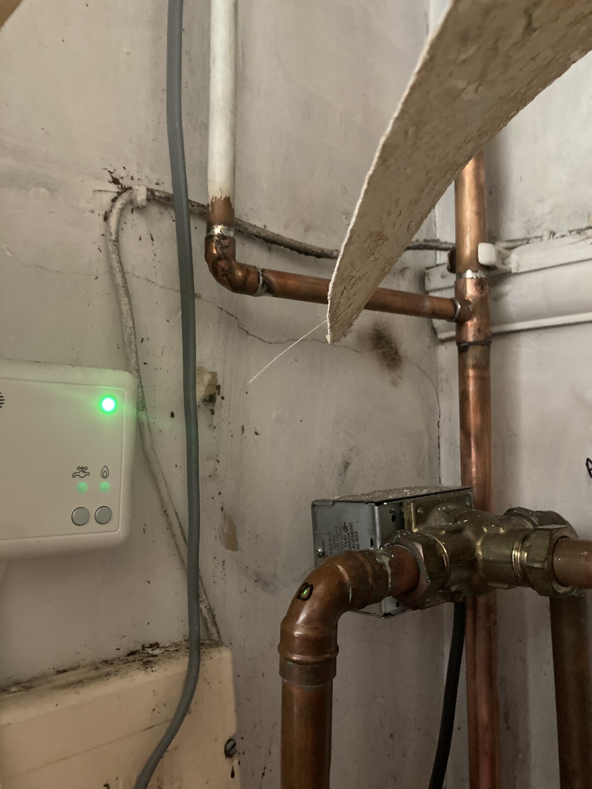

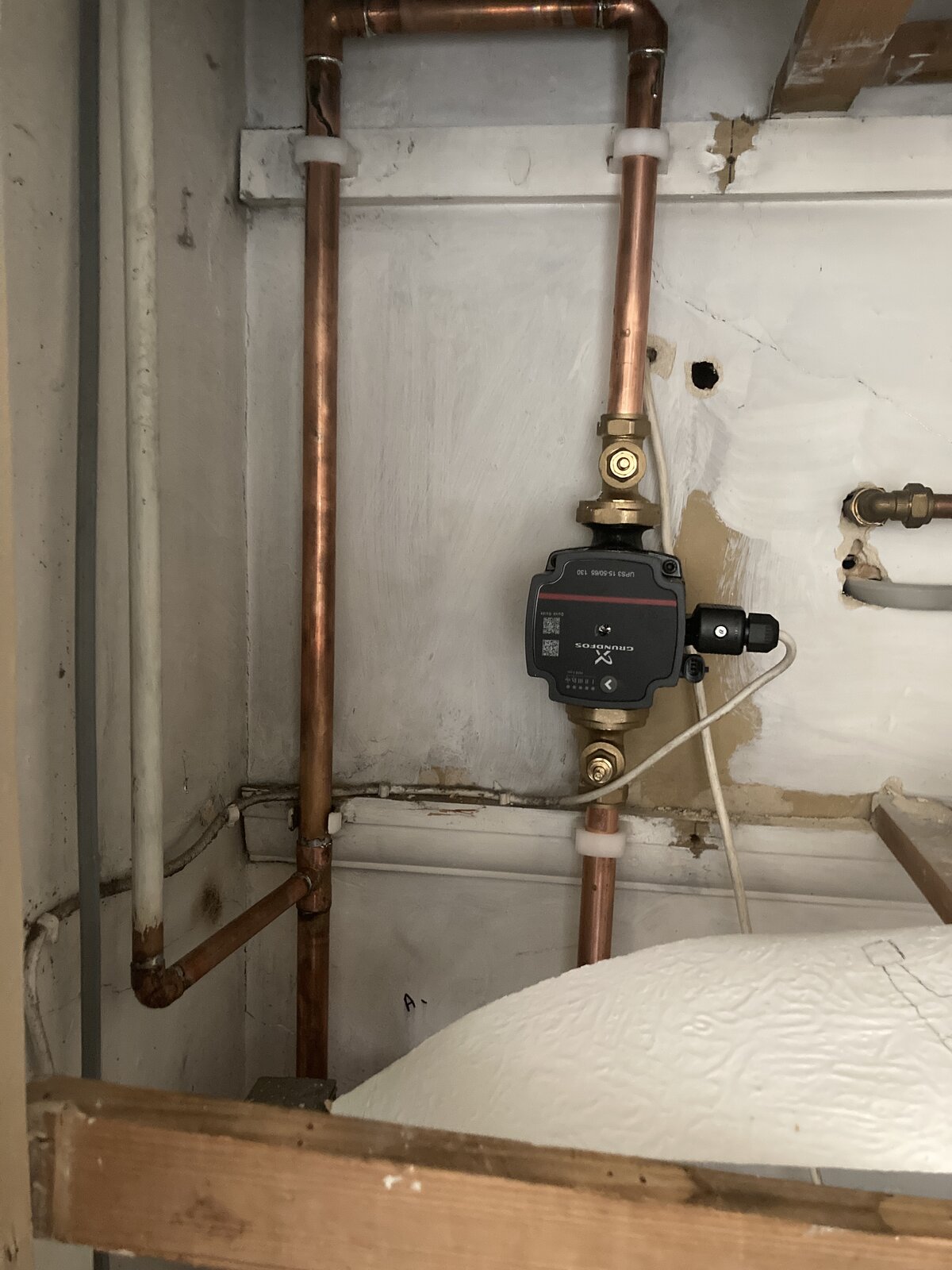

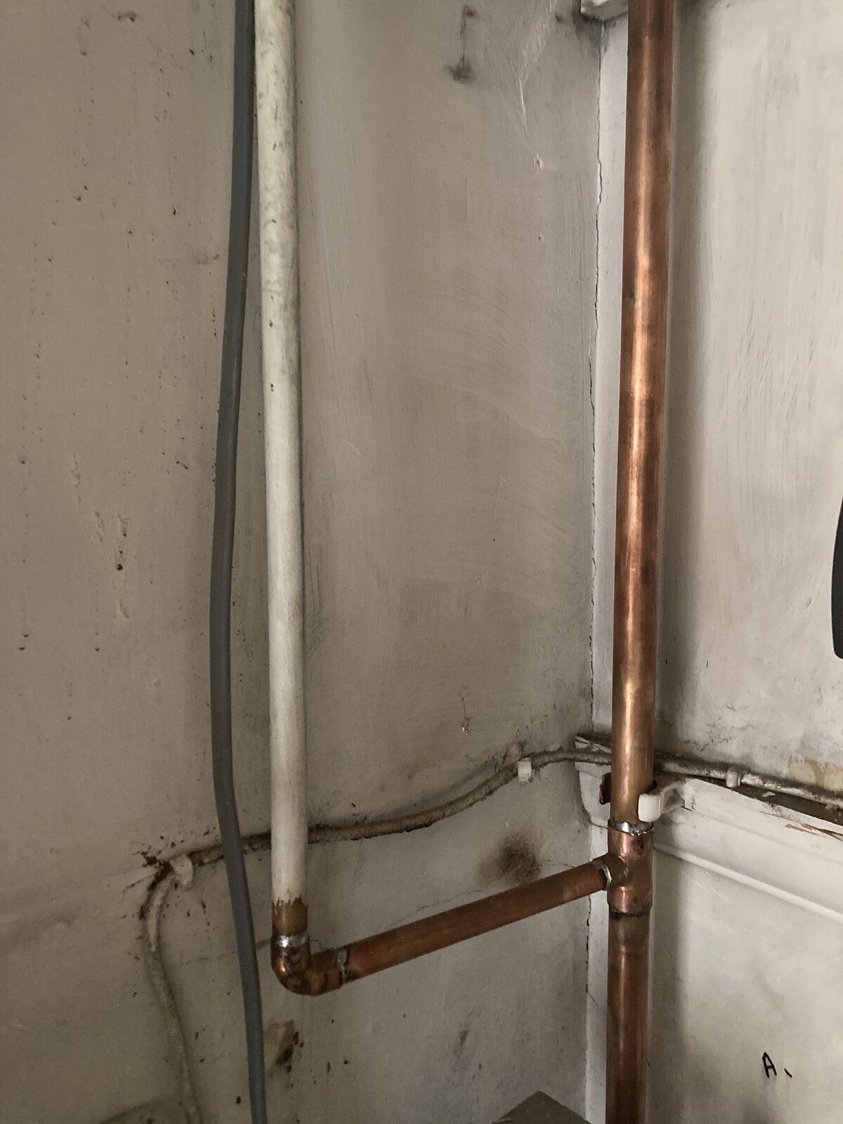

Well, I’ve just had a look when I took my grandson back. The 'plumber' has been round, fitted a new pump and some sections of pipe near to the pump and......no effing difference! It runs for a short while before water starts coming out of the loft ceiling. The 15mm painted pipe going up to the loft gets too hot to touch. He’s coming back on Saturday to powerflush it. Doesn’t seem right to me. It’s a Worcester boiler they have fitted with a mag filter. One thing that seems odd to me is that although all pipes going in to the three way valve are cold, the valve electrical bit is quite warm. Also the little lever you use when filling/bleeding the system doesn’t seem to be connected to anything, it’s just flopping loose. Any idea's? A few pictures:
Floppy lever is either a demand on the system or heating was on last. The 15mm pipe seems like it’s the cold feed pipe, and before pump, so unclear as to why it gets too hot to touch. Also the pump valves don’t look fully open, especially the first one.
Possibly pump speed was turned up, looks to me like the cold feed is before the vent and too far away, so the required 'Neutral point' isn't created, causing the system to pump over. F&E cistern possibly then either over topped as vent pipe putting in water faster than it can get back into the system/down the overflow, or cistern has got too hot, softened and collapsed.
Thank god there wasn't anyone underneath it.
As above. Mottie, a 3 port valve will always have clear route. It can only close 1 port at a time. Water enters valve in middle splits one way for heating, the other for hot water or middle for both. Does it pump over for heating & hot water or only on one or the other?
