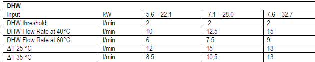

I smell bullschit. Are they saying their heat exchanger is 100% efficient?:
But that is a 39kW boiler, which the Intergas isn't so lets try and even things up and go to as close to equivalent outputs/inputs as possible. So lets take the Modena 32, which is 0.7kW under the Intergas 36/40 which is as we have established not 40kW to hot water, but actually 32.7kW. Ferroli claim this:
Again - they seem to think their heat exchanger is 100% efficient, but then it probably is the same as the 38C, so go figure.
Intergas:
(Obviously we're looking at the right hand column for each).
Laws of physics seem to be different for our Italian brethren. Especially as said laws, even assuming 100% heat transfer state that at input of 32kw, ΔT35 you can get 13.06 l/min.
So how the feck does Ferroli manage to get 15.3 at both ΔT's? If we take ΔT30, that gives us 15.24l/min.... but again at 100% transfer efficiency. Which we ain't gonna get. Ferroli manage to squeeze another 0.3 l/min on top of their 100%.
Now, we give the same calculations to the Intergas figures?..... This gives us 13.35 l/min at 32.7kw input and an assumed transfer efficiency of 100%. Put that to ΔT30 and that rises to 15.57 l/min. IF we use Intergas' figures of ΔT25, it is 18.69. Ferroli - a slightly more modest differential of 0.1 litre a minute. Again assuming 100% heat transfer.
Of course we can't have 100% so a bit of a reduction ius in order. Something Intergas has done. But Ferroli?

Where did he get 13.1 and 16 litres per minute from? Fecked if I know, but it was the actual figures from the performance tables.
