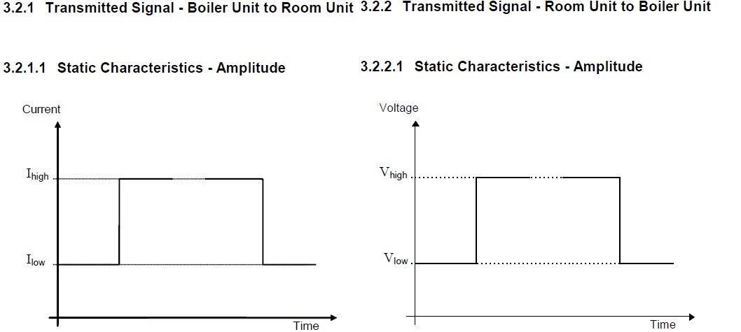

The protocol is manipulating current in one direction and voltage in the other so wired.
It is no such thing. Find out what a digital communications protocol is. Or for a short simple taster re-read what I have wrote.

If the OT current and voltage was transmitted by RF, quite a feat in itself, I would look for a Honeywell transmitter to connect to a Vokera, Salus, Delta Dore, Nest, Remeha, Baxi, Thebens receiver and vice versa.
I only have V4 of the spec here but this will not have changed from the earlier version
Only the OpenTherm protocol is transmitted over an RF. The temperature sensing device gets data then puts it into a protocol (letter) forming it into a bit stream. The bits are put onto an RF signal. The base receiver/sender, receives the bit stream with a small microprocessor, as in the case of the T6R, depending how it it set up, either operating a small switching relay, or just sending the bit stream onto copper wires to the boiler's microprocessor on its pcb to process the OpenTherm protocol. The boiler does not care how the OpenTherm protocol got to it - it could have been around the world 10 times on differing RF signals, or on a wire that is only 1 foot long, for all it cares.
