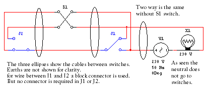

Drawn it out now, makes sense. But something is obviously not right with the strappers. Or one of the switches is dicky.
Do people really have a problem with how it's wired?
If we ignore L2 on the intermediate and treat it as a connector block then it's simply a very conventionally wired conventional system.

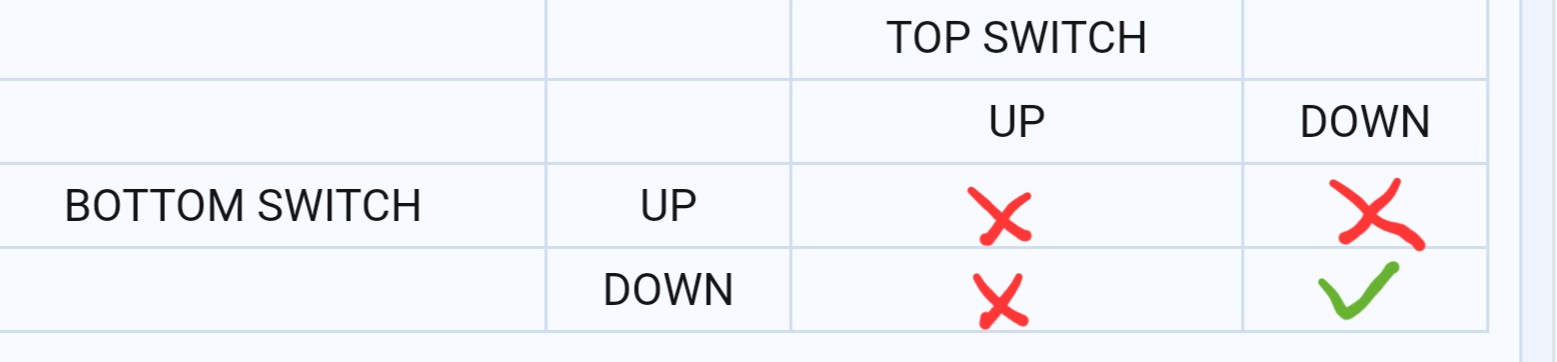

PMartin: I don't know if it's possible to fill this table in.
Can you can please fill the 4 boxes wether the light is 'on' or 'off' for the 4 combinations of the switch positions. If the boxes can't be filled in then describe as 'up up off' etc for the 4 combinations.
TOP SWITCH​
UP​
DOWN​
BOTTOM SWITCH​
UP​
DOWN​
Thanks for the replies so far. I've entered feedback on the table supplied by Sunray.

I imagine that as some point a 2 way switch with a loop terminal was used and this intermediate switch was used as a replacement and wired in the same format.
Lovely thank you.
I'm still suspecting a faulty switch and as you have replaced thedimmer with a new switch I'll guess it's the intermediate.
Basically it uses 4 contacts and moving wires around may very well find the faulty contact.
Try swapping the reds and blacks over (as the internal contact at L2 in currently not used) which will work if it's L1 faulty
EFL option may resolve it, if it's L3 's contact faulty

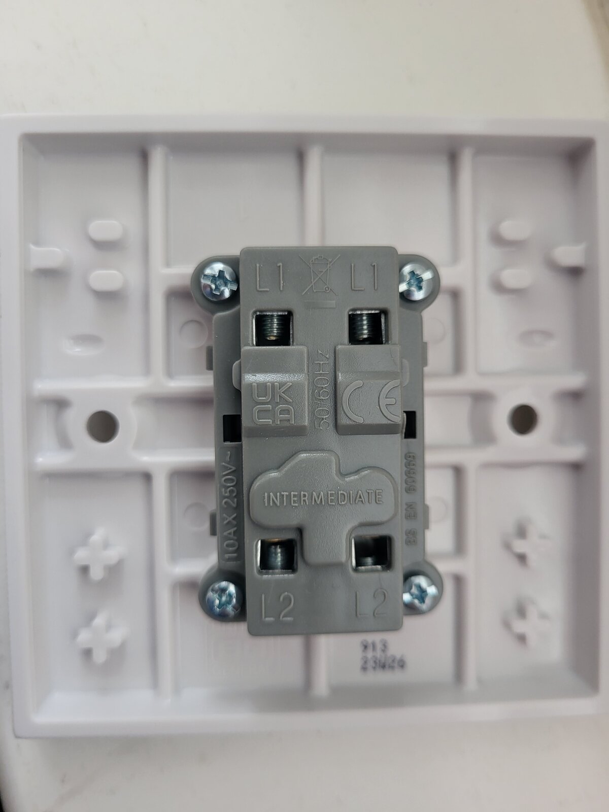

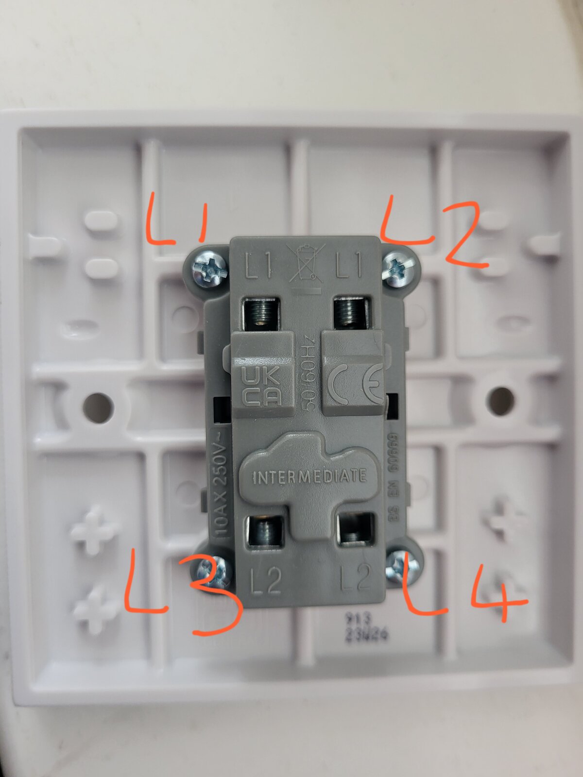

Thanks again. Before I try those.2 options I thought I'd mention that I also bought a replacement intermediate switch (pic attached). It doesn't follow the L1, L2, L3, L4 layout of the current intermediate so I can't follow the same cable connections. Can it be used?
I've tried all those steps and still no progress.
I installed a new intermediate switch on the landing (same wiring pattern) and the issue remained. Now both switches have been replaced.
I tried the blue and black into L1 and issue remained.
I tried swapping red and black over and had no light at all so have reversed to original wiring.
