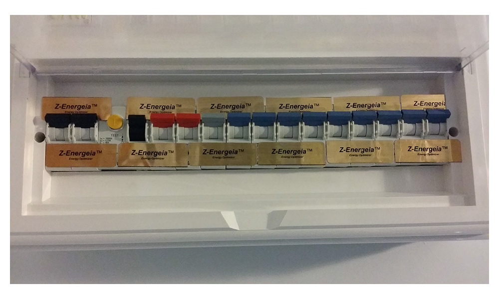

Clearly he doesn't. I saw some great snake oil on FB a while ago but for the life of me I can't find it.
This company are selling essentially anti static wipes that you're supposed to wipe over MCBs and the CU lid. This aligns the electrons in a more energy efficient way and saves you money.
About £45 a time
What a helpful product.
I was totally gonna buy that, until I saw in the promo video application instructions section the words said "apply from left to right" and the dude was clearly wiping from right to left. Obviously this means he's a bullshitter. What a shame for such a promising looking product
Oh well, back to the solar panel idea..

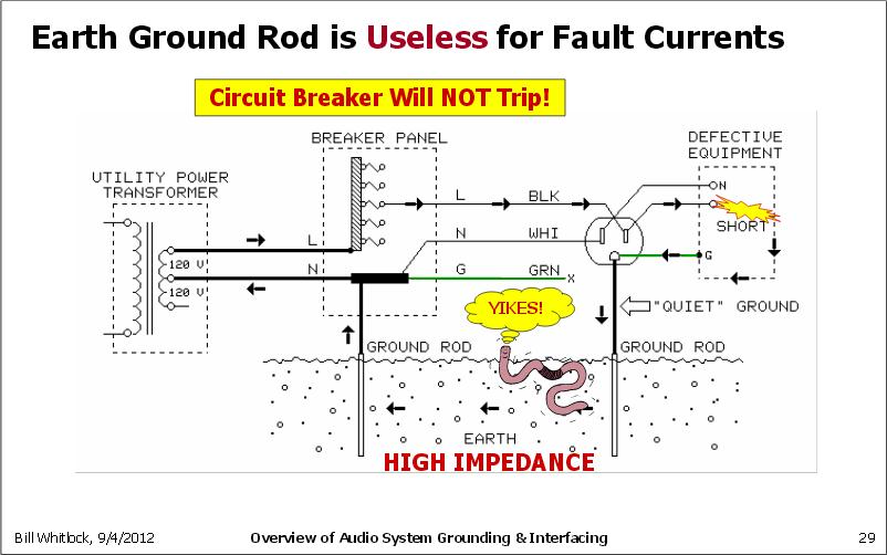

A Clean Earth is taken from an electrically quiet source of Ground potential, sometimes a Ground rod. This provides the Earth to the equipment but NOT to the cable / socket fixing screws / back box.
You mean like this (American example)?
